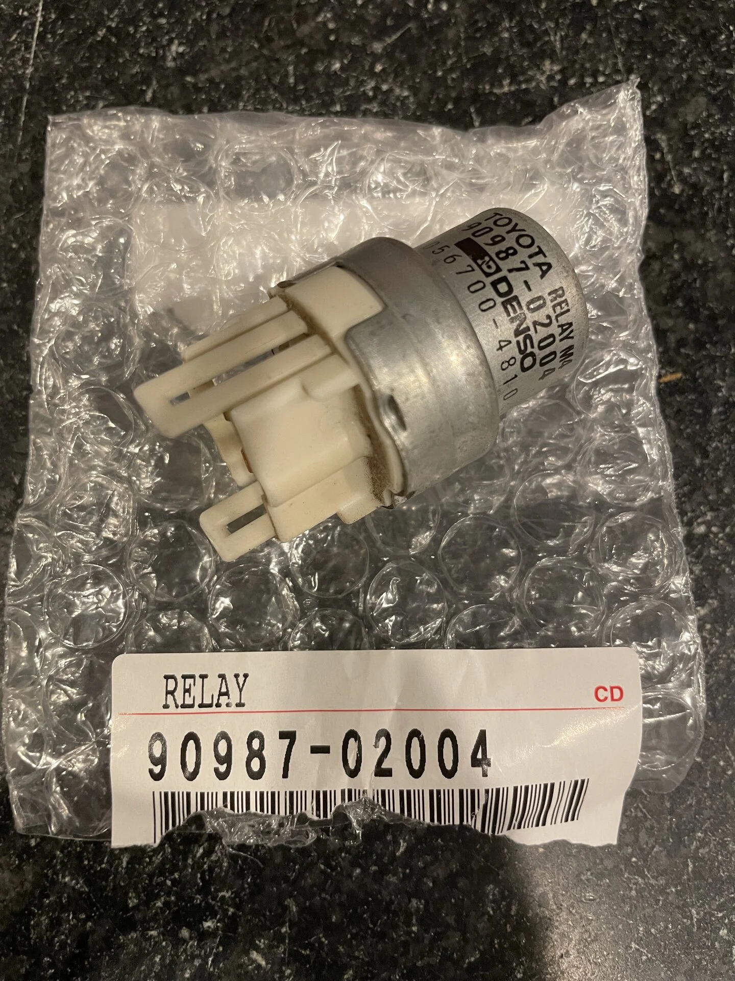

Hi, did you ever find out what was going on with your Fj62 - same thing has been going on with my 89’
I got a new Toyota starter and I also switched out my ignition and it’s still happening. I think it’s some type of electrical wire somewhere.
It could be the ignition relay. It’s on the driver side of the dash roughly between fuse panel and steering column. You can see it by putting your head near the floorboard and looking up.

Hi did you have similar issues with no start? And did I changing out the ignition relay fix it??? Thanks.
Yes, I did. It was off and on for about three months and totally random. Each time it would eventually start, but sometimes would take a few turns of the key. I realized it was the relay during a drive from CO to WA. I had been driving all day and had no issues. Pulled off to get gas and it wouldn’t start back up. I checked the relay and it was pretty warm to the touch. Swapped in a new one I brought with me on the trip and it started right up. The issue hasn’t happened since.
Edit: your issue could be the ignition switch as pointed out above. Mine was the relay.
That's good, and unusual... Usually a relay will either work or not work, they normally don't fail intermittently. May have been corrosion on the terminals so a new one solved that. They're cheap, anyway. Cheers for finishing the thread.
