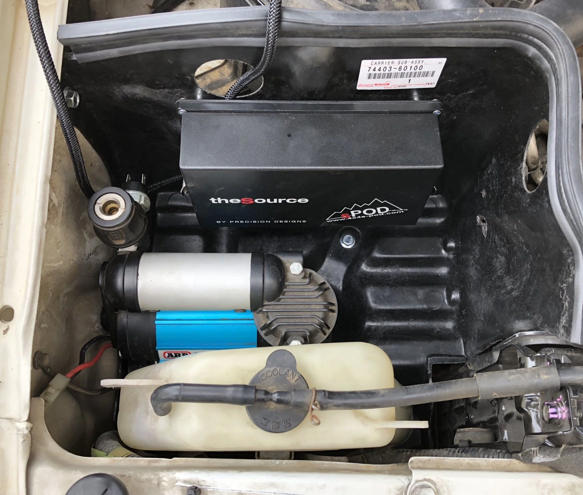

Spod ARB setup on my 94 fzj80.
Parts;
91-92 fj80 battery tray
2002 PT Cruiser lower radiator hose
Spod
Arb Compressor
Slee window washer fluid relocation kit
