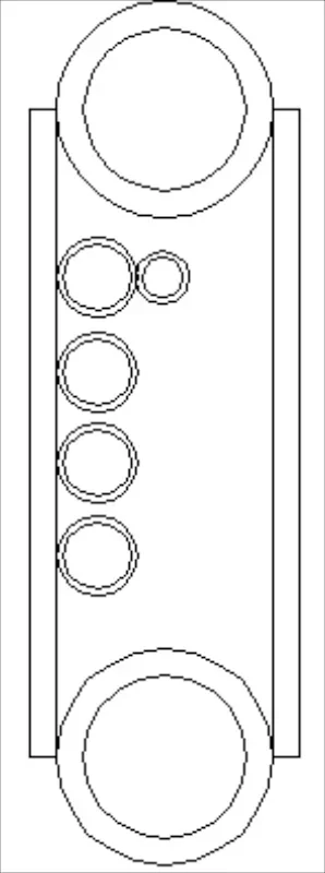

I was going to use a deuce-and-a-half frame and cut it up and box it, but I am having doubts about that. I don't know what kind of steel it is or if it is heat treated. So I am probably going to use some sort of box tube or a built up cross section of tube and plate. I'll sketch up a cross section real quick of that idea. I am really getting anxious to get going on this. Right now it's just incessant scheming...
Here is what I was thinking.
Use the space in the middle to run conduit for electrical, fuel, air brake lines, etc. Use a nice bend radius to exit, and weld up around the exit to maintain water tightness of the frame.
I could even, in theory, use the frame tubes themselves for fluid conveyance. I would like to run hydraulic fluid in them for the steering and fans, that way the frame could act as the reservoir, de-areator, and cooler. But heat into the other components inside the frame is a concern, as well as into the body, which will be right above it. Ideas?
Here are a couple of things off the top of my head:
- Corrosion. If you put conduit through the middle of the frame like you illustrated, then you're creating a lot of crevices where moisture can get in and cause issues. If you run fluid through the conduit, this can produce leaks that will be impossible to trace and fix.
- Fabrication. The only way I can think of producing a frame in this manner is to produce it from scratch, with a tubing bender and flat stock steel. That would be sweet, but it would take a ton of time. Is this your plan?
- Awesomeness. If you built a frame like this, it would make running wires, or fluid, across the length of the truck incredibly easy. I think it's an awesome idea :grinpimp:
Have you thought of using a composite or plastic as the conduit?
Good thoughts. I was thinking of using weld-through zinc primer on the inside of the frame before I weld the second plate on the side, and ensuring that all the openings to the frame are welded or sealed. That still leaves the inside of the conduit, though. I suppose I could use stainless tubing... With the right filler I can weld that to regular steel. Would need to research that weld process a bit more. If I run fluids through the center conduits, I would thread a piece of rubber or plastic tubing through the conduit to keep an unbroken fluid path inside the frame. That way leaks should be minimal and if they do occur symptoms would be fluid leaking out the ends of the conduit, and the fix would be pull the tube and snake another through.
I hadn't thought of using composite tubing. I do have a lot of pex left over from other projects... My only concern with that is welding to the outside of the frame plates later to add things on to the truck. Would that melt the conduit inside the frame?
It will be a fabrication nightmare. I am willing to spend time and money on it, though, since it will be the foundation of my truck and I want this to last another 30+ years. I will probably need to make a good cad model, though, instead of just winging it.

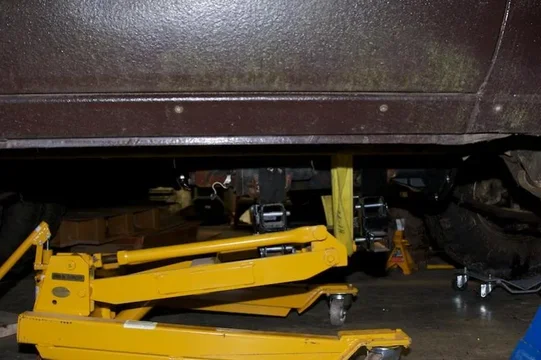

Got the transmission jack parts in yesterday, put it together, and couldn't wait to check fit the beast. Refresher pic:
roughly in place, but not centered:
About where the shift lever will be, unless I get the forward shift bar housing:
Some notes:
-It is about 6"-8" lower than I would like
-I didn't remove the top rear transmission support spring pack, so it can go up at least another inch there.
-It is low in the front, so tipping it back properly will gain another 1/2" - 1" at the front.
-The SAE #1 flywheel housing is still on the transmission. The SAE #2 housing is 2" in diameter smaller. I need to get a clutch kit before I swap them out.
Hopefully in a couple of weeks I can do that, remove the top rear support off of the transmission, and check again. It looks like there is surprisingly little to remove from the tunnel area. Meaning not all of it. ;p

Just curious how low does that trans hang under the framerails?
Any pictures of how it sits?
I think I will put the SAE #2 housing on temporarily and remove the upper transmission support tonight and place it in a better position. Then I'll take some pics of that to post up. I think right now it is not too far below the frame rails. The clutch housing is decieving, as it makes the transmission appear tall. It is actually much wider than it is tall in the body of the thing.

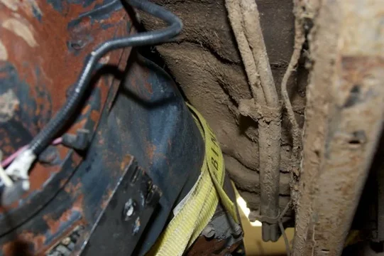

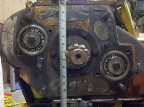

This is the main interference point.
From underneath:
That is one of the countershafts. The passenger side one is high, and the driver low. You can really see that in the previous post with the clutch housing off. That works well, since less modification to the driver footwell is required. I really didn't want to sit sidesaddle... There is still the slave valve on the driver's side, but it is farther back on the transmission.

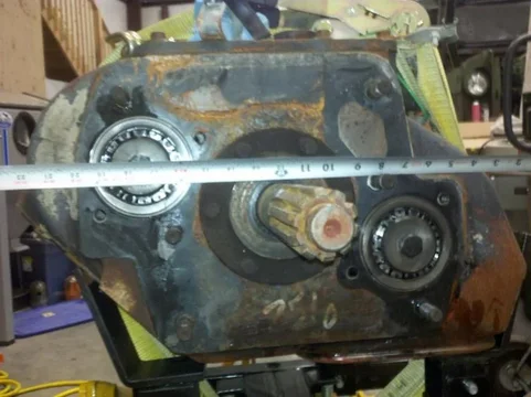

There are two bosses cast on the underside of the transmission. They can be drilled and tapped for a rear mount, eliminating the space-eating upper one that came with it.
