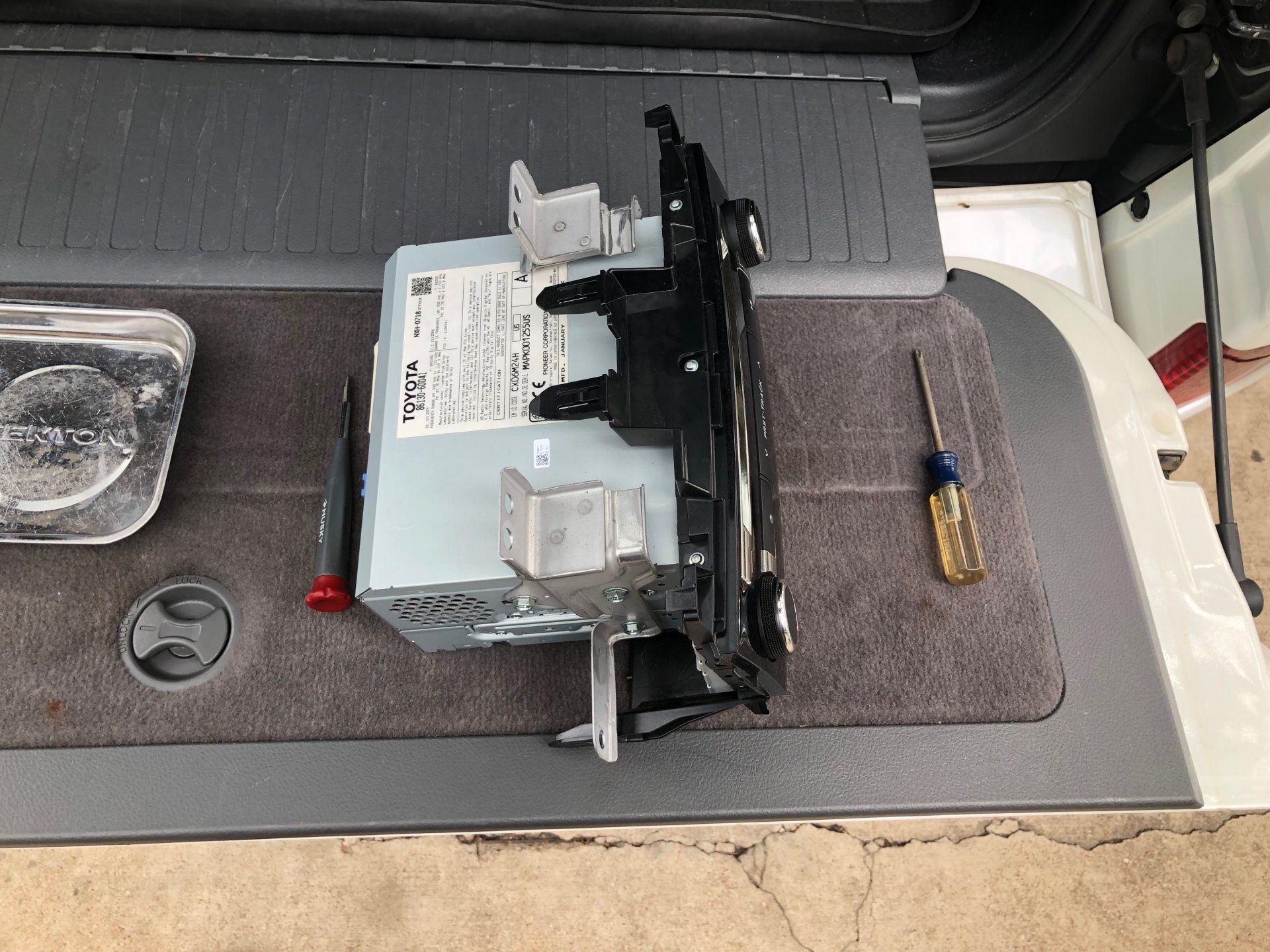

There are fans located in the sides of the lower nav unit (behind the knobs) and I’m 99% sure this sound is the bushings on them getting worn out, then the main shaft of the fan wobbling around in a circular pattern. Cold can make this worse on some as the grease gets more viscous.
The fan is behind the grate oriented toward me in this picture.

Mine was out because I was too aggressive with the power/volume knob and broke one of the tabs on it, so it came out to repair. Wasn’t too bad to get out, the only tricky part was the shiny black trim at the top of the dash around that speaker. This is specific to landcruiser though, even if the modules are similar in cooling format the LX may have significant differences with trim removal.
Mine doesn’t make the noise, but I have absolutely heard that near exact sound with other small cooling fans that are worn out. I have decided if mine does this I’ll be pulling the unit and opening it to diagnose and probably replace the fans.

This is what I went through attempting to fix this issue.
There are 3 fans in the (pre-entune) head unit. 2x in the multi function display, and 1x in the multi disc CD/DVD player. My culprit was the CD/DVD cooler fan. I pulled all three fans out and placed them in freezer and bench tested them to isolate the noisy one.
I went through 3x different aftermarket PC cooler fans until I found a replacement that wasn’t terribly loud. Like hear it while driving loud. It’s a 40x40x20mm 24V fan. The idea is that it runs at 1/2 speed at 12V to keep the noise down while the doubled fan depth helps keep the airflow up. This one turned out to be no louder the factory one it replaced. I had to transfer the tiny ~2mm plug from the OEM fan to the new fan. I also omitted the factory mounting cage and used longer mounting screws on install.
This is fan I used:
