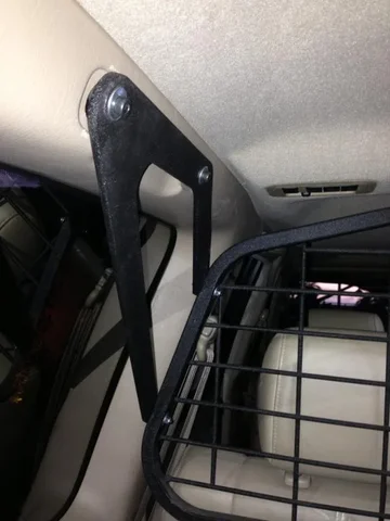

Speski Cargo Barrier Installed:
Driver Side Bracket:
Passenger Side Bracket:
Clearance around the Rear A/C Controls:
Head Liner Clearance:
2ND Row Seat Back Clearance:
2ND Row Folded Down:
View from Driver Seat:
Installed Pictures:

Vibration has been hit and miss with other vehicles. My 80 series barrier shakes a little if I really stare at it in the mirror. I think the 100 series may be the most sensitive due to the mounting bracket design. You mentioned an out of balance tire which probably is contributing. Every modified truck will be a little different too. Yes an additional support from the bottom would probably cure all at the cost of possibly drilling. I have not ventured down that road as I know everyone has different storage solutions going on and trying to make something universal could prove challenging.

I have redesigned the mounting brackets to prevent the vibration Nick has experienced. If you have one of my original 100 series barriers and would like the updated brackets drop me a PM. I will supply them at no cost.

Just received my new brackets for my cargo barrier from Corbet. Much beefier than previous. Took care of the sheer problem. Thanks for standing behind your product.
I'm assuming yours went on the passenger side? I'm waiting in mine as well. Corbet is a good dude to work with!
I did have an issue with the passenger side and repaired it myself. After notifying Corbet, he got right on a permanent fix. The two brackets look the same, but are much thicker and heavier. He also included the necessary hardware.
Mine happened a few days ago. I texted him a picture and the new brackets went out yesterday. It was right infront of the grab handle. Speski has my bussiness!
