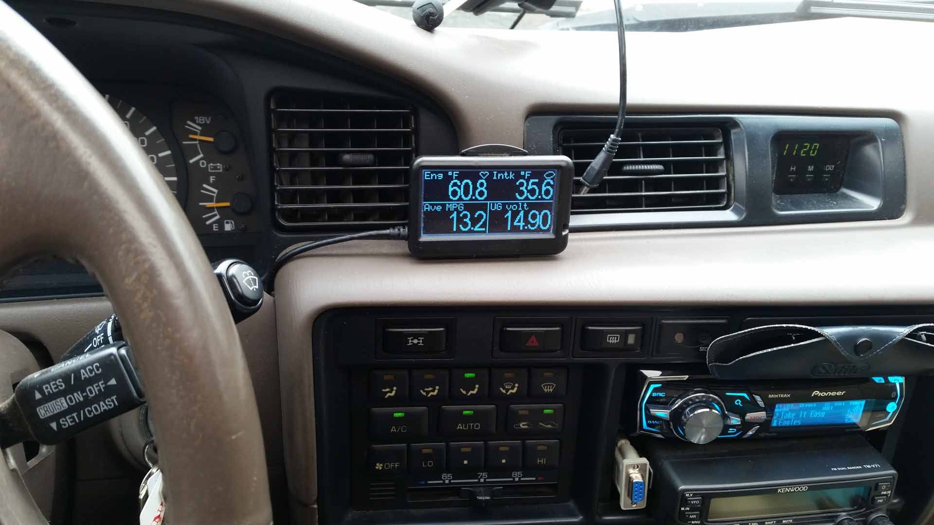

Not sure I like the stacked method. Took a look and think this space will work well. Haven't seen any images with it mounted here...probably because most have 95-97, which don't have this free angled dash space.
Yeah... '94 are bad :(
Bad angle.
But you can get a '97 which I heard are the best. Oh, and '97's have no Pair. :p
Look around the center console, the other little square cup holder and maybe you like that real estate there.
Or just get a '97 angled up console in front of that cup holder and you can install a detachable faceplate.

Dang...that space won't work either. Unit is about 8.5 inches long...too big for that spot. Detachable face model will work there though like you said. Maybe I'll just get a solid handheld unit with a car antenna...:hmm:
Sure. I rock a Baofeng handheld with a magnet mount antenna.

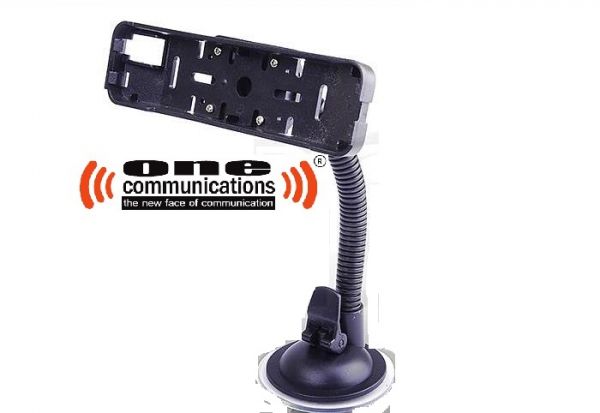

A lot of people use the space between the seat and center console to mount their CB/HAM radios.
You can probably try something like this.
If you insist on having the radio in that bad location you should consider the front firing speaker radios then.
So...why is that a "bad location"? It's within easy reach, it fills the space left by a single DIN radio very nicely and is easy to run wires to. I had it in that location in my 91 and 97.
The radio the OP is thinking about has a front firing speaker and my V71A has a bottom speaker. I have no issues hearing either one at speed, so not sure what you're talking about.
