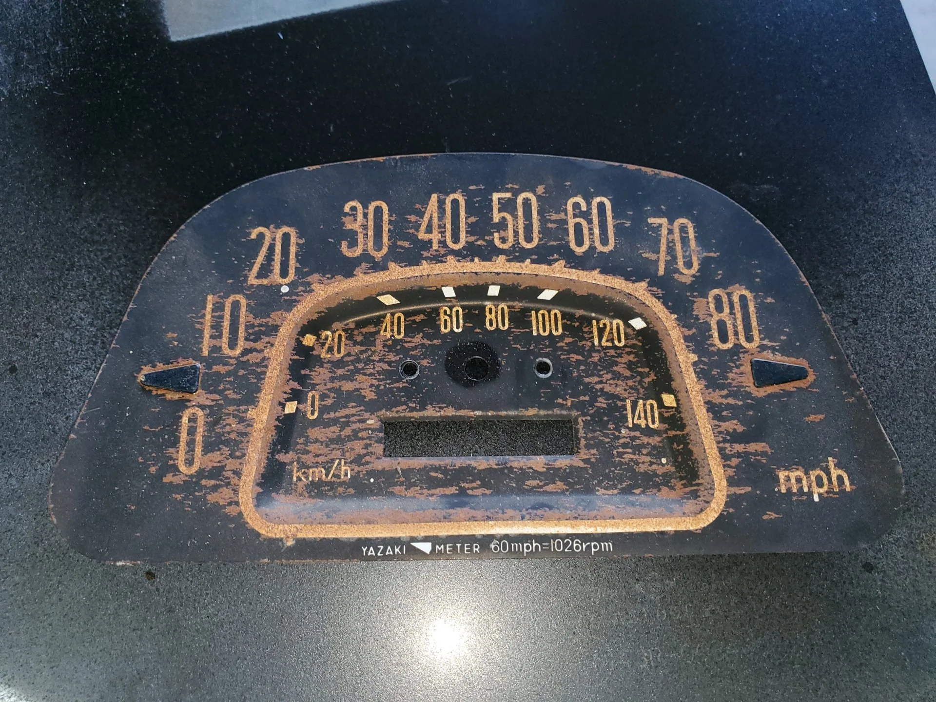

Across the bottom of the backing plate of stock speedometers it says the the number of revolutions per speed. I don't recall the numbers off hand right now.
here's an example of one...
