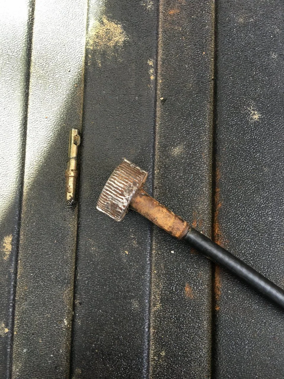

Has anyone put a new speedo cable on? My speedometer does not work and while I have everything apart I would like to replace the cable. The cable is seized on the housing and will not break loose. I have sprayed with PB Blaster numerous times and cleaned up the threads with a wire brush. I have even gone as far as pulling the cable as well as the gears out. I do not want to damage the gears or anything inside. Does anyone have suggestions?
Here is a pic...

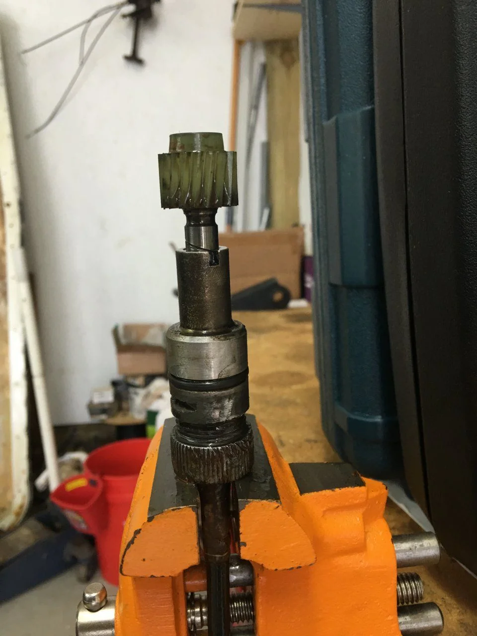

Be careful with this suggestion, but it should work.
Reposition it in your vice, tighten it up...but don't go crazy...then get a pair of good size Channel Locks & turn the riged part that screws the cable on.
A bit of an unclear description, but that prob will loosen it. Might be better to use Vice Grips instead of Channel Locks.
