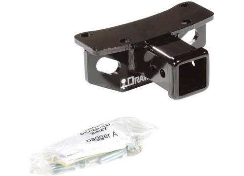

Here is how I fit 265/70/18's, stock wheels, inflated. Still working great. DrawTite hitch does not take away ANY clearance. The Curt 4-bolt did. OEM def would.
If you want to cut bumper you can do the OEM 4Runner hitch which also doesnt take away any clearance.

Hey thanks for that info! Ok so based on what you're saying, I'm guessing having that hitch receiver extension piece (with 4 bolts) will impede access to a larger spare, however (based on what I understand from your response) - if I move to a Drawtite hitch it won't impede access? I'm actually specifically looking to fit 265/70/18s ideally, so that would be perfect!

DrawTite is curved at the “front” so it follows the contour of the crossmember. Gives a solid 1/4”+ compared to Curt which is straight across. That’s why the DrawTite sticks out further which is the only downside.

Just to clarify, when you're mentioning the drawtite hitch option, you're referring to the small receiver attachment with the 4 bolts that bolts to the crossmember, correct? Not the entire new hitch, right?

Yes it is the small 4 bolt hitch that just bolts to bottom of crossmember. But that is also technically an entire new hitch. It’s just the Class3 compared to the big OEM Class4 hitch.
I think you are on the same page though.
Mine is actually the cheaper Amazon version of this. Just needs that curve at the top plate. I went this route since I only really use it for a rack too
Downside is the tube thickness is thinner and your rack can flop around more unless you shim it or your rack has means to take up receiver slop.
