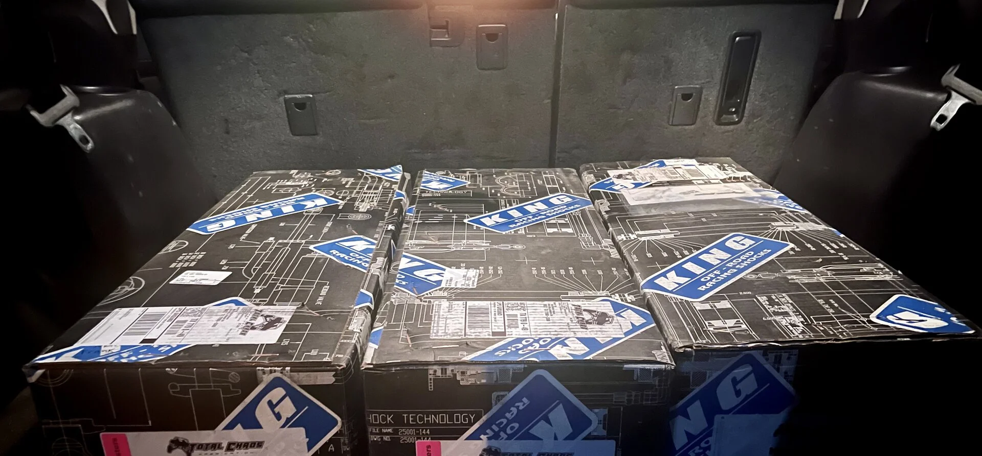

New suspension and other goodies from total chaos started showing up. King 3.0 internal bypass coilovers with 700lb springs fro the front and 3.0 bypass shocks for the rear. Total chaos customer service has been outstanding answering questions about adapting this stuff to the gx460 since king hasn’t officially realeased the 3.0 setup for the 460s yet. I had their +2” expedition long travel in the cart and ready to order, but a good friend that will be installing the fronts admitted that even though he loves his long traveled 4Runner, he would’ve went with this setup if it was available when he did his.

I may still do it in the future when it’s not a daily driver, but having my buddy that races down in Baja and builds and owns LT stuff tell me that he would’ve gone this route sealed the deal for me. I’m one of those guys that likes to think he does enough to justify it, but in reality I probably don’t lol.
Plus l, while this setup wasn’t much less the money saved will help me get the build further along.

He was talking about the maintenance and drivability of it as a daily driver along with all the extra stuff you have to do with going to long travel. Nicole at total chaos also stated that if I was on the fence about doing this setup or the long travel that I should go this route. She said that their gx460 with this setup is amazing and will do everything I need it to. She said the coilover springs being wider in diameter really helps with the ride quality offroad. She said it’s basically a race truck without a cage. I guess we’ll find out next week how true that is.

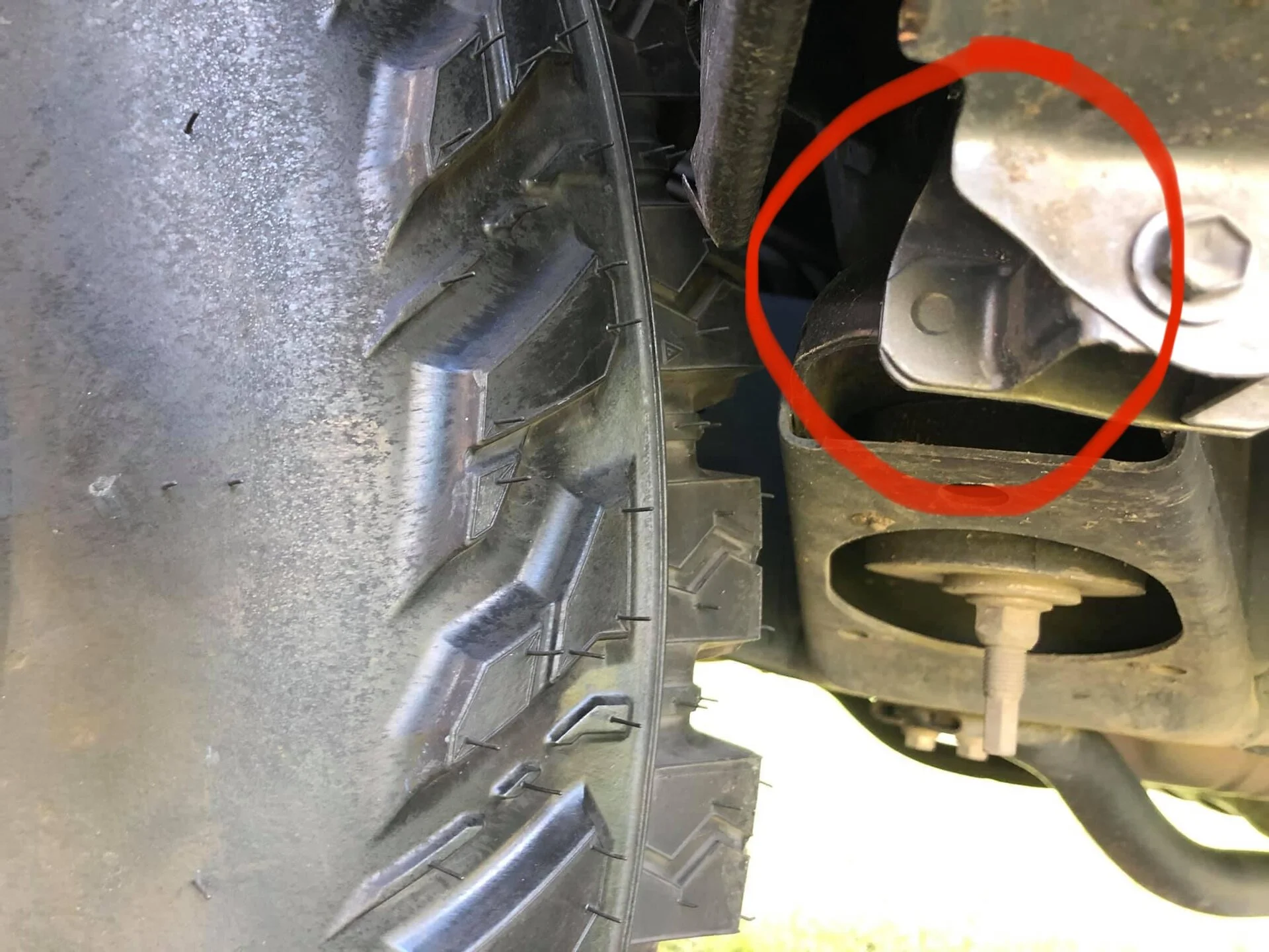

When moving up to larger tire sizes and more offset how are you guys taking care of the rubbing on these fender brackets? I’m getting rid of all my reservoir rubbing issues by going to either 17x8.5 -25 or 17x9 -38 wheels and new tires.
If it were me, I'd grind off the spot weld with a handheld belt sander, bend the tab 180* over, and bolt it back on to the inner fender and chop off the rest. It'll probably only gain you an inch, but it's a game of inches with these cars.

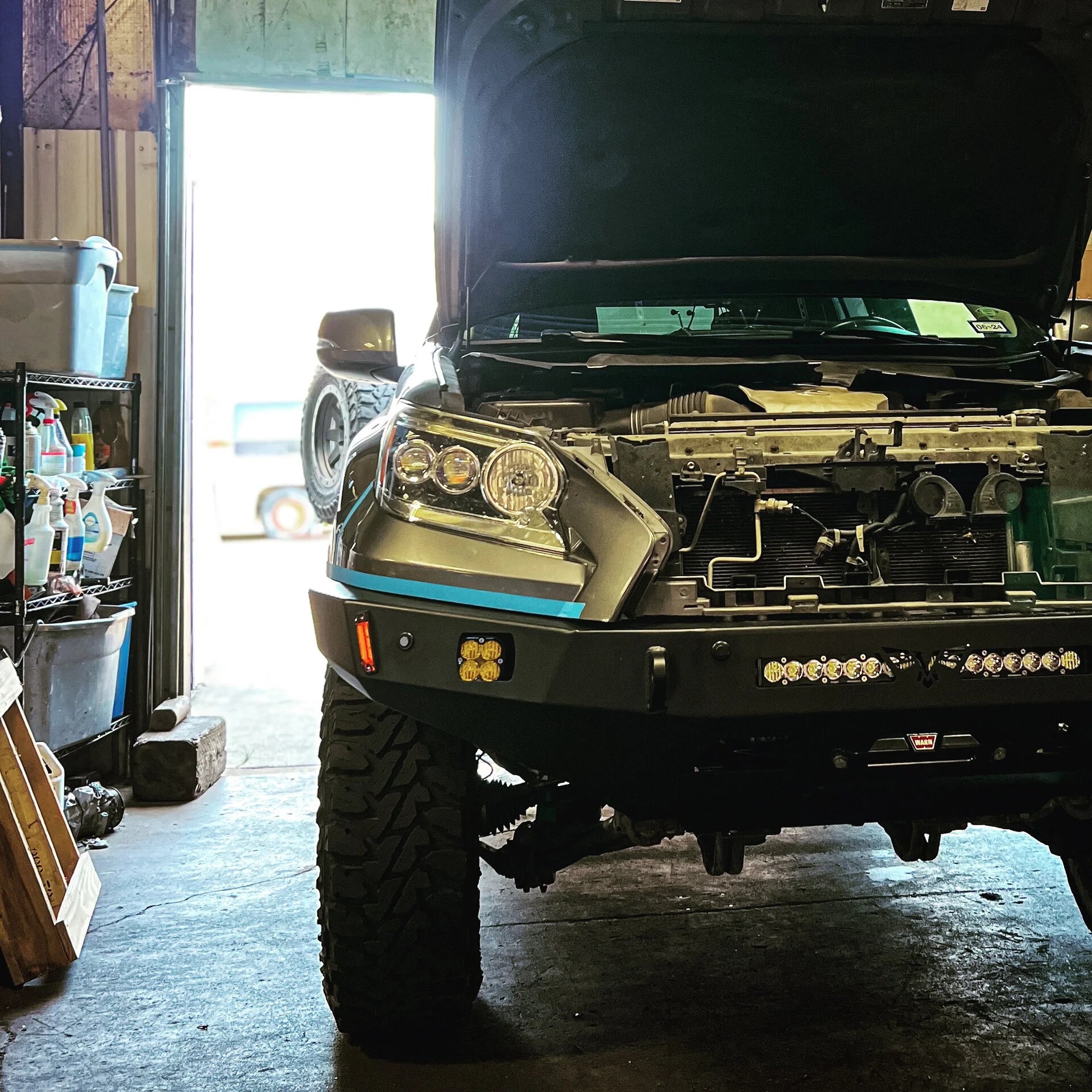

Well, it’s been an eventful few weeks. We got the reservoirs squared away with a set of 200 series lc king reservoir mounts and I can actually turn lock to lock now. Also got the goose gear drawers in and waiting on a cooler for the fridge slide. Getting new tires next week. I decided to be sensible and stick with the 285/70s since this thing isn’t a rock crawler and with the added weight of the bumper and winch I’m starting to feel the loss in power. Will probably regear without lockers in the future. Got the bumper, winch and lights mounted up this weekend and it looks great. Everything still needs to me wired up to the switch pro, but that should get done this weekend. Just need to pick up some recovery related stuff and it’s off to Colorado next weekend.

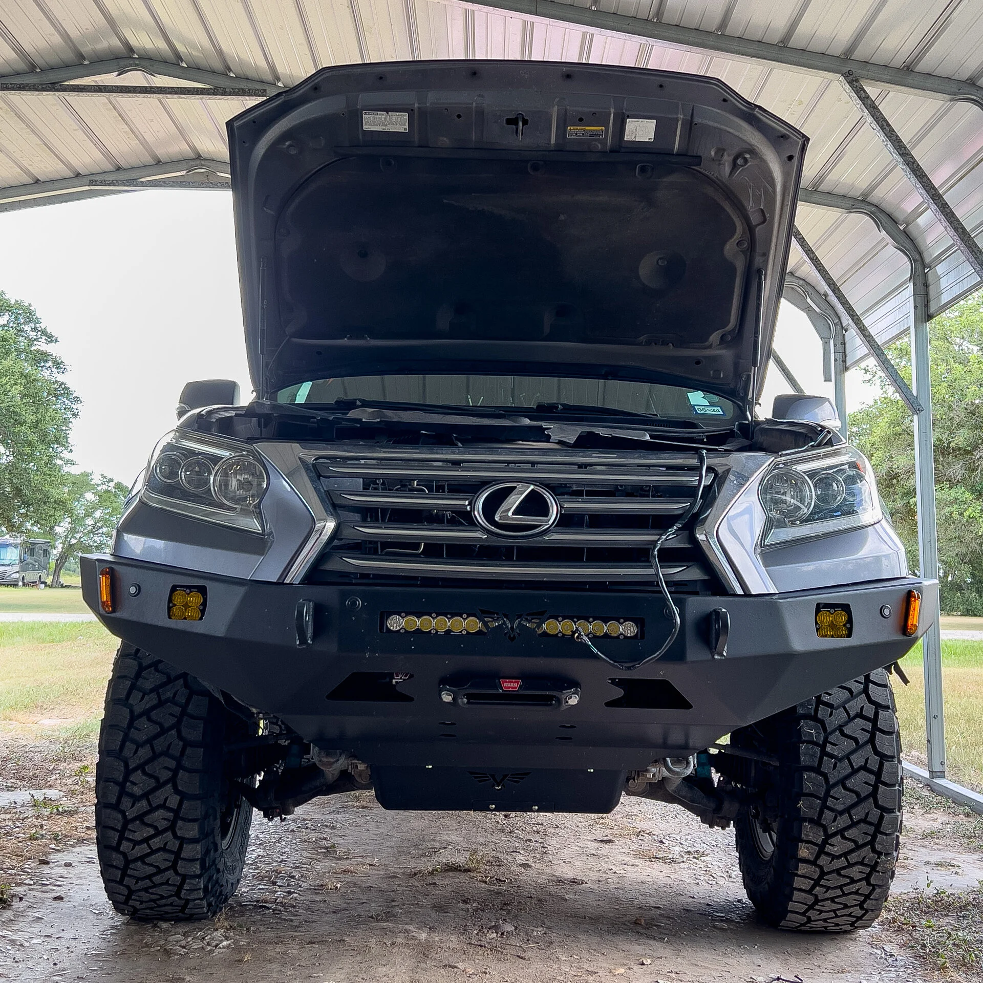

Got the winch, switch pro, and all the lights wired up yesterday. Also got a new set of toyo rt trails mounted earlier this week. Just need to relocate the backup camera and license plate light to the spare tire today and unspool the winch and respool it and attach the prolink. It’s been a crazy month, but that’s what I get for procrastinating.
