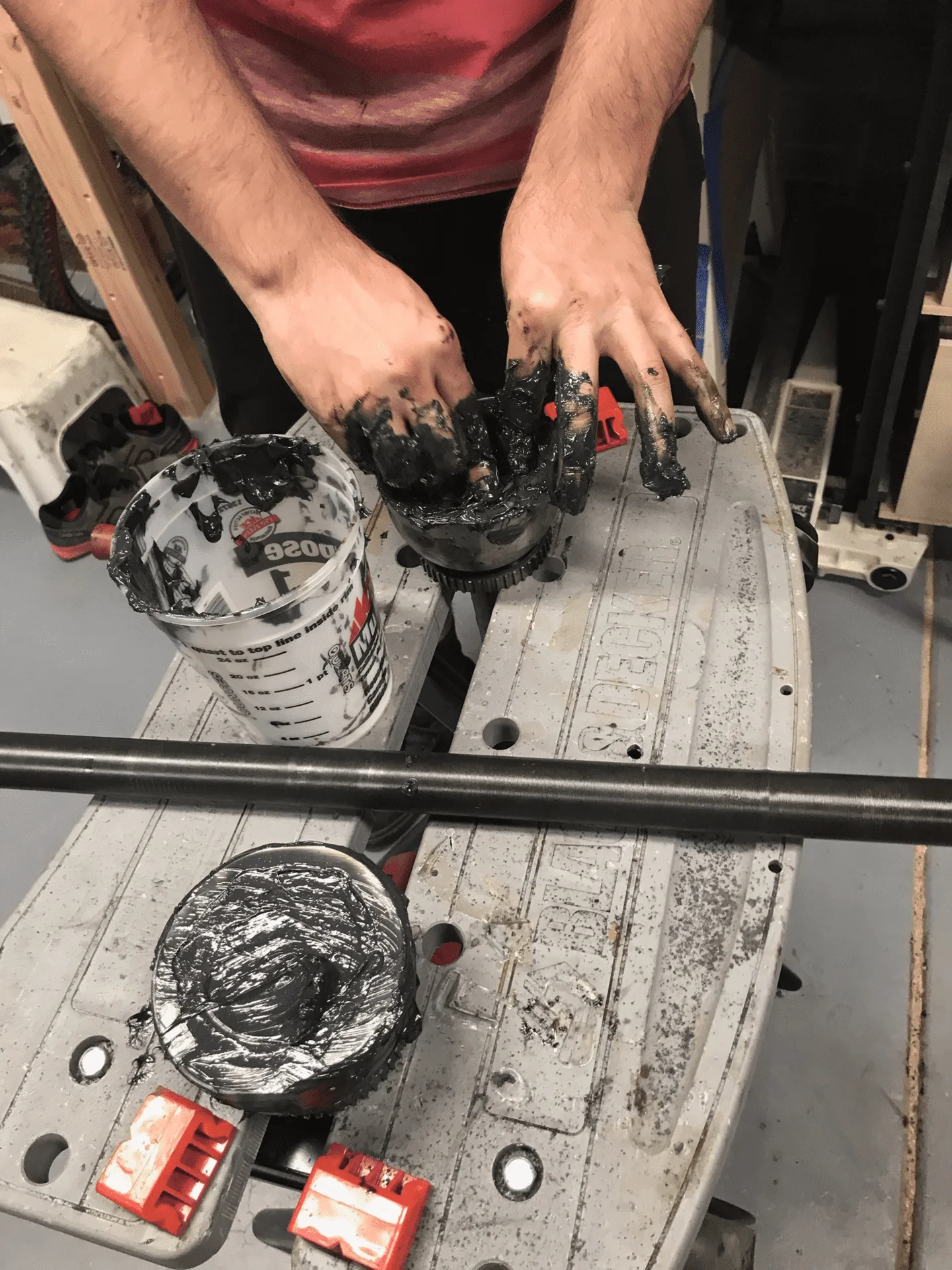

hey guys, I’m doing my 80 axles and wheelbearings tomorrow with @CruiseLanderAZ, can’t seem to find any moly grease for the birfs locally.... autozone had some STP but I was hoping for something sythetic. Any suggestions? @LandCruiserPhil got a source?
I used this in all my birf jobs.
Valvoline 14.1 oz. full synthetic grease VV985

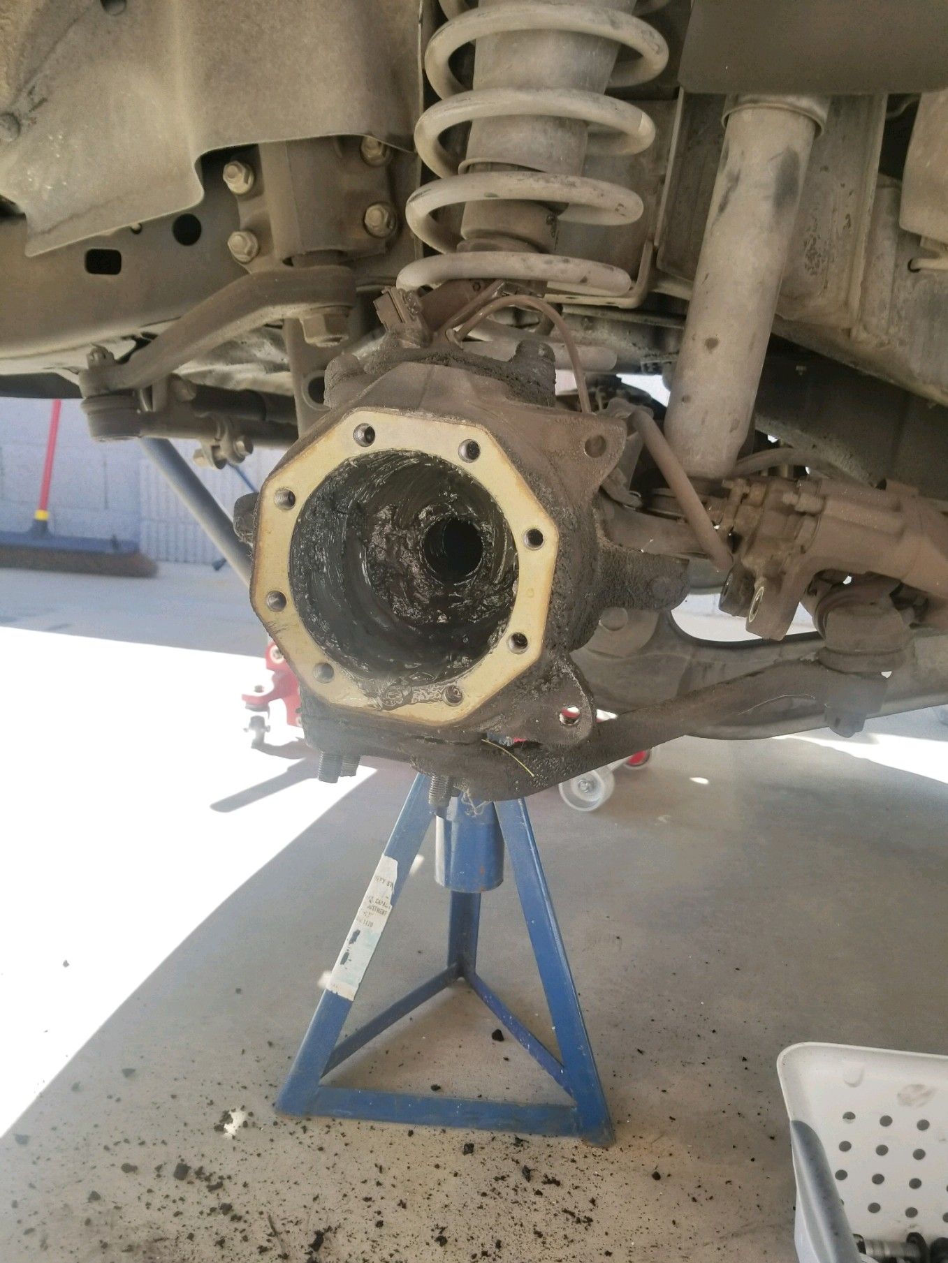

If I remember I'll snap some pictures of the bearings I pulled out... the passenger side wheel bearings had some nasty pitting on the rolling elements and all of the races had been significantly over heated, a straw yellow throughout. Packed some new Koyo's and hub with some mobil 1 synthetic and it feels night and day better.
The Oreily over by me (@blatant the one by burrito co) had some valvoline NLGI#2, moly, lithium complex. Used that in the birfs.
