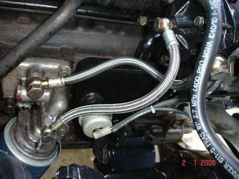

I like the "bling" of stainless braiding on those hoses:

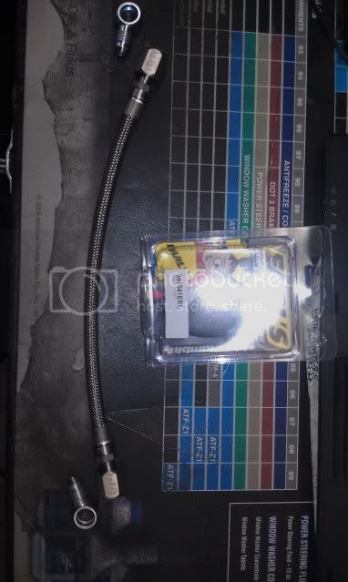

Turns out jegs sells metric banjo fittings with an-4 ends. Got those for 8 dollars each and then for a steel braided line made for ten bucks. Steel braided hose is rated for 450 degrees farenheit and some crazy pressure so should be overkill. Cost me 26 dollars total. Oh and the -an hose is readily available in my area so problem solved. Thanks for all the help.

When I first got my OEM vac pump oil hoses replaced with stainless braided ones, the industrial/marine hose specialist fitted new banjos to the braided lines and never said anything about having problems sourcing them.
Those braided lines are actually a bit stiff for my liking. They're teflon hoses underneath the braiding if I remember correctly ... And that's the material they recommended for a "hot pressured oil" application.
However one of their hoses started to weep oil at one of the crimped joints soon after I fitted it and I eventually took it back to them for a replacement. (It took me a while to work out where I thought the oil was coming from because it was a very slow weep and I wasn't positive of the source even then.)
I didn't say anything about their work being substandard because of my doubts about the source of the weep and because I felt I had allowed too much time to elapse before coming back to them with a problem.
So I just asked them to make me another hose.
However this second time (despite it being the very same branch of the very same company) they said they couldn't get new banjos and had to reuse the old ones off my OEM sample hose. :meh:
