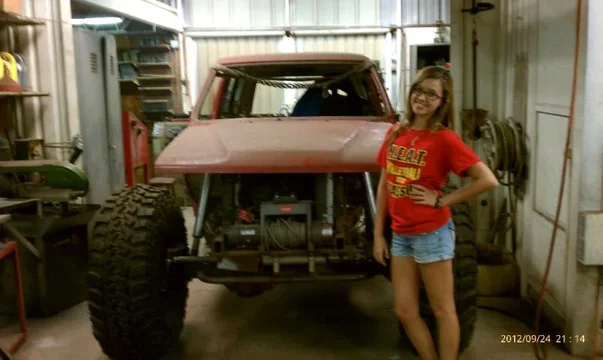

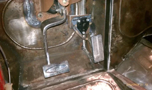

Brake and go pedals bent and mounted!
And got a pretty girl to model!

Its amazing how long bending all the pedals and linkages can take. Even more amazing is how much more Devin can get done when I go watch volleyball games.
Got the frame rails extended out front to get the winch mount and start on the stubby bumper!
