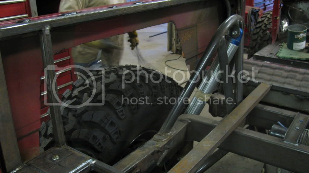

Got to work some on it yesteday.
Ran some condiut down the bed side to run the electrical in later on:
Trimmed some more out of the rear fenderwells to keep it even lower.
Started boxing in the rear floor and the fender tubs:
Decided to flex it out to check the rear fenders:
And then stuck Devin's wife Tammy under it to show how high its flexing!

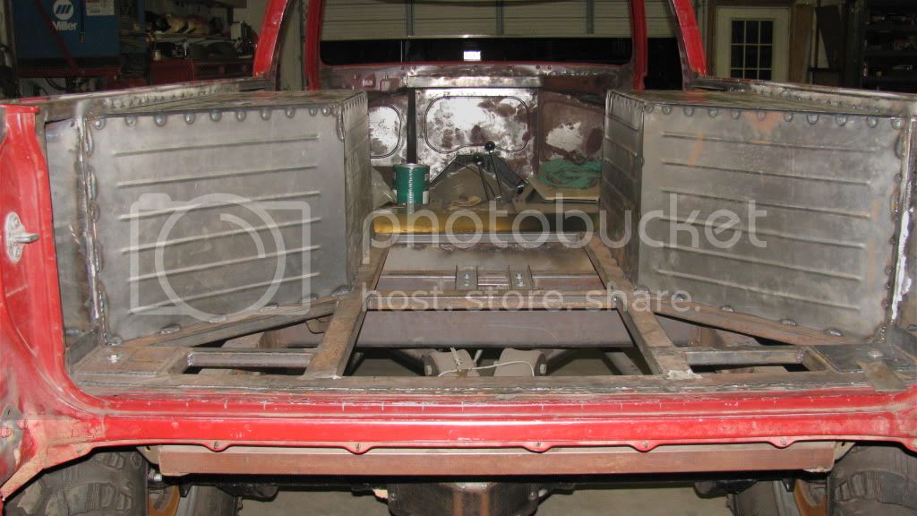

Got to work on it some today. Got the rear wheel tubs done!!!!!! Everytihing will be ground down seam sealed and bedlined when its done. The bead rolls are a pain in the rear to do but add a lot of rigidity.
Now we need to do the floor but it will go a lot faster. The speaker area and cubby holes that go beside the rear seats need to be done as well and then the body will come back off for welding out and seam sealer. The sides of the wheel tubs are on an angle with a bend for rigidity. The floor is planned to use nutserts and be able to remove the bed completely to access the rear winch and fuel tank.
Can the same be done to... oh... nevermind.
