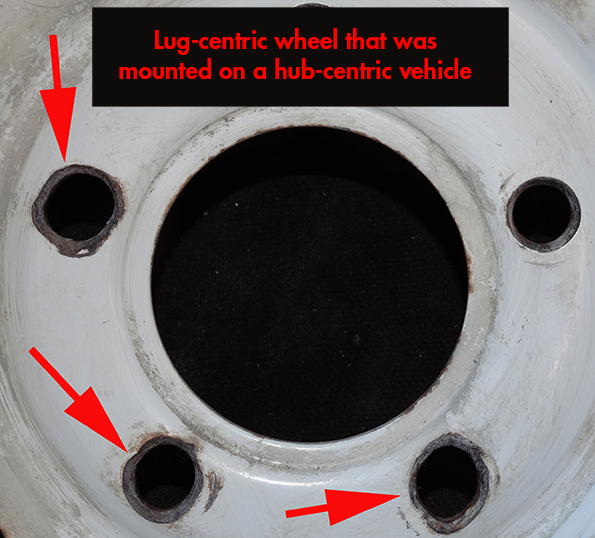

That's a good question. There are ceratinly many, many examples of failed aftermarket wheels (Google it).
However, it is not just catastrophic failure that concerns me with the wheels in question. I have not seen anywhere that these wheels are hub-centric and NOT lug-centric. If they are not hub-centric, this could easily happen:
Further, the wheels in question have an offset of 12mm. That means the wheel sticks out almost 2 inches further than the stock wheel (60mm-12mm = 48mm -or- 1.9in).
My only point in all this "geeking out" is that we should be aware of the specifications and requirements of our wheels when we look for new ones. There are a lot of great wheels available out there with Load Rating >2500 pounds, with a hub-centric design, and with appropriate offsets - why not choose one of them instead of rolling the dice with something way outside the design criteria?

Really! Now we’re just grasping at straws and looking for areas to increase our pocket-protector extraordinare status LOL. Hub-centricity is often a given for nice wheel companies so many do not explicitly list.
1) Yes they are hub centric. They run buttery smooth at ALL speeds
