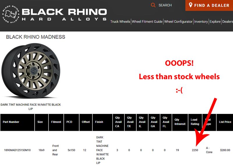

What's the Load Rating for those wheels?

No oops. 2250 per wheel or 9000 total lbs is more than enough for us. Have no intention of loading my truck down with 3k lbs! It’s the wife/fam mobile with the occasional off-road or camping. I suppose I would have to have 7 passengers plus luggage and also a pop up trailer on the ROOF instead of being pulled to exceed the load! At least it’s not a 20” or 22” with rubberband tires!
I used to nerd out in regards weight of wheels for my sedans and sportscars - using only the absolute lightest. Now I just make sure they’re not heavier than average abs pick a style I like!
Speaking of load I’m curious how many here have ever exceeded load or see a wheel give out under load?

No oops on my part. 9000 total lbs is more than enough for us. Have no intention of loading my truck down with 3k lbs! Plus it’s the wife/fam mobile with the occasional off-road or camping. I suppose I would have to have 7 passengers plus luggage and also a pop up trailer on the ROOF instead of being pulled to exceed the load!
It sounds like you'll be okay with mild offroading but it's not hard to get an LC on 3 wheels on even moderate trails. IMO that's where the load rating really starts to play a role.

If all a wheel had to do was support 1/4 of the static weight of our vehicles, then we'd all be sporting wheels that looked like spiderwebs and weighed less than 5 pounds.
When rating a wheel for load, many factors must be considered; but the most demanding would be live loading. Live loading is the load a wheel/tire combination experiences when striking a pothole, hitting a curb, banging into a rock, cornering hard, etc. Under such dynamic conditions the actual load on a wheel/tire will be much more than just vehicle static weight.
Toyota have determined that a load rating of at least 2,512 pounds is required for a wheel/tire combination used on a stock 200 series Land Cruiser. Go below that, as with the wheels in question, at your own peril. Obviously, your rig - your choice. Just be aware that you will be operating below the safety limits the design engineers specified for your stock rig. Running a wheel with a lower than stock Load Rating is like running a tire with a lower than stock Load Limit - probably OK under most circumstances, but sooner or later something's going to give.
HTH
When I go on the black rhino site it does not offer these as compatible. This is probably why.
