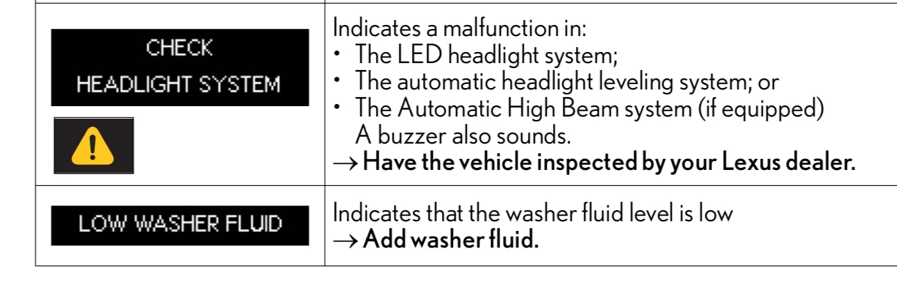

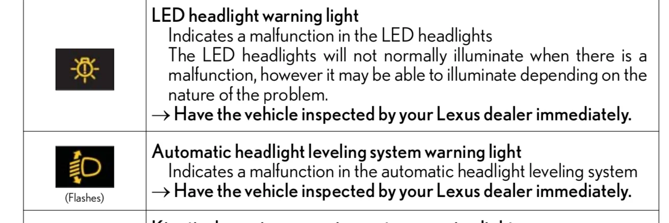

Not aware of a “bulb out” warning message. Where is that being displayed?
Only lighting based warning messages I see in the owner’s manual

This is the warning light. Both front and rear overhead lights come on.

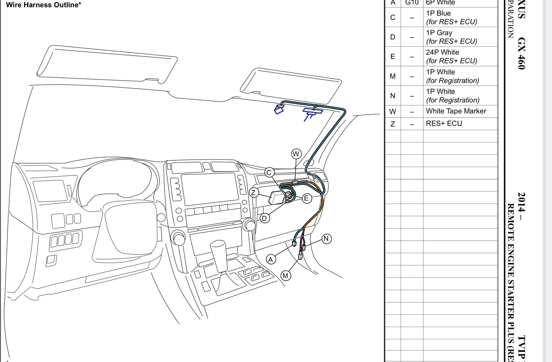

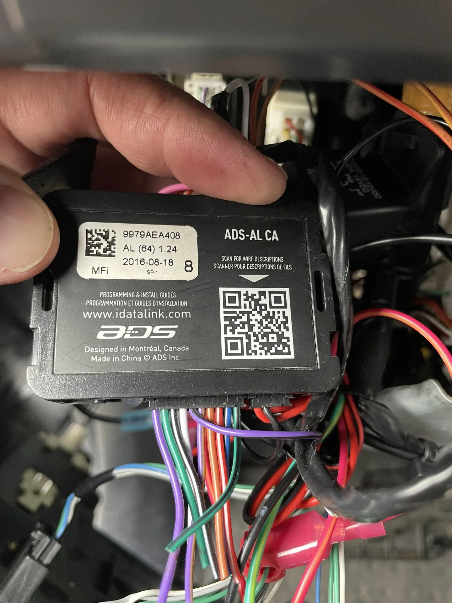

A few other problems started popping up witch gave me some clues to the cause of the problem. The car would lock with the fob inside and it also started by it self. I removed the dealer installed remote start module and all the problems stopped. Thanks for all the help.
Hey! I just bought a 460 and I believe it has "dealer installed remote start"! How did you uninstall it? Do you have a thingy on your windshield?
There wasn’t anything on the windshield. I found this under the dashboard on the drivers side. Just unplugged all the wiring harnesses from it. Going to go back in another day ad trace the harnesses back to where they tap in and disconnect them for good. But for now all my issues are solved.
Btw. Those cut wires at the bottom were like that when I found it. Looks like a real hack job.
