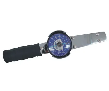

Next, how do I set preload on output, without something to measure with.
I only have a fish pull scale and a torque wrench....
And one shim.

preload is set using the shims to adjust load(more shims for more load, less for less load...) and the fish scale pulling on one of the flange studs- the scale needs to pull the flange at a roughly 90* angle to the stud; picture the long hand of a clock with a 90* arm at its tip to pull from...this needs to be more than 1LB for a used bearing and between 4 and 12 or something pounds for a new bearing...going from memory, so double check those specs against FSM...
Buy one of THESE, then sell it when you're done. You can't accurately set this preload with a fish scale. The values are in In-lbs not Ft-lbs. (7-20 in-lbs depending on bearing status)
The output shaft bearing preload is the only place where you will use this very specific torque wrench. But unless you've done it a few times before, it's hard to know what the preload should feel like just by feel without a micro torque wrench.
I can tell you that if the rear flange spins easily when the bearing retainer is fully tightened up, then the preload is too low, even if no slop can be felt. When the preload is within spec, noticeable drag can be felt when turning the flange by hand... but not excessive.
Without having felt the correct resistance by hand previously, there is no way to be sure that you've set the preload to spec. Gotta bite the bullet and get one of these wrenches. Their resale is high, so in the end it doesn't cost much.

these aren't Rovers and we aren't bankers:p but you can spend your money on one of those if you want...I almost suggested one as an option, but decided not to insult any MEN reading this:flipoff2:
