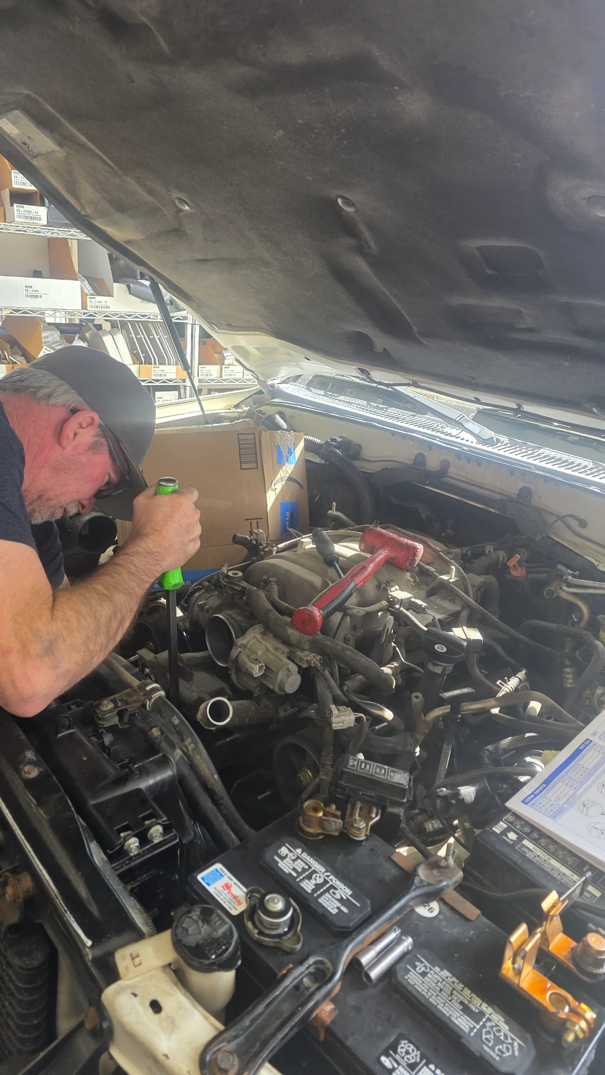

Picked up a LX470 with the help if @Delta VS
In Idaho, hitched a ride with Simon.
It has 353k miles on it, lots of little things broken. Engine seems great, but has low oil pressure at warm idle.
first thing is to replace the timing belt and heater tees.
Went to @Delta VS to pick up the vehicle, Dave was nice enough to pick it up for me.
Simon, Ryan, Dave and Randy all helped get the rig road worthy.
New timing belt kit frim Aisin and new Heater tees were the main things.
