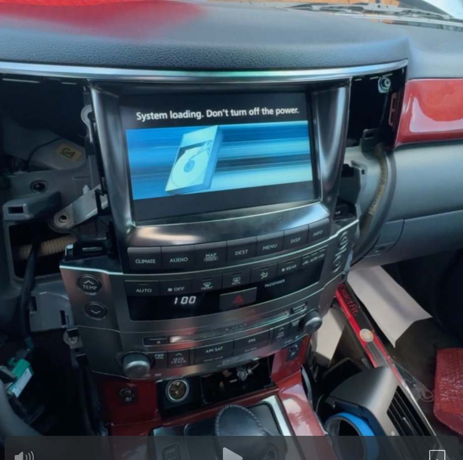

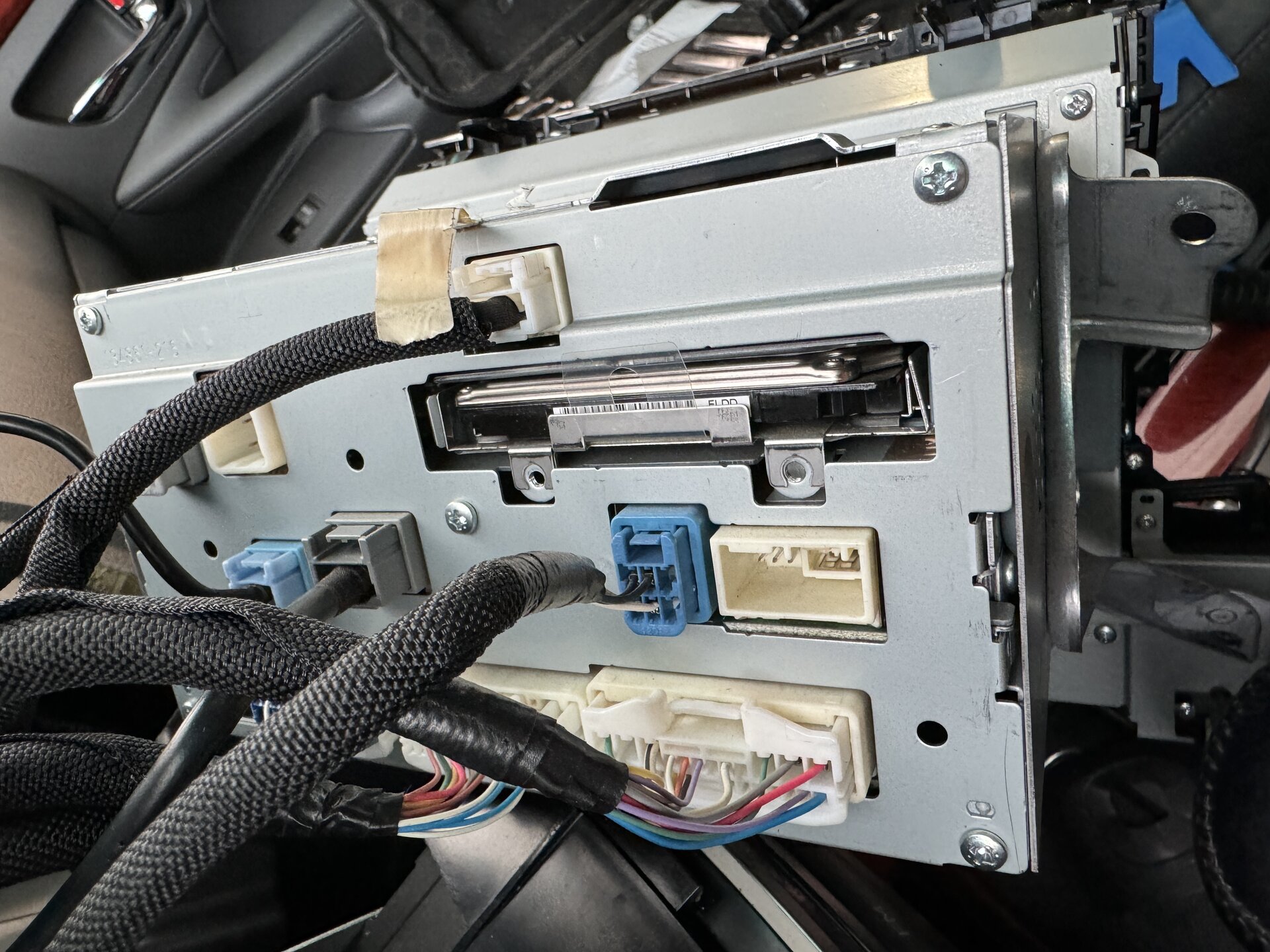

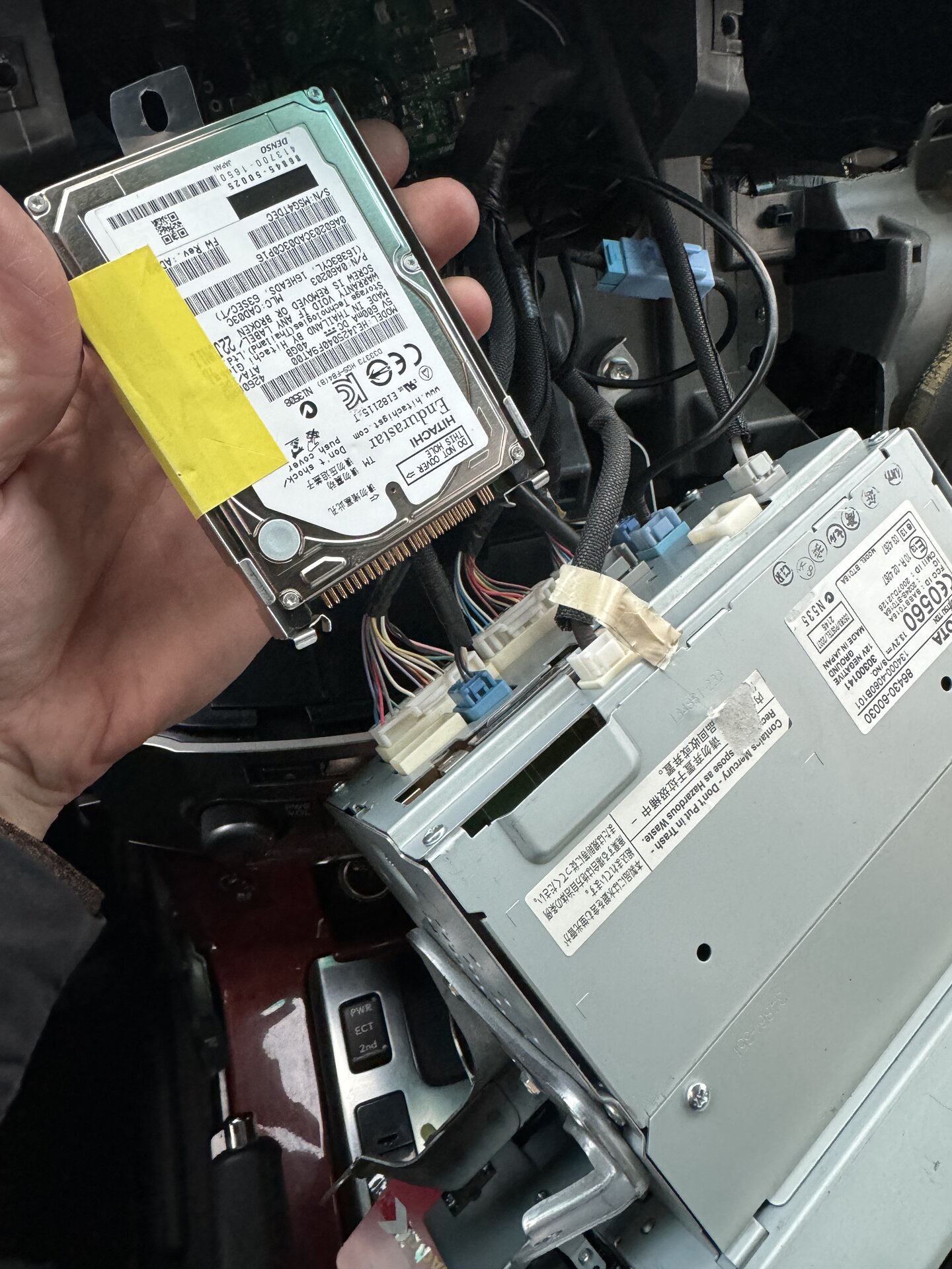

The hard drive is located on the back side of the nav unit in my 2008 LX570 and requires a T10 to remove the screws then pull out. (battery disconnected at this point). To install the new drive simply push it into place, it'll click sorta, then put the cover with T10 screws back on, slide it back into place in your dash, then connect your main battery, then push the start button once with your foot off the brake and let it boot up at which time you see an "installing" screen. Hopefully, this helps others as I found a lot of dead-end searching.

Based on ebay and the images above, the hard drive is a Hitachi Endurastar "hej425040f9at00". Here are the specs:
Here is one on ebay, it's $500.
Here is the exact part number, that's available all over the net, brand new, for between $125 to $225:
