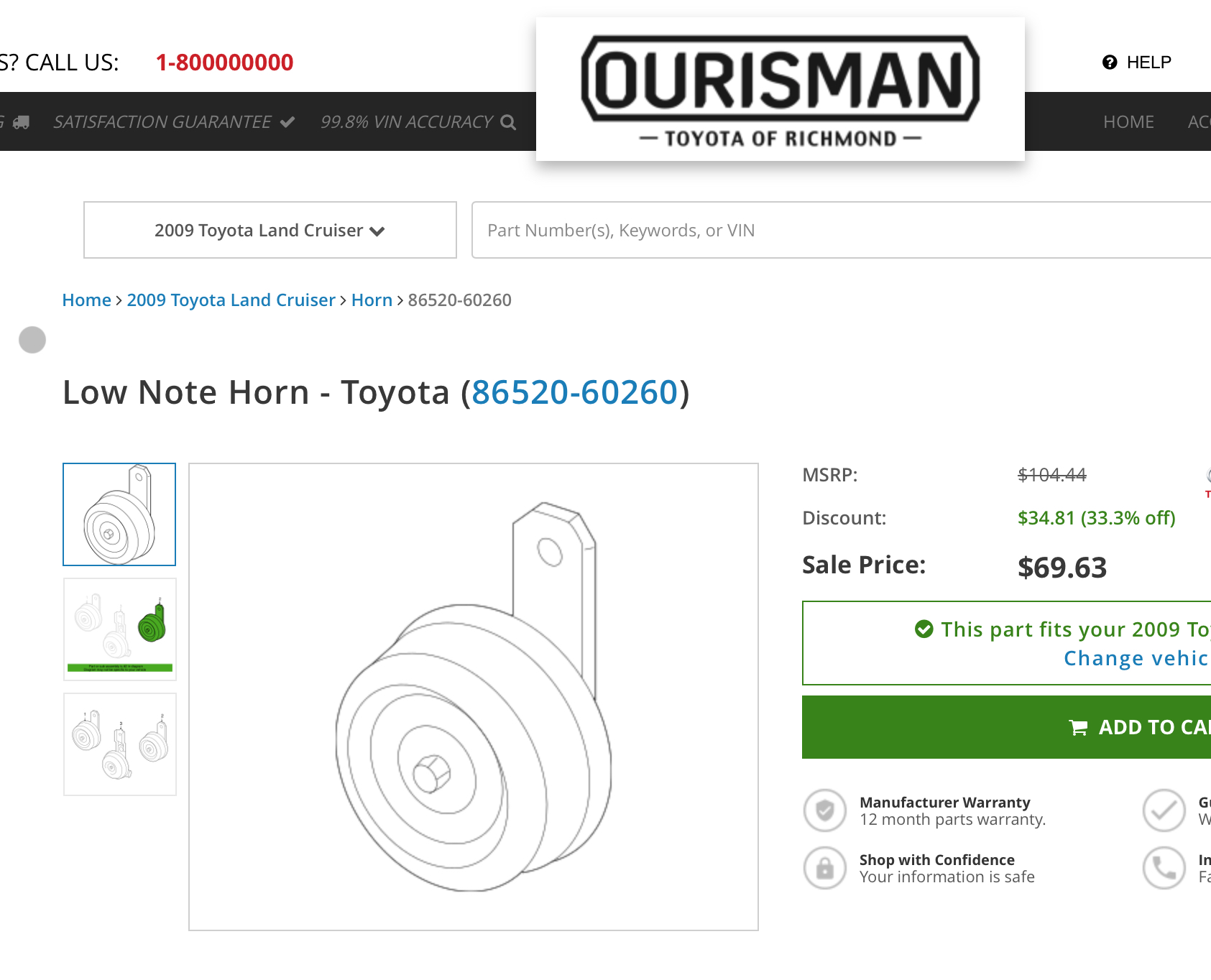

UPDATE: finally had some time to get under the hood and test the horns. The low note horn does not work. I removed both horns, cleaned terminal connections with Deoxit, reinstalled, and the low horn still doesn’t work. I swapped their positions (connectors are the same), and the high horn works in the low horn’s spot. Thus, I have determined the low note horn itself is faulty.
Part number is 86520-60260.

The horn retails for 104.40, but OoR Toyota has it in stock for $69.63.
