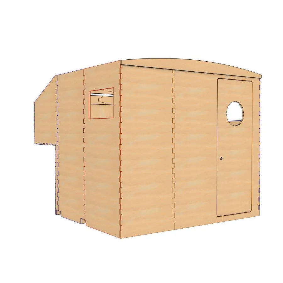

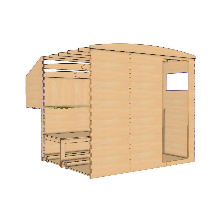

Been working up a model to cut out on the cnc for a mini camper for the event. It'll go on the front of my gooseneck partially hanging over the hitch
Hopefully the whole thing goes together easily. I'm hoping to burn through less than ten sheets of ¾" plywood to make it happen.
i count 12 😁

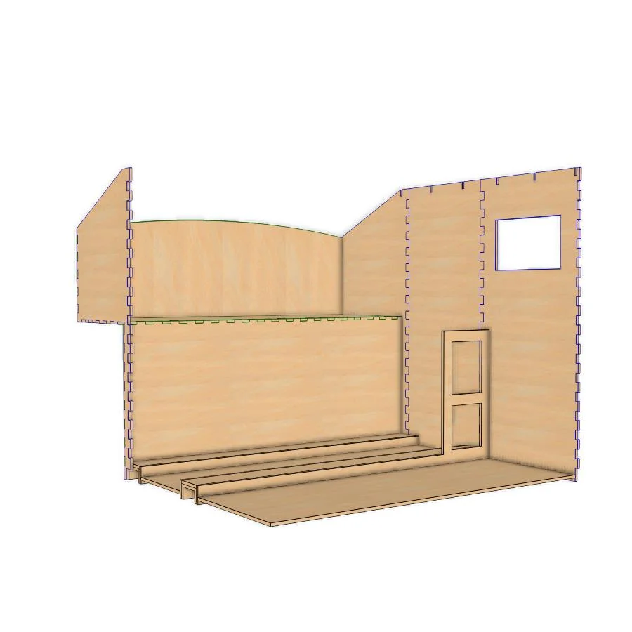

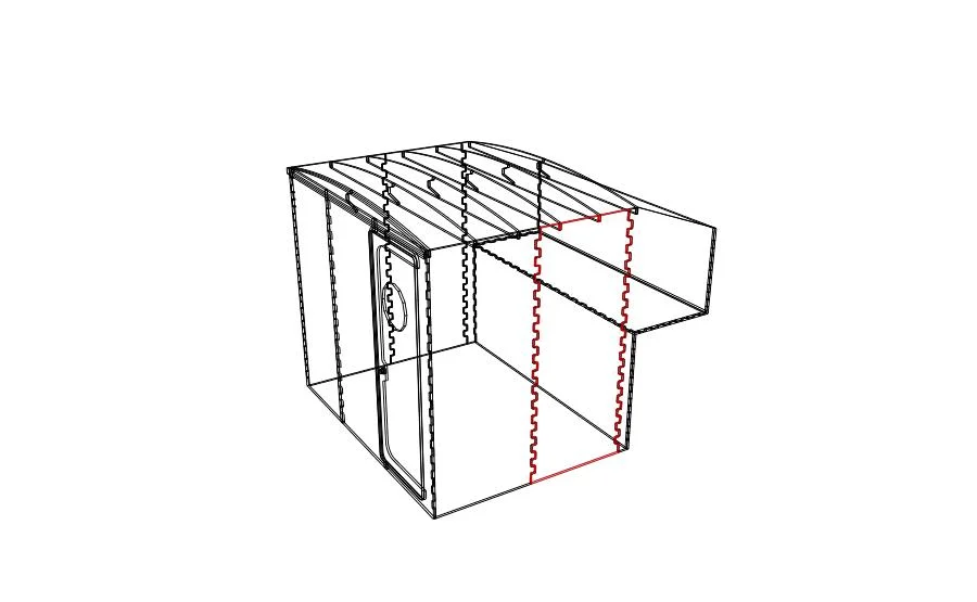

Really close to being able to cut this out.
I need to add a ton of bracing behind all of the goofy joints.
Drill a whole mess of holes
Then there's an acre of machinging that has to take place to clearance the material in the corners where the box joint is going to be.
I'm up to 16 sheets of material..... lol
So much for ten, and optimism.
At the bottom there's material stacked and stitched up for fork pockets.

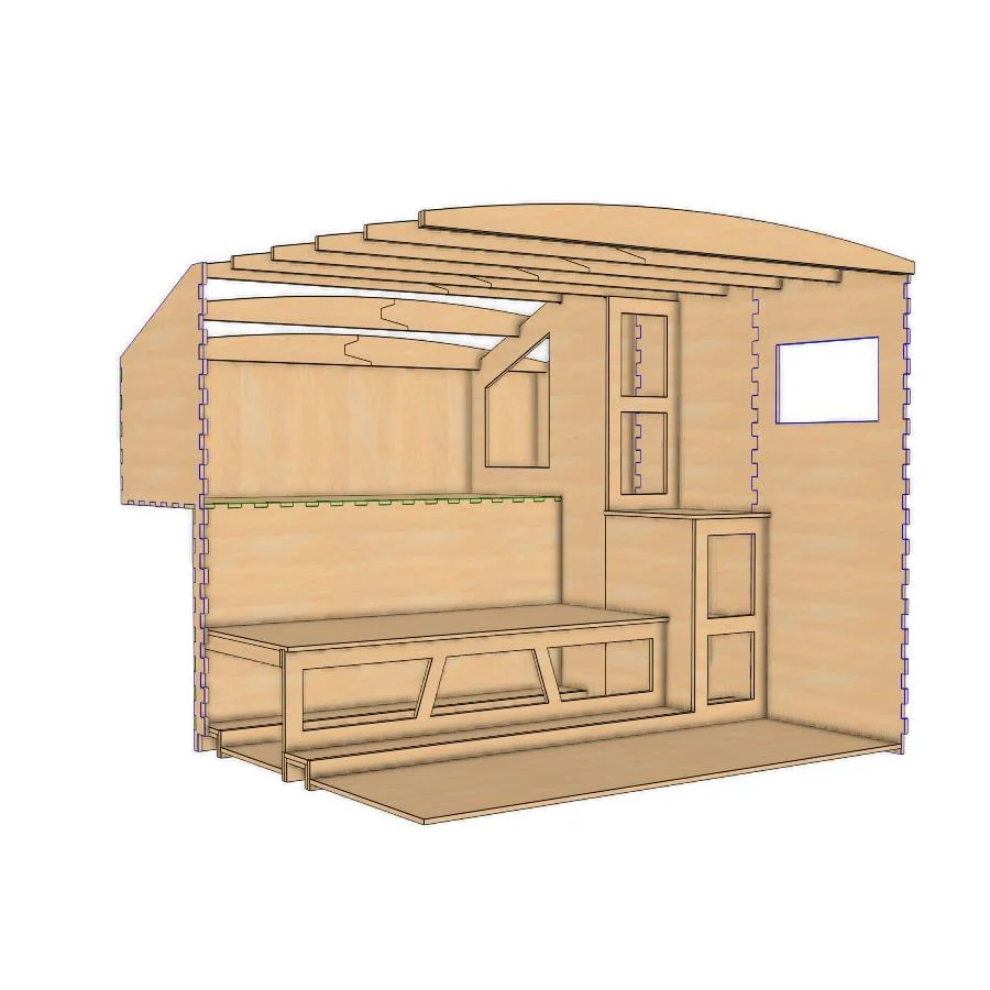

The lower bed frame with the interior storage added.
Roof Ribs in place
Back Wall with the door opening
and, all of the parts including the door being shown. If I have time, I'm going to cut a TEQ logo out and put it in the round window in the door.
My buddy said I should make it a half moon like a s***house. I told him I'm going to put the TEQ logo in there, he said "Same thing isn't it?" I laughed pretty good.
I need to come up with a clever way to make those side windows apron out for some ventilation. I've gotta sense that the dog farts and stinking dude smell is going to get thick otherwise. Maybe I should think about some sort of door to add a fan to shovel air through there too.
roof vent
