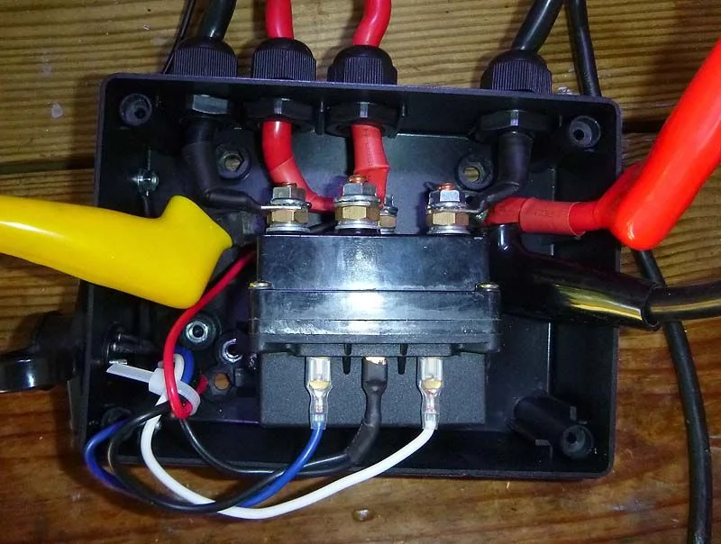

Just for reference, this is what's in the box from HF (don't mind the looped-back cables, they're just for my reference...); reference number on the back is D130424, on the side it's ZJSF-41X DC12V.
No luck searching for either number so far, except for one fellow who had trouble with this on his 9k winch...
It looks like a Chinese knockoff of the Albright that comes on the Chinese winches that are claimed to be water proof or water resistant. It looks sealed. The other cool thing about the Albright type contactor is that it has a fail safe feature where if both coils are accidentally energized, the circuit is open. I would take a chance on it because it isn't the style that has a high failure rate.
Ya crap Chinese albright knockoff the real albright has the controller wire pins on the top.
