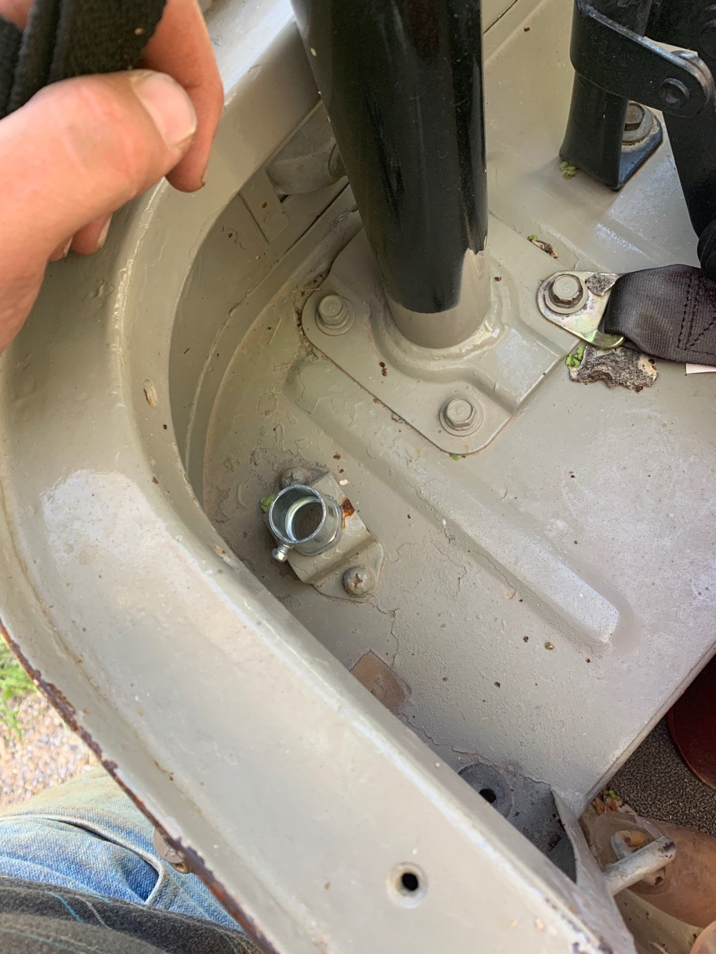

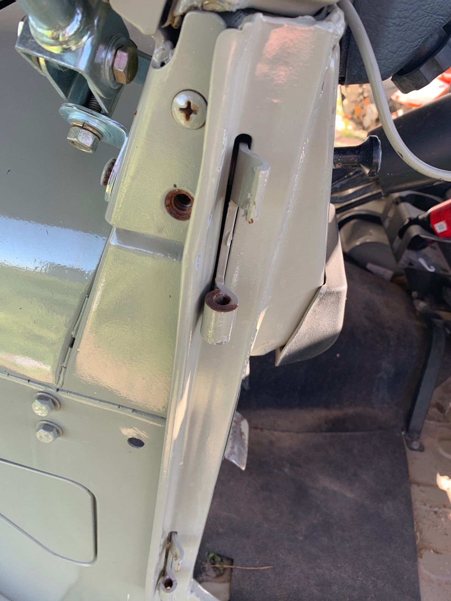

He didn’t take very good pics but I appreciate him doing it for me. Here’s hinges n rear with socket in hole. Thx
I’m away from it at present. I’ll have my son take pics of hinges and post tonight Thanks for your help
pics of door hinges n hole for bows has a socket on it
There's a bracket missing in the rear corner up on the tub edge. You can see the two bolt holes.
It definitely is FST. You're just missing those brackets.
