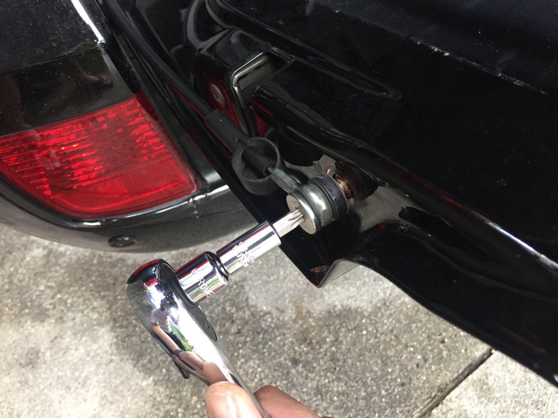

Just did this today. Took a little over an hour. Man, that torsion bar makes it a PITA to remove the tail gate. I ended up with a bunch of scratches in the hinge area of the lower tail gate. Luckily the flap hides those hinges. So make sure you have some touch up paint on hand for those scratches and also to paint the sides of the drilled hole. If I were to do it again I would use some duct tape to tape the areas around the hinge to protect the paint while removing the tail gate.
I was expecting some trouble loosening the T-40 bolts of the check cables but my T-40 torx bit fit perfectly and had no problems loosening it.
I also had to install the damper itself while the tail gate was in the closed position. I first tried installing it in the open position like stated earlier in this thread but it wouldn't move.

I didn't have to replace or remove the torsion bar, I just had to loosen the torsion bar bolts on the tail gate so that I could get some wiggle room to unclip the bar from the mount in the body (it mounts from the bottom). You could remove the tail gate and install the damper without having to remove the interior trim panel, but I removed it anyway since it's just four bolts and some plastic clips. A plastic trim panel tool made removal quick and easy.
A couple of tips. If you reach inside the tailgate after you have the cover off you can slide to torsion bar towards the center of the tailgate, This will relieve some of the tension on the torsion bar. Also my 2011 had no mark where the nut was located. I used a small bit 5/32 to start a pilot hole and then adjusted accordingly. You can spin the damper and install it with the tailgate opened.
hrtrob, glad you were successful at the project. it is a great mod. Cheap too. having more hands makes the work a lot easier and without any unforeseen damages. but it is recommended to have touch up paint for the nuts that need to be loosened which could not avoid getting chipped paint. agreed with whiskerz that the damper could be turned manually to the open position so that it cold be installed more conviniently.
