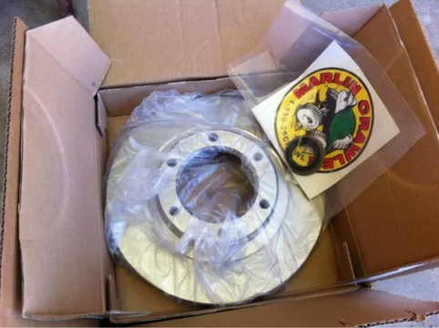

Knuckle re-build kit and rotors in the mail!
Me versus my front axle sometime in the next couple of weeks. My first work on the 80 since I've gotten her. Wish me luck!

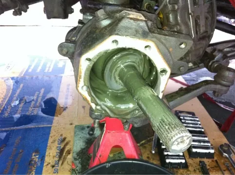

Impressive pea soup! Get it all finished ok?
