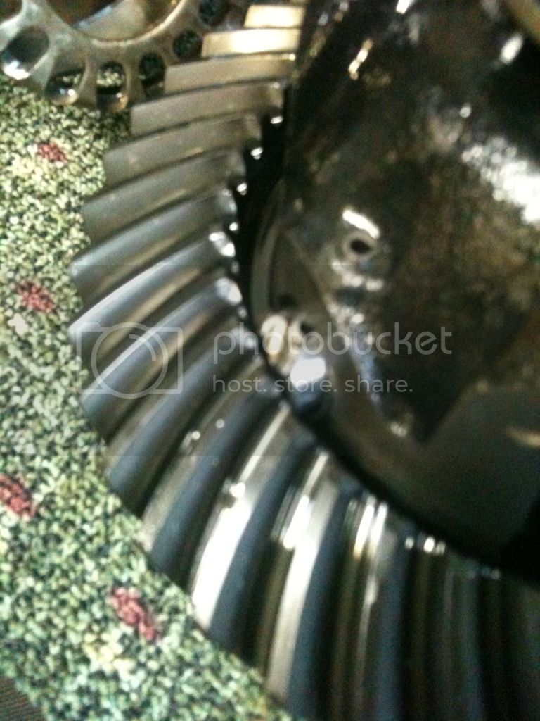

So pulling the front diff out again suspecting a shattered crown wheel and pinion after a good night out in the sand dunes, but something a little different when getting the centre out today.
The pin that holds the spider gears normally in my case a lunch box locker has snapt into 3 pieces somehow,
This has let the ends out and get in the way of the pinion gear and chewing all the ends of tue teeth off.
The crown wheel is somehow in perfect condition.

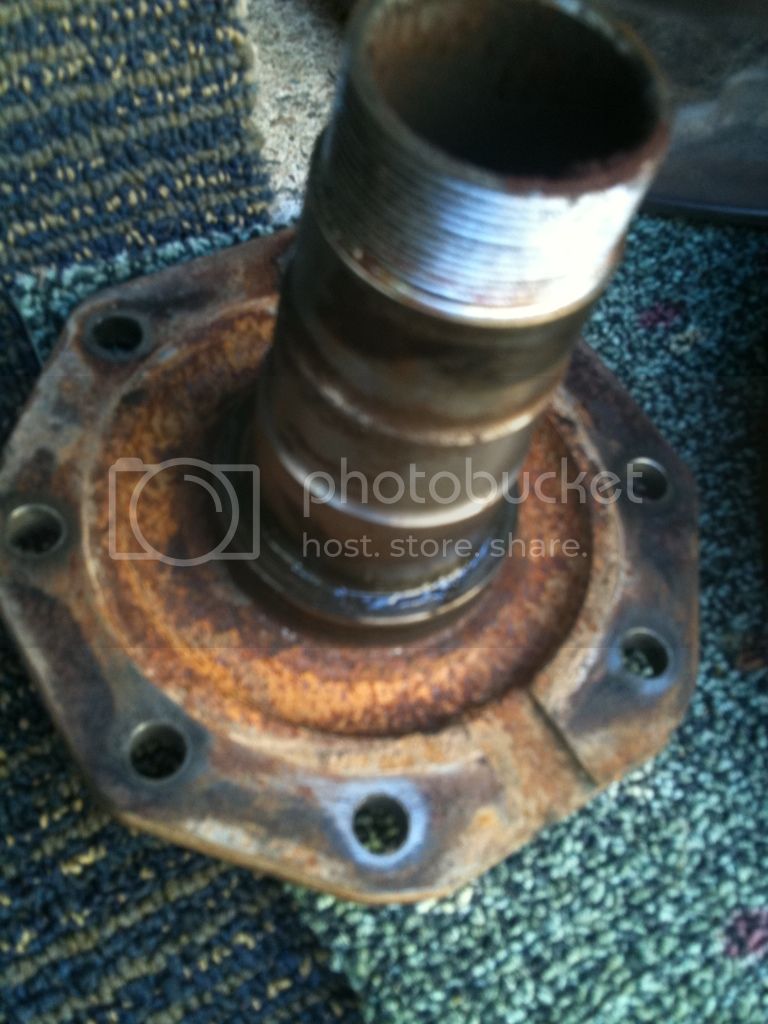

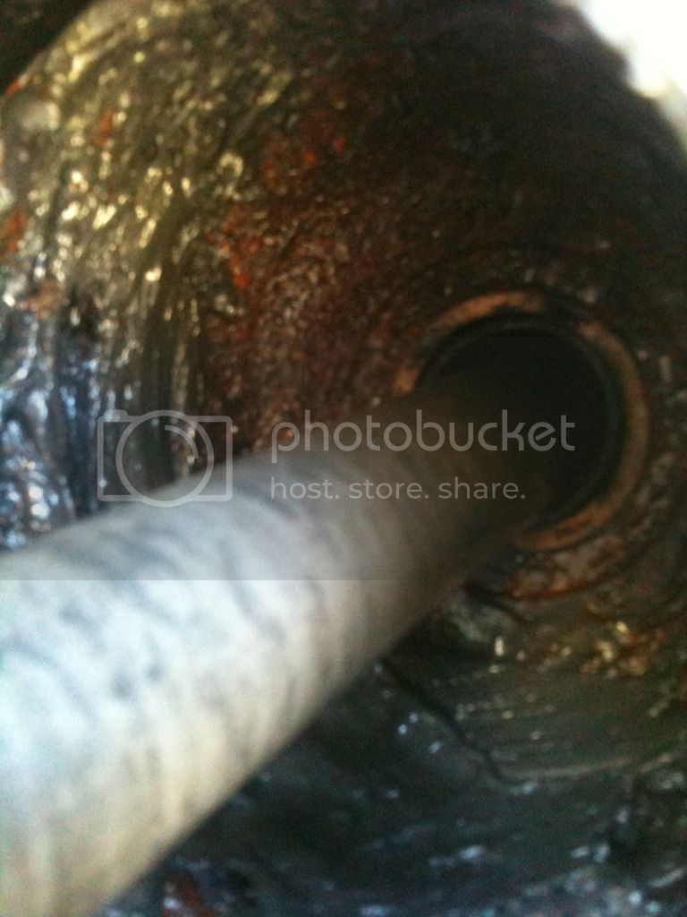

From the left hand side , seems to have had some serious moisture or water to cause the surface rust
Clean with wire brush?
Looks like the inside of a old sewer drain, all that rusty looking snot wiped out

They both cleaned up good, but there is still a bit of surface rusty like grim on the back were the seal swivels over , should this be spotless shiny clean?

Hard to see but all the ends are smashed off
Hmm little pin let big pin go then slide out and smashed pinion teeth
Was a mission to hit the pins back in to slide the crown gear off
You can see the rhs of the pic the locker and diff centre damage from the pin

I was wondering if the bolt that retains the cross pin was still in place, but from the breaking point of the center pin it looks like the locker sheared the cross pin in three.
Was their something free in the diff that caused the damage to the ring and pinion there?
cody c said:
I was wondering if the bolt that retains the cross pin was still in place, but from the breaking point of the center pin it looks like the locker sheared it off.
I'm not to sure I'm trying to think how it all works in conjunction with the pin,locker,axels etc to wether like you said if something jammed in there and caused it to bind up and snap or if it was just my right foot on the go pedal.?
