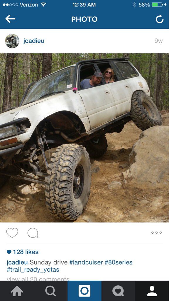

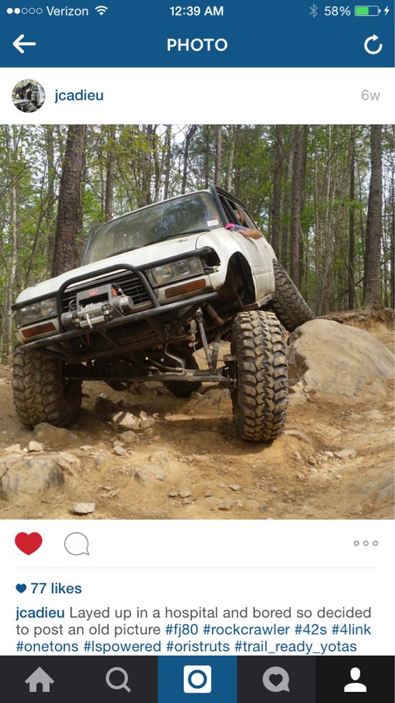

That's the guy! I was going to share screenshots too but couldn't remember his Instagram name
