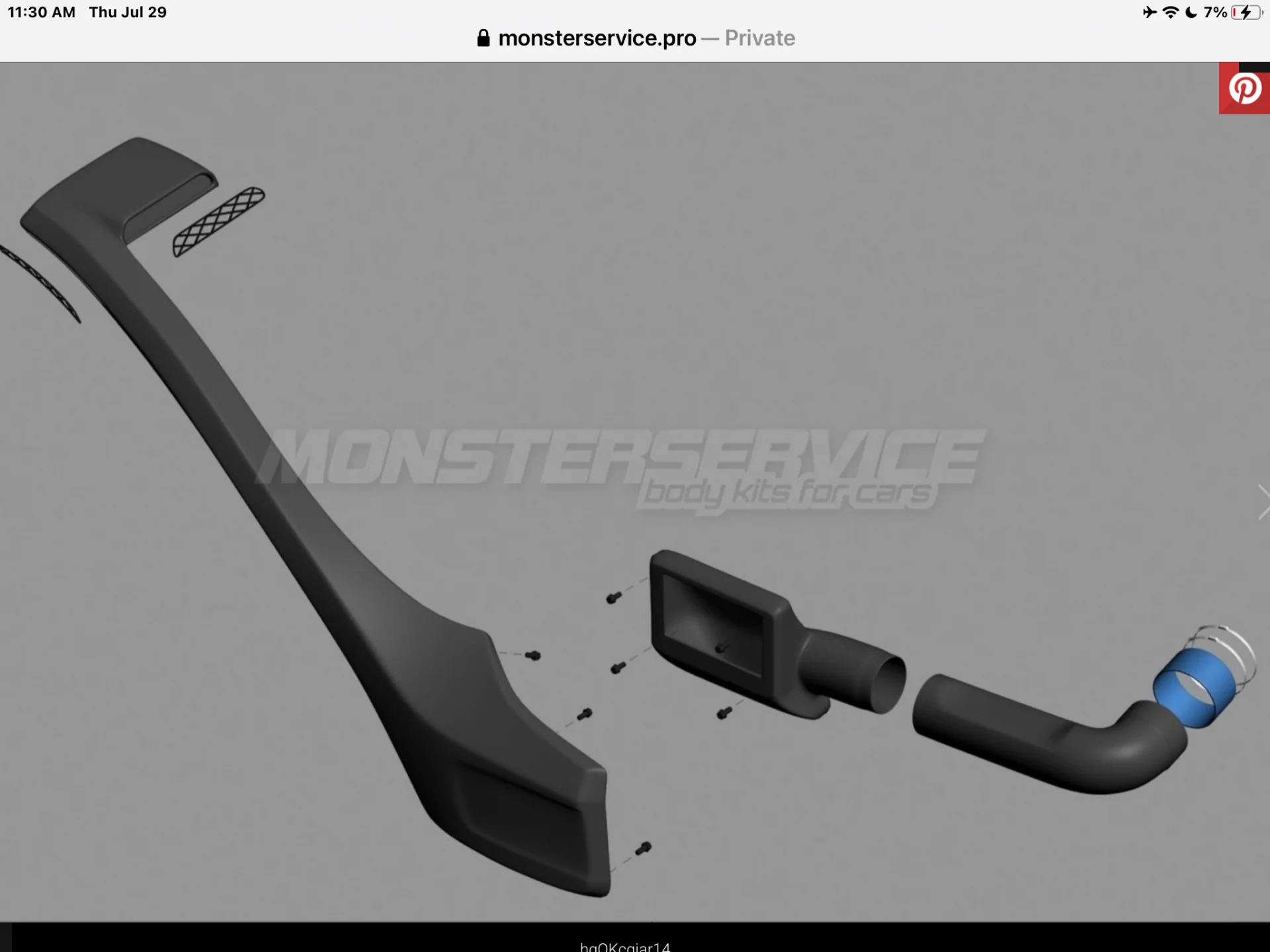

for my ride. Has anyone heard of “monster service” and their aerodynamic snorkel for the 200?
I was eyeing this one too. Looks fantastic, best one I’ve seen. Nice and low profile. I Ended up going with the tried and true Safari airmax Snorkel.
The extra plumbing in that image makes me wonder how it connects to The factory air box. Looks like the tubing would run along the inside of the fender and then connect to the OEM air box with the blue gasket. Looks like a PIA to install lol.

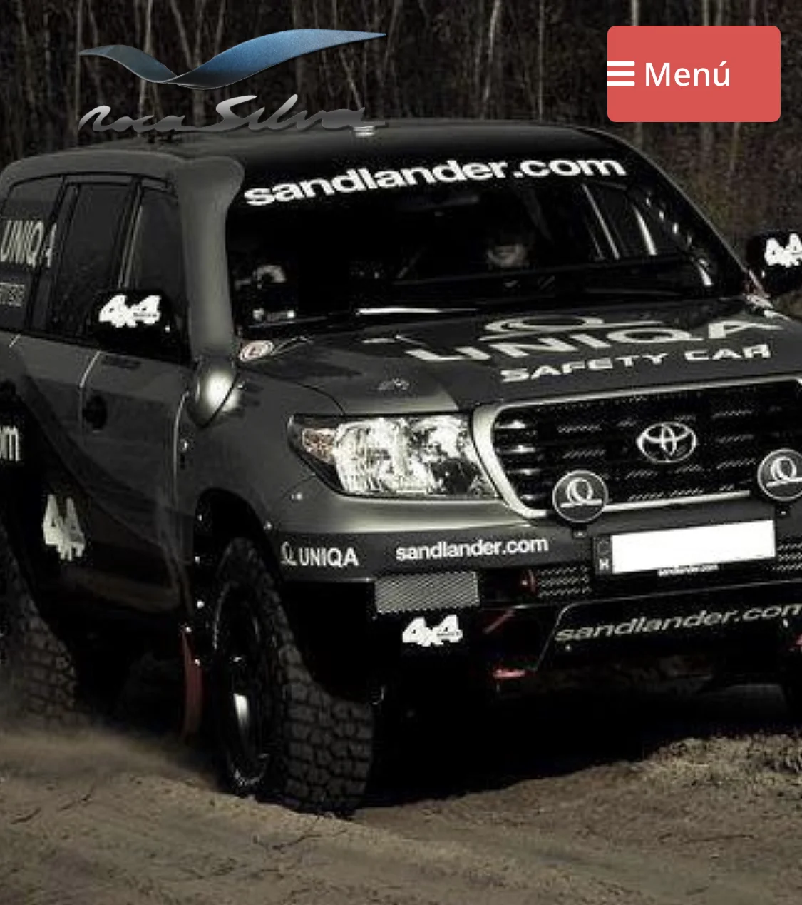

I looked into these a few years ago… (Roca Silva) but they weren’t ready for the US market. Italian…

In the case of the Italian unit, their answer had to do with some sort of legal issue with export…but there was a string language barrier going on, so I’m not sure.

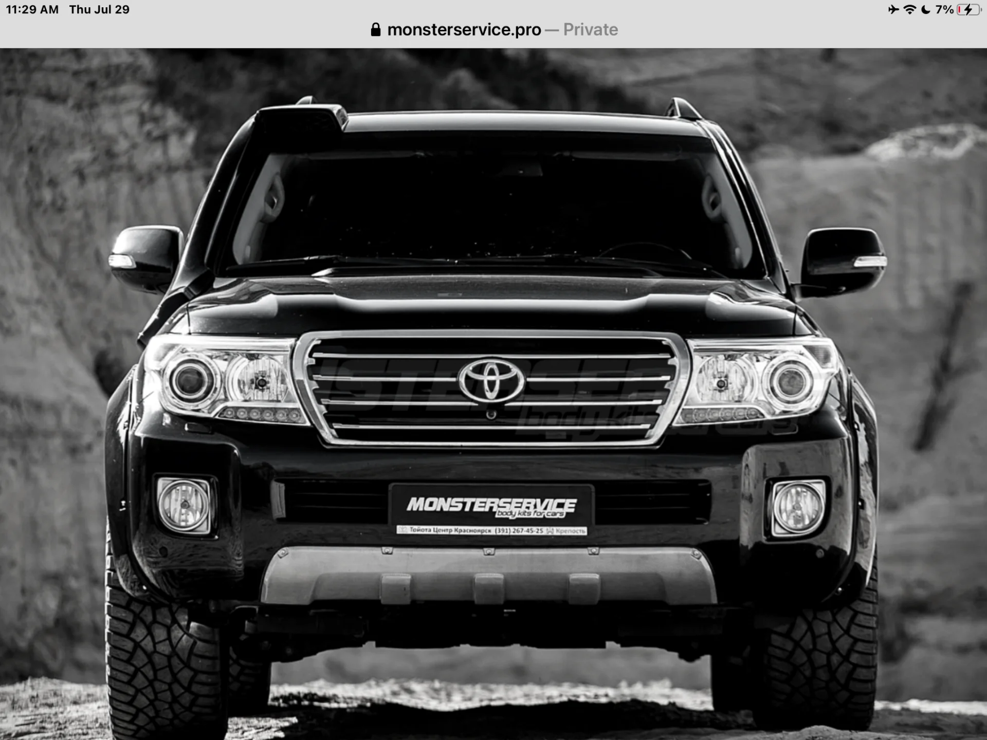

I like the look of that MonsterService snorkel but I am not sure how I feel about it being made of fiber glass. I know the Safari and TJM plastics are tough as nails as I pushed/snagged/snapped many many branches with both of them and they shrugged it off.

I emailed MonsterService and asked a couple questions. Its a Russian company. They replied right away and said that they have sold several of their 200 series snorkels to U.S. customers. I gotta think anyone with a 200, that adds a snorkel and buys it from some startup company in Russia, has a good chance of being on Mud. So talk to us MonsterService Snorkel users! Need feedback.
