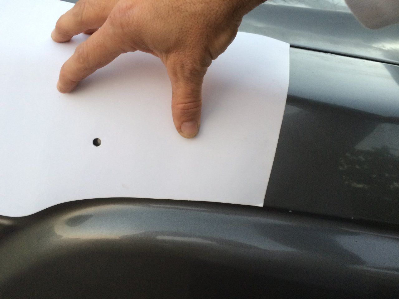

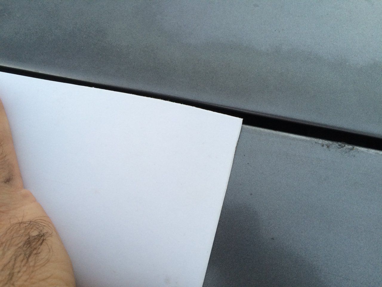

A couple of days back I purchased a snorkel of my hj61 from RVTEK for about $74aud. It arrived today and looks great - however the template only has 3 hole markings on it which appear to be for the 3 mounting bolts, and the position for the 95mm hole is missing.... It would be greatly appreciated if someone could give me a few measurements from their template (ie - top corner of template to hole, bottom corner to hole, distance from last hole centre to centre of 9m hole etc....) hopefully in mm!! Also, should the bottom edge of the template line up with the crease in the guard, or the top edge of the template line up with the top folded edge of the guard?? This may adjust the final position of the snorkel by up to 10mm.... Here are a few photos! Thanks heaps Drew

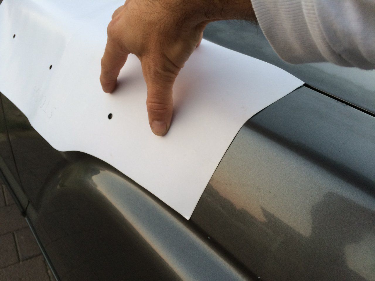

I had the same, a lot of my pictures here with the measurements:
hj60.freeforums.org • View topic - Snorkel
Mine is flush with the hood and could be a bit lower.
If you lower it please make the same pictures to have this measurement question covered forever!

No measurements, I dipped the small thread in paint and drilled that mark, I am very bad in measuring and making stuff right.

The most left (holding my hands in an L shape to see what is left :oops:) small thread touches the water drain so don't use that one, impossible to get to that one!
