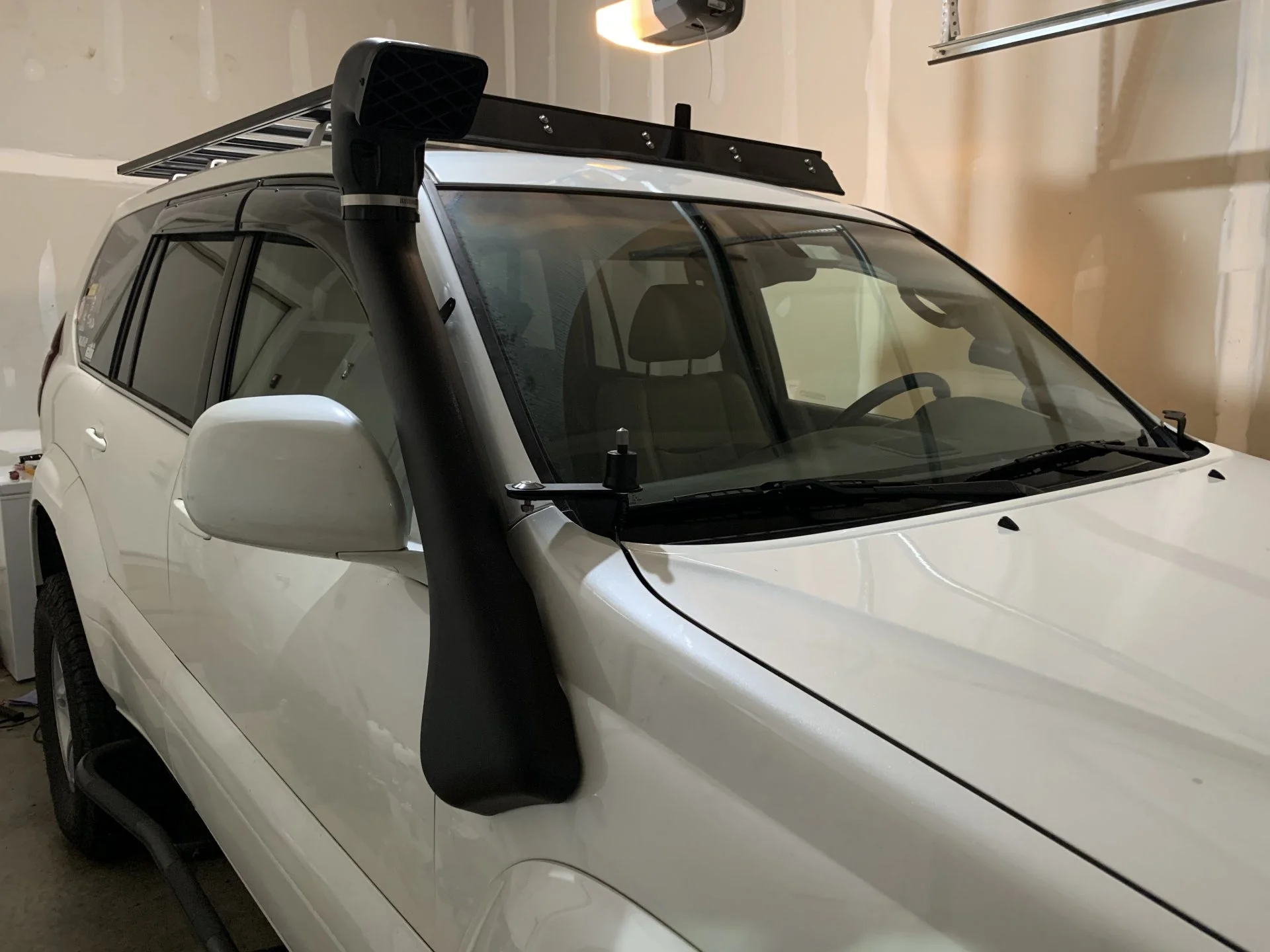

Hey just an update on the Lenz Design snorkel; I didn’t have any quality issues whatsoever and it was painted to match in Blizzard white (paint was a bit off but what can you expect with a pearl paint I guess) but it did take awhile for shipment and I did use the autozone coupler to seal to the air box better. Don’t forget to seal the holes at the bottom of the air box for a fully airtight seal. The only reason I’m chiming in here is because I just found out from the windshield repair guy that the snorkel will need to be removed when needing to replace the windshield. Apparently the rubber windshield gasket goes up the rain gutter all the way up to the roof rack pillar and goes under where the snorkel inlet rides at the top of the windshield. Just an FYI if you live in an area where windshield replacement is common...

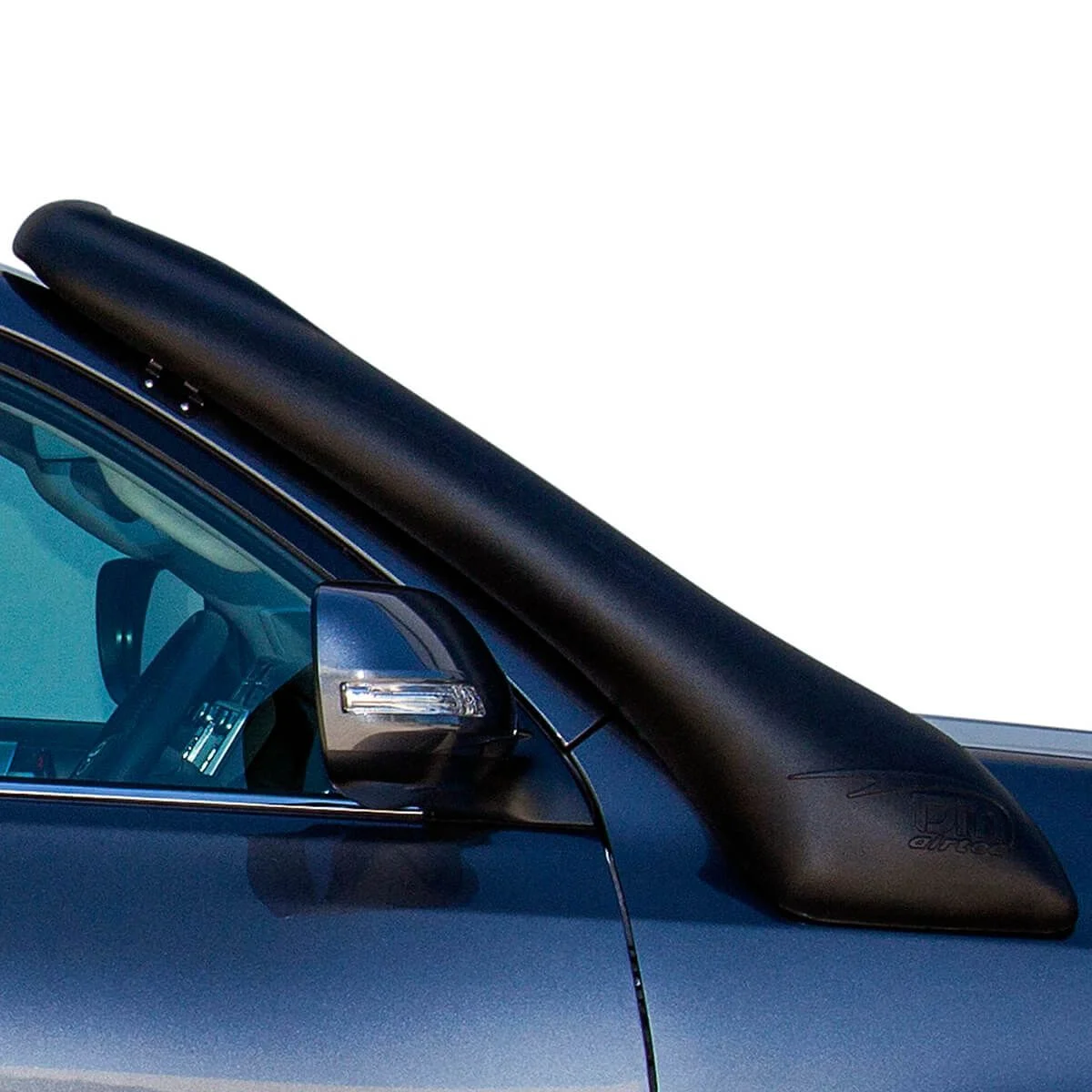

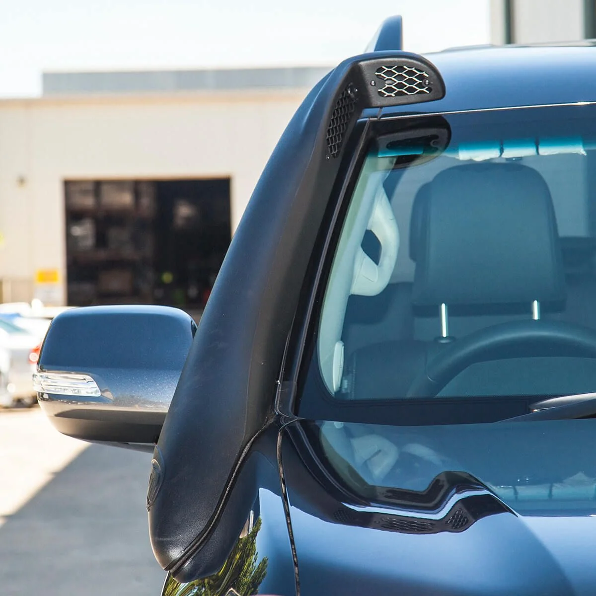

Anyone hear of a TJM Airtec style snorkel coming out for the 470? Looks like they offer one for the 460 and 5th gen 4Runners, but nothing for the 470/Prado 120. Definitely not a sleek as the Lenz, but a similar design that is still more low profile than a traditional snorkel.

ship has probably sailed given its a 10+ yr old vehicle and arb already makes one.
I’ve seen write ups on mounting a similar style snorkel from a 100 series to a 4th gen 4Runner. Would probably not be much different for a 470. The only issue is the complete lack of clearance where those style snorkels mount on a 470. It’s insanely tight and probably why ARB went with a traditional design extending further along the flare.
I used a 1st gen Taco snorkel and wouldnt recommend it to anyone with the level of difficulty it was to retrofit.

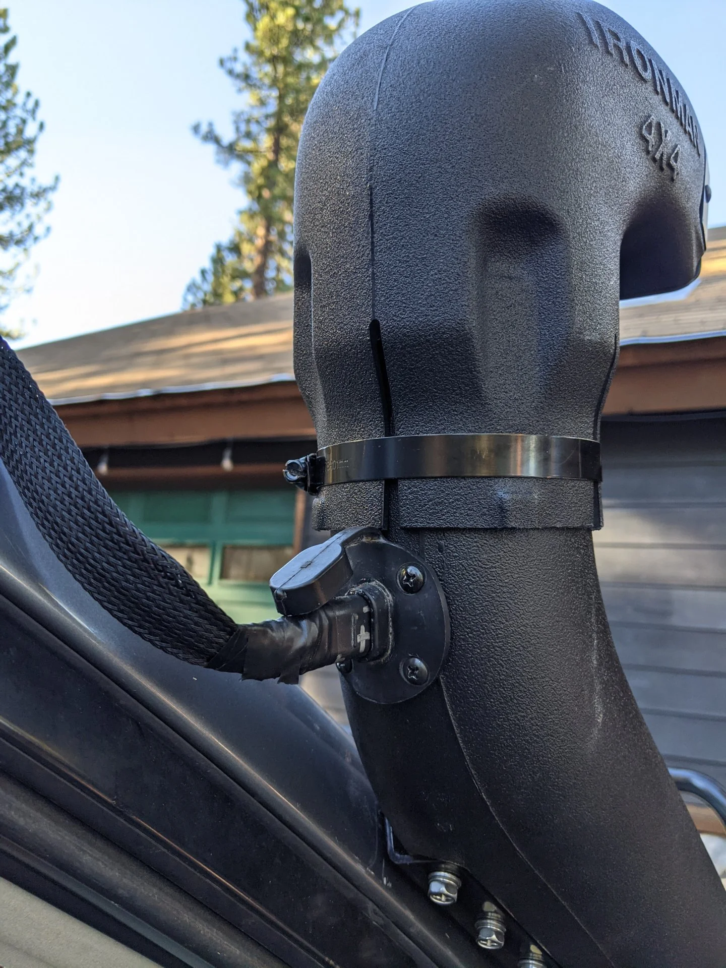

Just finished mine.
Again: double check your template. Its close but I had to enlarge the bolt holes with a burr.
Also, I used a 3 3/4" holesaw. If I did it again I'd buy a 4" holesaw the extra 1/8" of wiggle room would help.
I got fancy and ran my solar wiring through the snorkel... That would have been much easier before mounting the snorkel to the fender. I like the end result pretty well.
