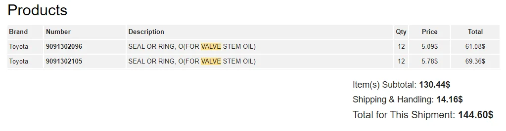

I just purchased the OEM seals from PartSouq, they weren't too bad:

@dirtrick said "My local Toyota dealer just quoted me over 600 bucks for valve guide seals"
Sounds like a mistake or a very high mark-up over Toyota Retail (which some dealers do, in my area it's now ~20% mark-up)
Example (1FZFE):
Toyota retail pricing for (Valve Stem Oil) Seals
Intake: 90913-02096 $13.25ea x 12 =$159
Exhaust: 90913-02105 $16.52ea x 12 = $198
Total for 24 Seals: $198+$159 = $357 Retail pricing
There are many sources for discounted parts.
Could your dealer have given you a price for Valve stem guides (bushings)??
Valve stem bushings (guides): 11123-66020 (Exhaust) and 11122-66020 (Intake) are ~$21ea x 24 + ~$500 (add 20% mark-up = $600)
To help avoid ordering mistakes IME it helps to find the correct part number first then go into your local dealer (or vendor) and politely give them the number (they can/should cross-check it of course).
FWIW

I thought it was a mistake but narrowed it down as much as I could without making him feel insulted. I won't be going with them in this case. Thanks for the info
I've never ordered from Toyotapartsdeal but you can use their website to help find part numbers and get an idea of what other
discount companies charge. Partsouq (see above) or Amayama have good prices on many parts so helps to shop around. Oriseman Toyota in the US (Virginia) still gives a good discount but there may be other Toyota dealers closer to you that have an online store.
Cruiserteq (cruiseroutfitters) is over your way and carries OEM and quality Japan made parts.
