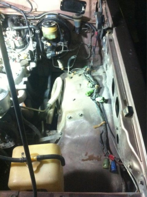

Here's a pic of my drivers fender. Check out all the empty plugs. Granted, I don't have a carb anymore, but that is almost exactly what it will look like.
I dove in headfirst into my desmog. Had a header sitting in the garage. 60 has ran like crap for years which was the biggest reason I let it set for so long. Decided it was do or die. Everything is removed now. Figured I would get started then figure out the details along the way. I've read the desmog thread many times, but until I can get my hands on things, I'll never understand it. Got my idler pulley from JimC along with the cap kit. $124 total. I did not get the EGR block off plate as I'm going to modify the existing to keep the hose going to PCV. The EGR plate is $35 I think. I've had an oil pan gasket sitting around for a while and when I saw how much room I had to work with the exhaust out of the way, figured it was perfect timing.
