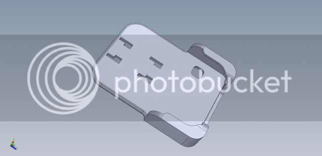

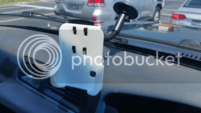

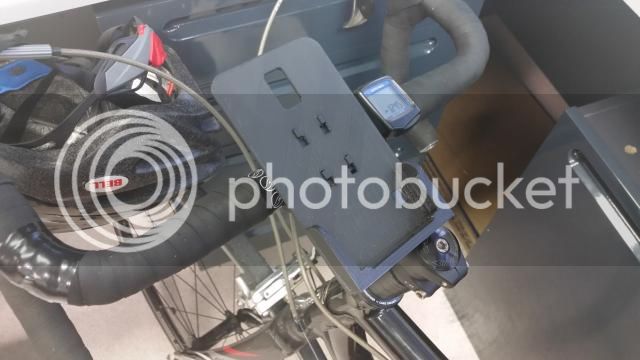

Thats a good idea. I love the snap-in phone holders that you can buy but unfortunately they dont work with aftermarket cases. So I designed and 3d printed my own. It just clips on to practically any of these flexible suction cup arms.
The problem with makerbot is that most will only print PLA and that deforms quite badly over about 40 degrees Celsius, so i had to print this in ABS which is good for well over 100*C

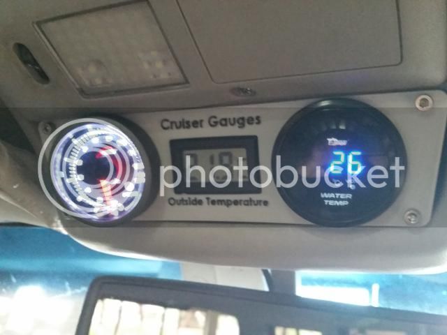

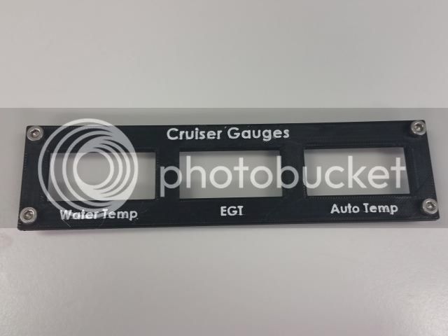

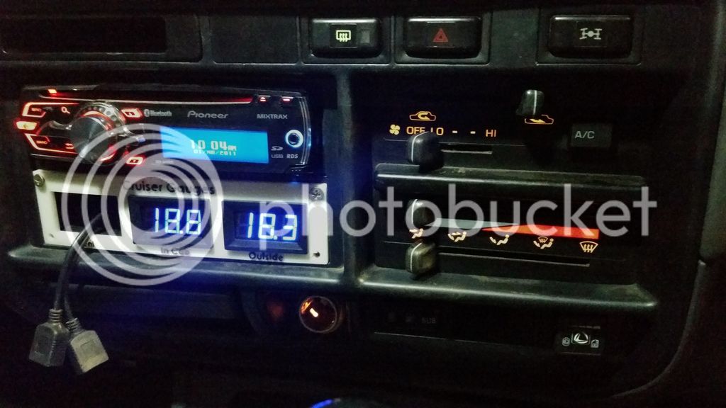

I have also 3d printed some extra gauge holders for the overhead console and under the radio:
Yes I know there are multiple outside temp gauges but I have been experimenting with different ideas :-)
It is indeed hard to find holders that for aftermarket cases. What case/phone did you design yours around?
