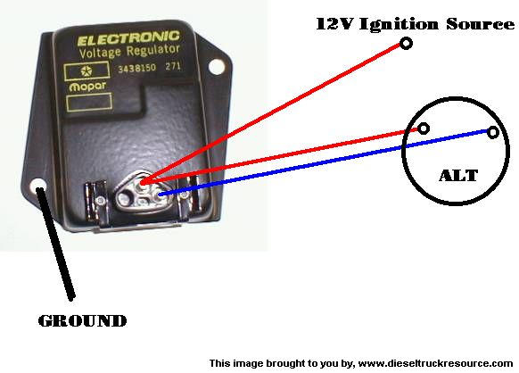

Not sure how this might help anyone here, but it turns out that the Denso alt's used on 12valve Cummins engines have their voltage regulator in the PCM. In other words those alternators are already externally regulated. Just had a look at mine and it does have two small studs on the back with wires connected to them.
Apparently these regulators are prone to failure and to stay stock requires a whole new or rebuilt PCM, which needs/should be programmed to the truck's VIN & mileage ($$$). Below is the suggested wiring diagram to use the earlier Chrysler external voltage regulator (<$20).
http://www.dieseltruckresource.com/pics/data/500/17307regulator2.jpg
Why am I posting all of this? The OE 120Amp alternator looks like this (note the black block with the two studs in it):
Which I suspect makes it a possibility for a swap onto a 2F or 3FE? I don't have one any more and haven't for quite a while, so I can't go look at at it to see. That is vaguely what I recall it looking like. I think that an alt. rated stock at 120A would be a significant improvement over anything in a 60 series and maybe even in an 80 series. BTW, Rock Auto lists the CTD replacement alt currently at between $90 and $120 depending on brand, etc.
My route fwd on the CTD is to budget for an NS2 regulator, but hopefully what I've dug up will help someone else with a stock engine looking for more alternator capacity. The CS-130 on the FJ60's TPI engine is going to take a little more thinking and research...
EDIT: Re-reading Spork's post above has me really interested in seeing a pic of the alternator that he has. I'm wondering if it is the CTD alt or not.
EDIT II: Looks like specifying the alt for a '98 instead of my '96 CTD will get you a 136A alternator that very possibly is a bolt-on replacement. I'm not going to change mine for only 16A, but if a guy is starting from scratch.....
