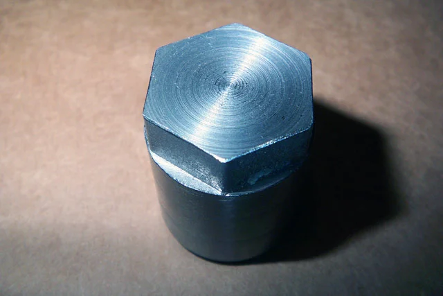

Can you shoot a pic of the back side of the custom nut?
Dan, here's a picture
Stu
Thanks.
Typical Bill over the top stuff.
I would expect no less.

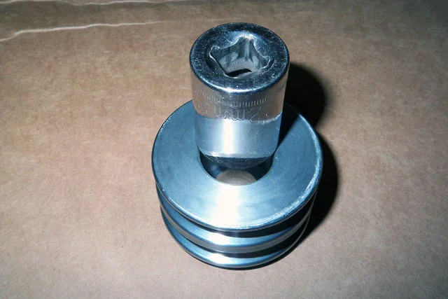

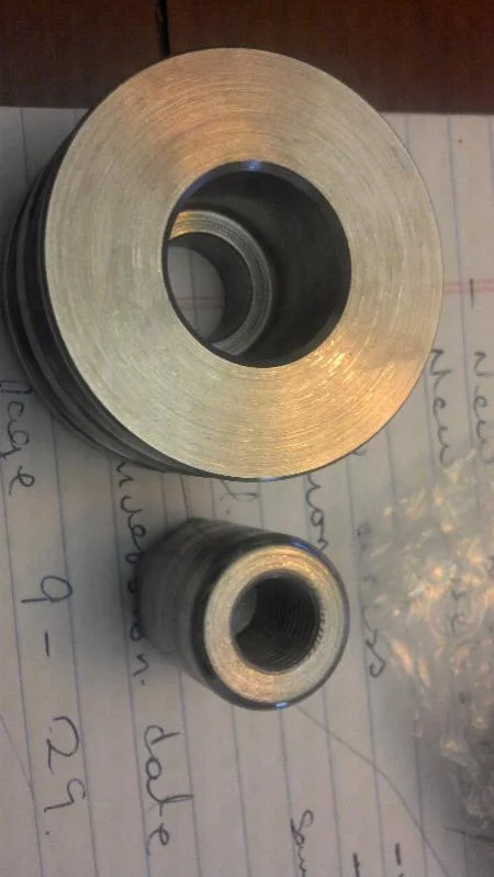

If I may explain how this transpired. The process was I first made the hole for the nut in the pulley big enough for the stock nut. The problem was not the nut; it was making the hole big enough for a socket to tighten the nut. If I did this then there was not much metal left between the pulley groove and the hole for the nut. I found some lug nuts in the correct thread but after thinking about it I figured I would just make a nut with the same 22mm head as the stock nut and could then make the hole smaller and leave more thickness in the pulley metal. Also it was buzz the 22mm stock nut off and buzz the new nut on with the same socket.
Since Stu posted those pictures I will just post some others.
Bill
Read (f) To torque pulley nut..... 81 ft·lbf.
So with the new improved nut covering up the shaft, how does one go about getting to the requisite 81 ft-lb since using an SST or vice is not possible?

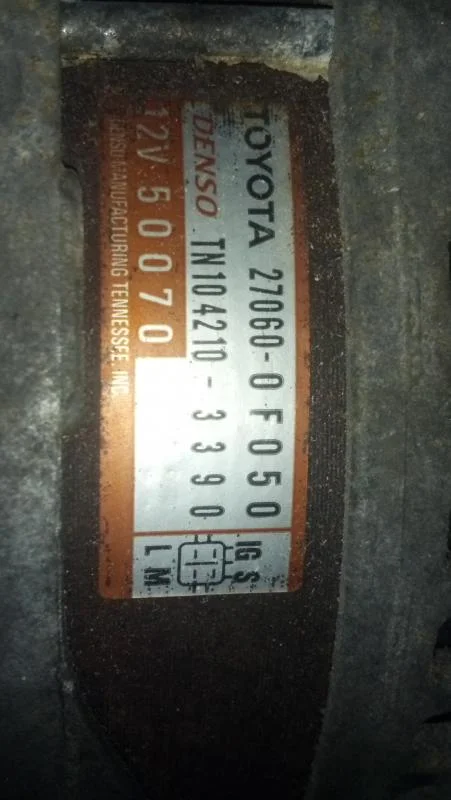

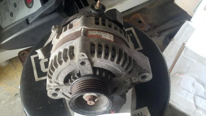

So this little gem showed up today. It came out of a 2006 Seq w 96K miles. Good to see the wiring dia on the label. :grinpimp:
I am going to have it tested before install..
So how hard is it to do the the brushes?? Is there any other PM I should do before the install.

Torque stick on the rattle gun.
Bill
Edit: typical torque stick link
Cool tool! Didn't know they existed, but one for me is on order now. And 80 ft/lbs is close enough in my book to the 76 ft/lbs spec'ed for wheel lug nuts that it can be used for that application too.
