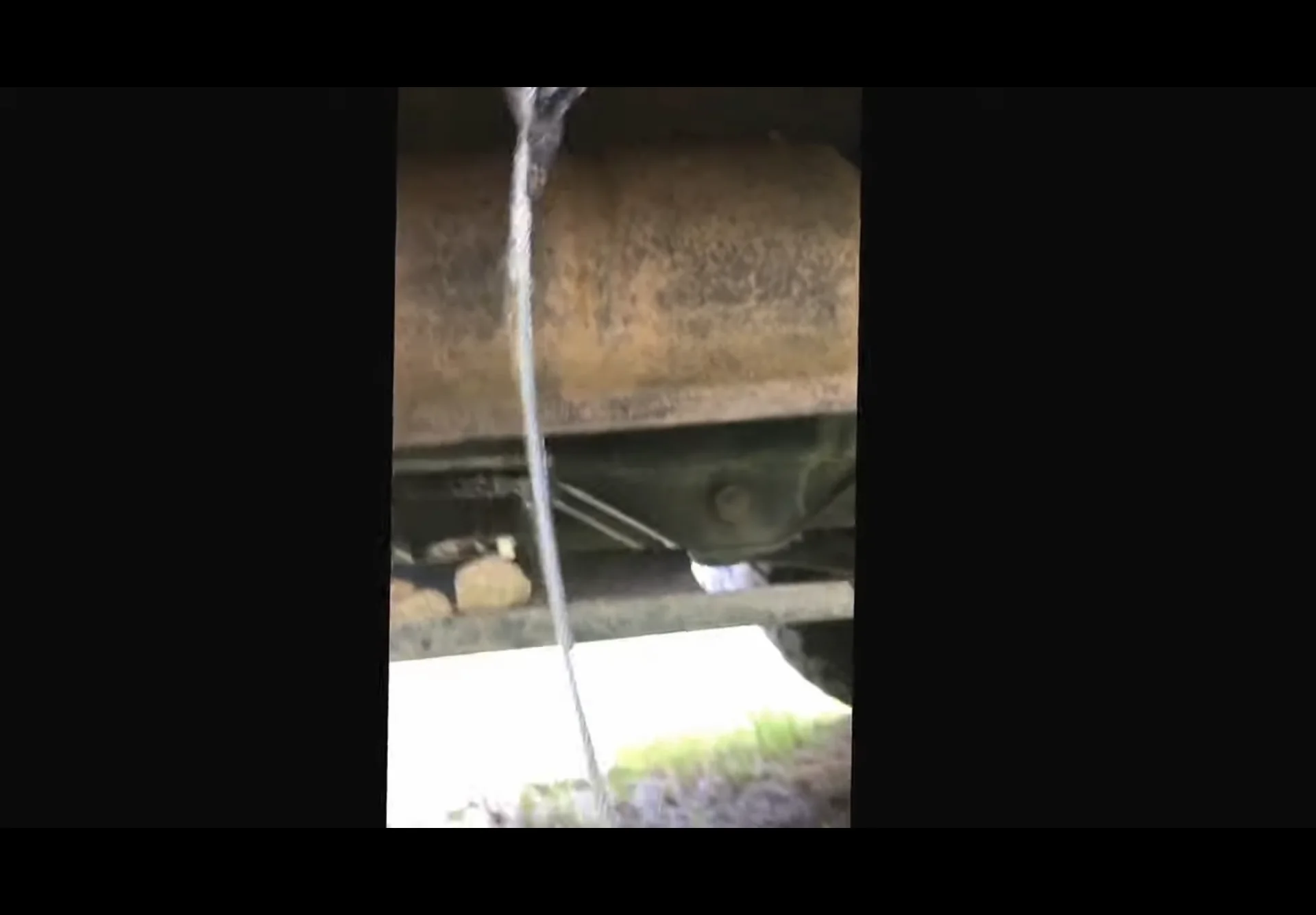

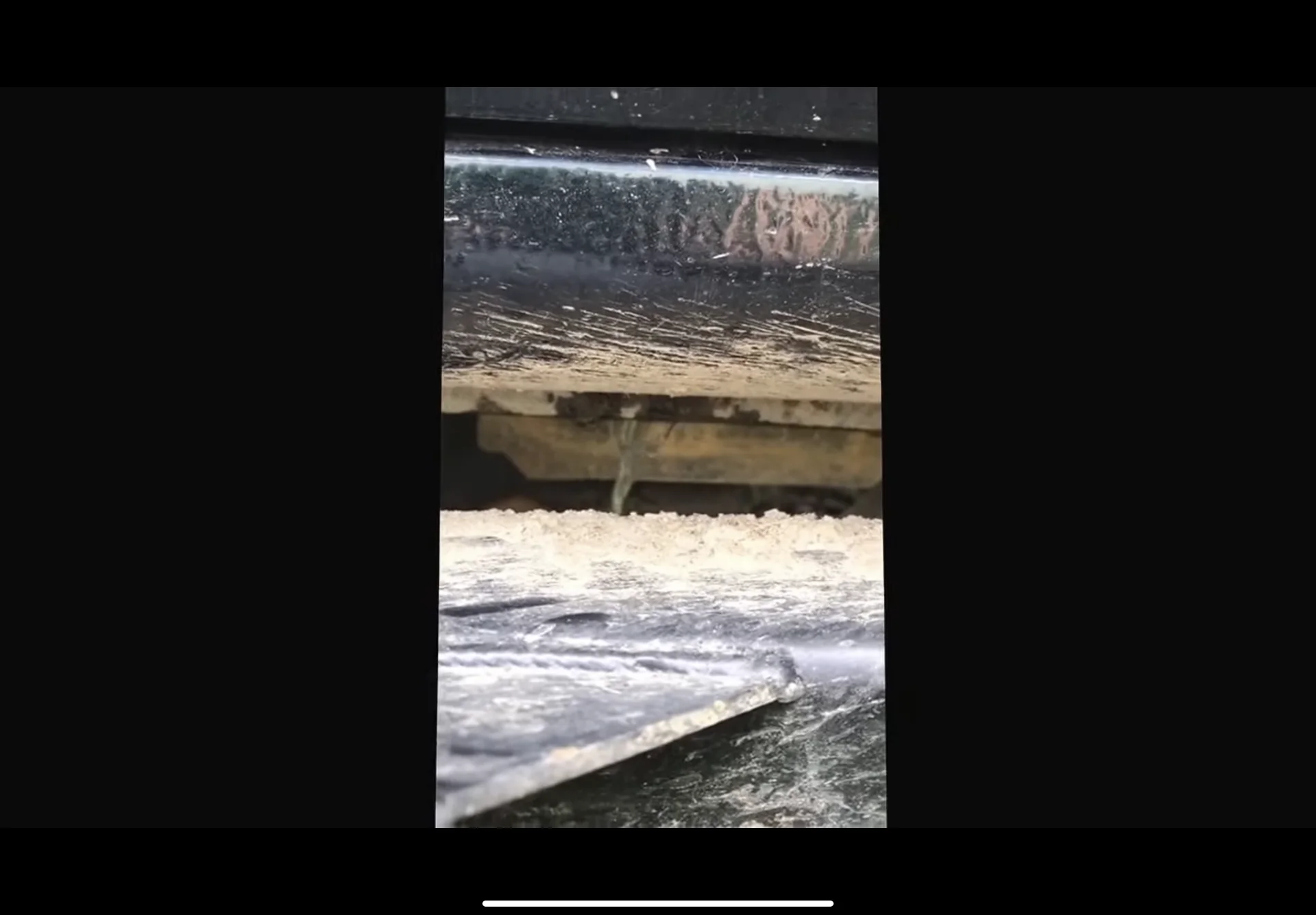

You have 2 of these slits per side on the folded/welded seam. If they are closed or muddy, you will get that sloshing. A small flat head screwdriver is all you need to reopen, or some like this wire cable to go in and get the clog off and water draining
video won’t play here, but a couple of pics
I found them yesterday after some fighting around the sliders....if those aren't on the truck, they're clear as can be. Will try to get a couple of pics and post them for reference. It's a slight opening in the pinch weld front and rear on the rocker panels each side - easily missed if they're caked full of debris like mine were.
Excellent, fixed the video, after driving in some deep mud it can get a lot of water in there if you dont get them open
