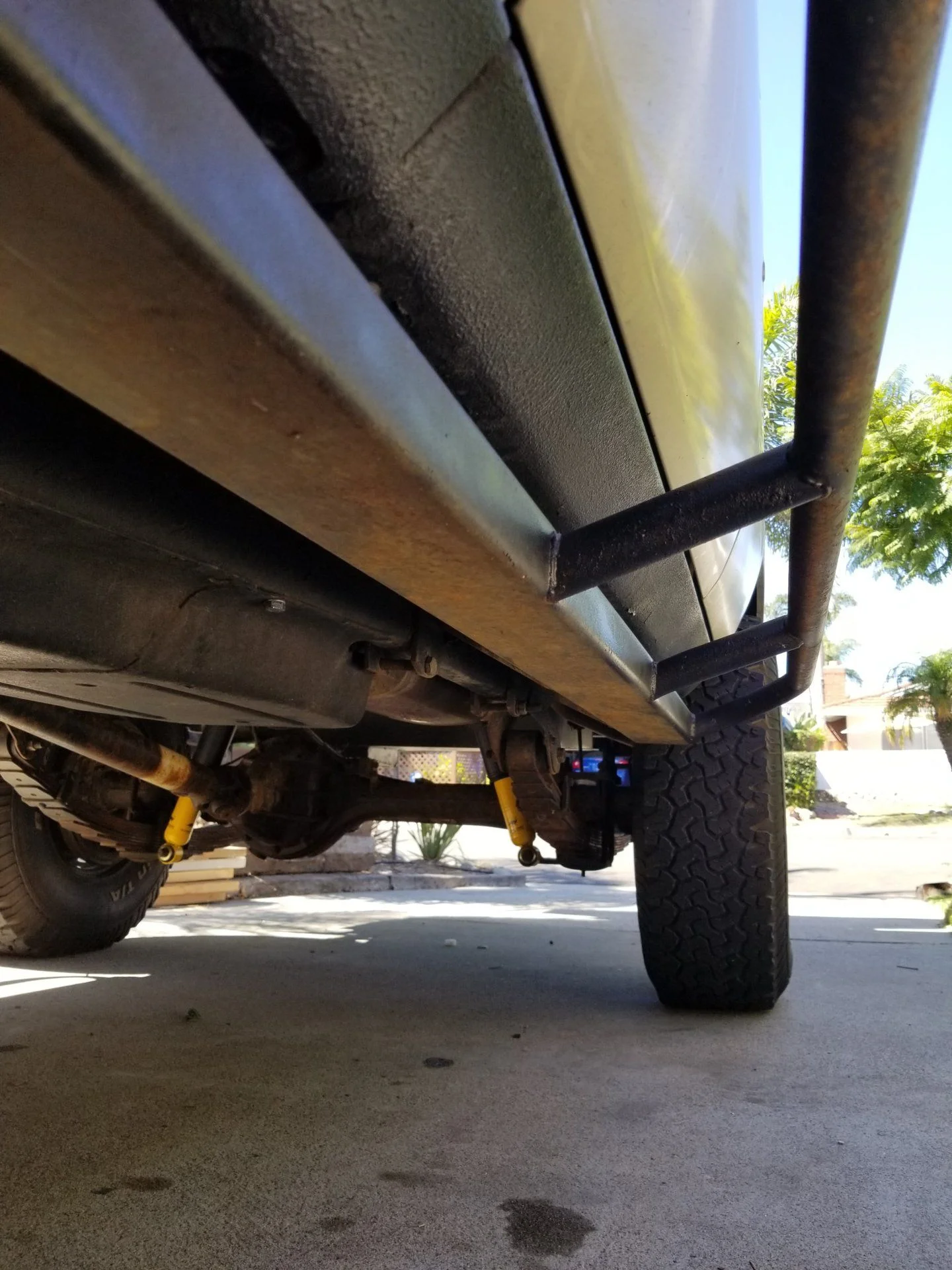

I know how to drill and tap the holes to insert a quick disconnect for a Compressor hose for filling the sliders with an air Compressor.
What I need and want is the ability to also fill the sliders with a common gas station air hose used for filling tires.

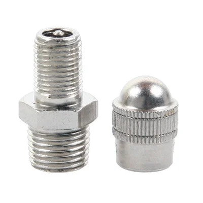

What type of steel valve stem or set up should I use to screw directly into the slider?
Schraeder valve
schrader valve - Google Search:

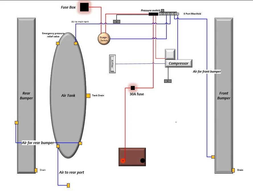

I have to say that unless you have sliders that wrap completely around your vehicle, you likely won’t have enough volume for filling tires. Something like a Powertank works because it is at 1000psi. A 4’ long piece of 2” tube is only going to have 0.09 cubic feet of space in it. I’ve seen people use sliders, bumpers, and such for air tanks connected to a compressor for some additional storage, but for filling tires the volume required quickly is dependent on the compressor itself.

Pressurized tanks have to be inspected annually to ensure there's enough material to hold the pressure. If you're only going to use a 100psi compressor, it (probably) won't ever be a problem, but you'll never see inside a slider which was designed to be a slider and has been converted to a pressure tank.
Those welds probably aren't/won't stay airtight. And if you hit anything, you'll stress the welds beyond their strength to hold the air, and never know it, until it fails.
Buy a tank. There are times when you should consider purpose built equipment. This is one of them.
Just my 2¢; it's worth what you paid for it ;)

Thanks for you're input, as it's greatly appreciated as was everyone else's.
That said and taking everyones wisdom on a forum which Ive held in high regard since 2004, I've s*** canned the idea.
I'll be buying a power tank 15 very soon
