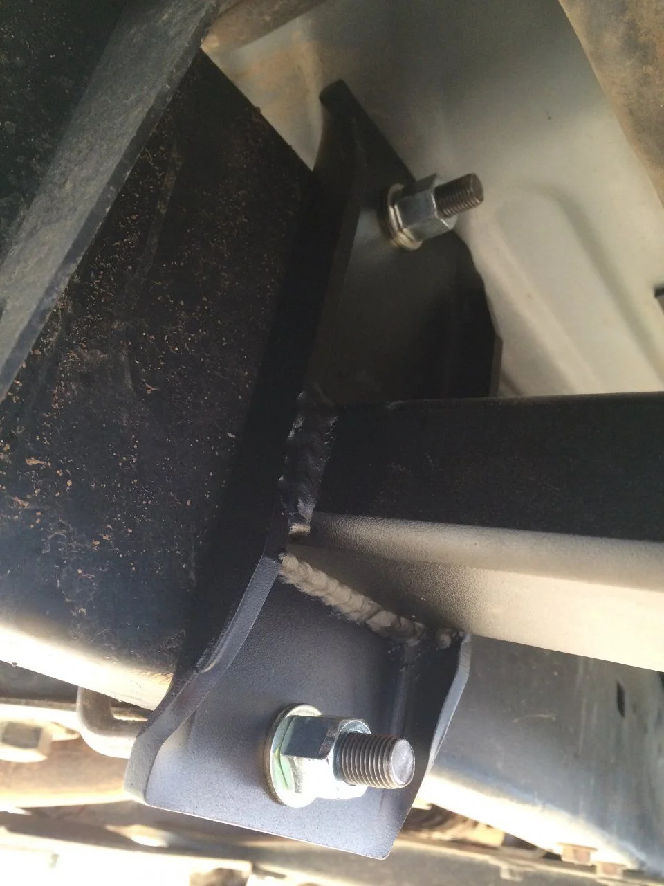

Anyone familiar with the Metal Tech sliders?
Will the box for the exhaust get around the flex pipe that's on my BJ74?
It seems a little out of whack to me, but I have no comparisons.
You can see the exhaust in these pics.

Mine has very little clearance and would rattle when I cut the engine off or on cold startup. The drop is right under the flange. I fixed the rattle by gluing a piece of high temp diamond plate rubber on the flat between the exhaust and the leg. I still get a thump out of it every now and then but otherwise all is good.
See pics in post 227 and 228 here. https://forum.ih8mud.com/threads/19...er-new-management.823346/page-12#post-9617644
Thanks for the reply and pics/link Elk. The rubber is glued to the slider mount?
I did not know that the flex pipe was a standard part. From Parts catalog I could not tell.
Good information for me to have.

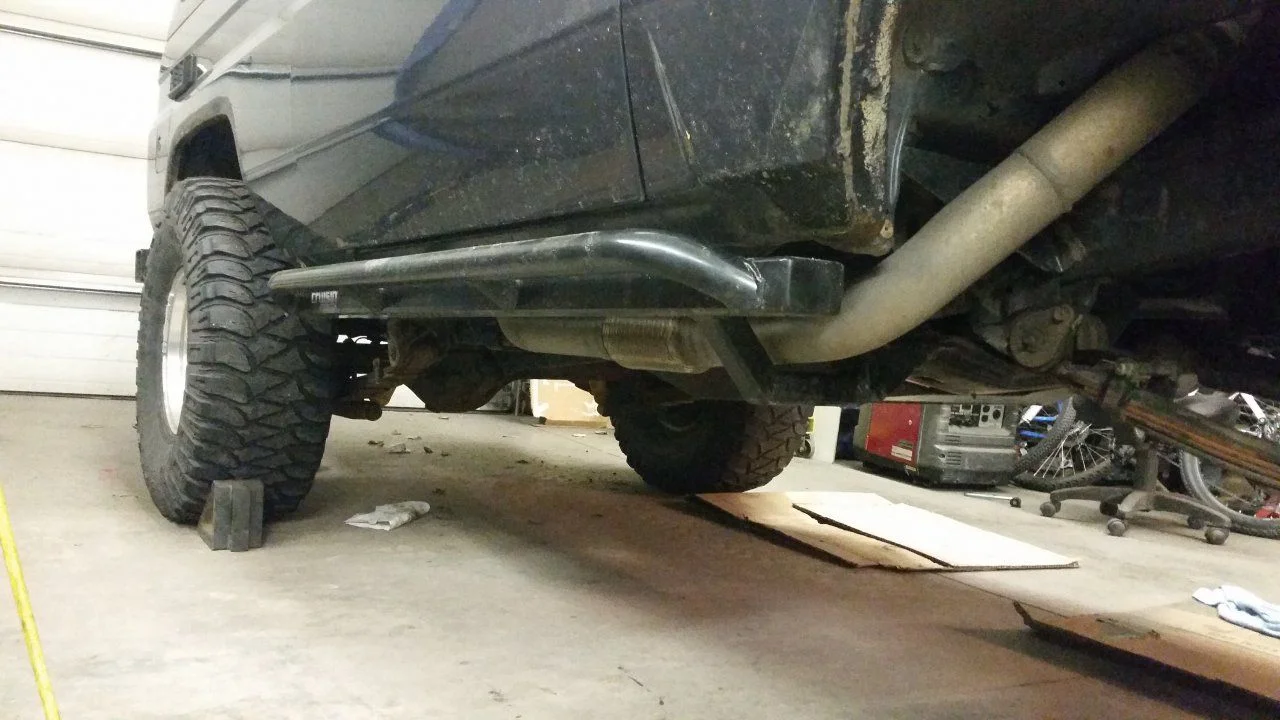

My sliders are from Cruisin OffRoad but same basic idea. When I ordered them I just supplied Jason with the measurement of how far my 3" exhaust hung down and he altered the mount to fit. I will eventually add another similar mount / guard farther back to help protect the exhqust

Yes. I used high temp spray adhesive.
The @Cruisin' off road sliders have a really really nice attachment system and will be built to wrap around the exhaust as mentioned above.

If you're doing serious wheeling, the large lip that protrudes ~1.5" below the frame on the MT sliders are a problem, they get caught on rocks:

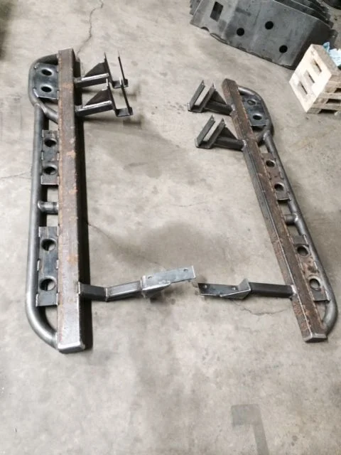

Here are the sliders Jason just built for my 74:
How much of a modification is it to re-route the exhaust inboard?
the only problem with inside the rails is if you have the vac diaphragm on the on the transfer case. From memory i dont think you have that do you Hulsty?
