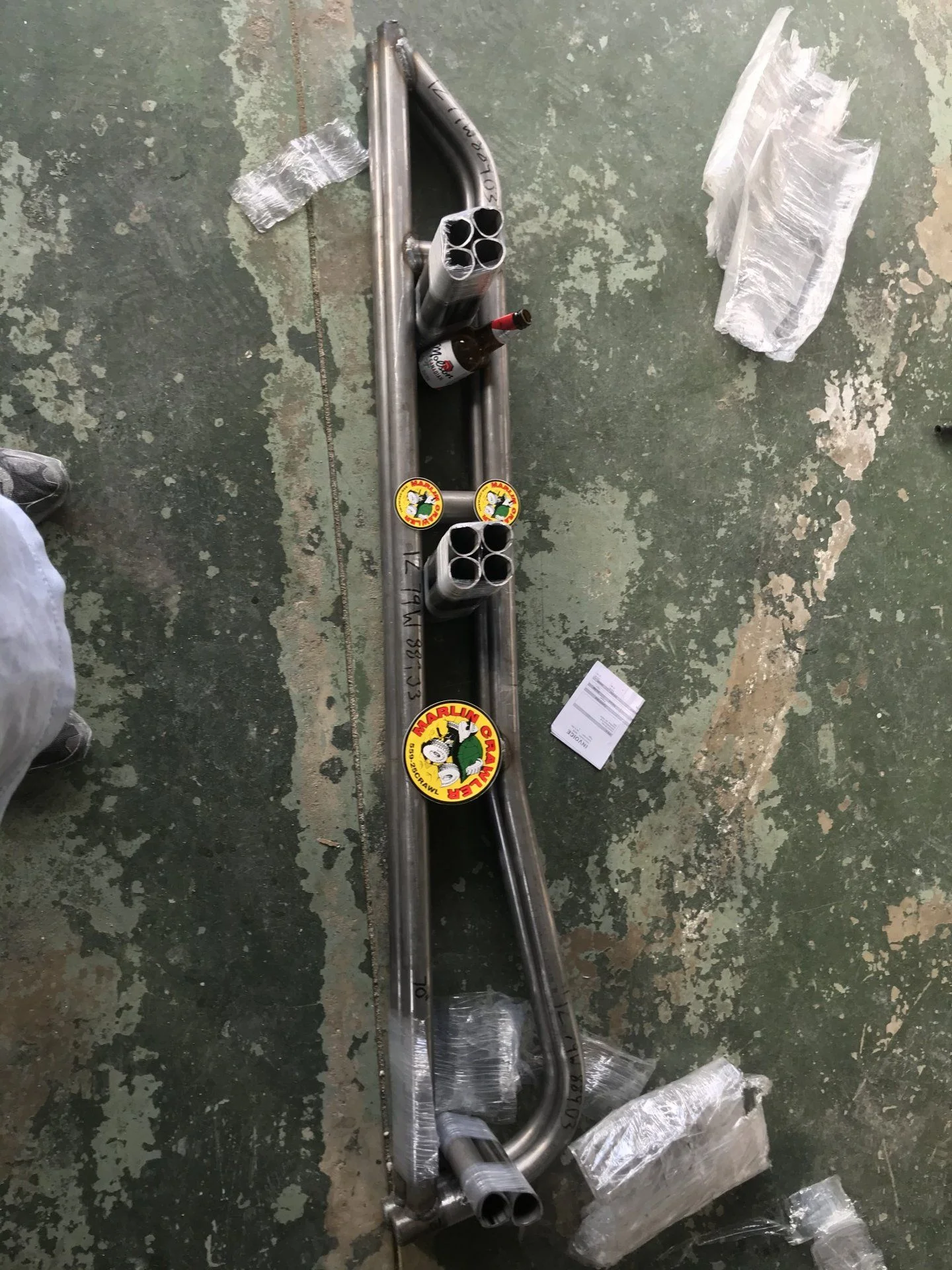

These arrived today, hoping to use all 5 legs per side, about tree fitty w/ shipping. I asked for stickers when I placed my order and they hooked me up. I bought this set for the stickers....🤓
Edit: I’d like to add that from purchase to delivery was about ten days.

Yeah, if you can weld at all, get the Marlin crawler 70-inchers.

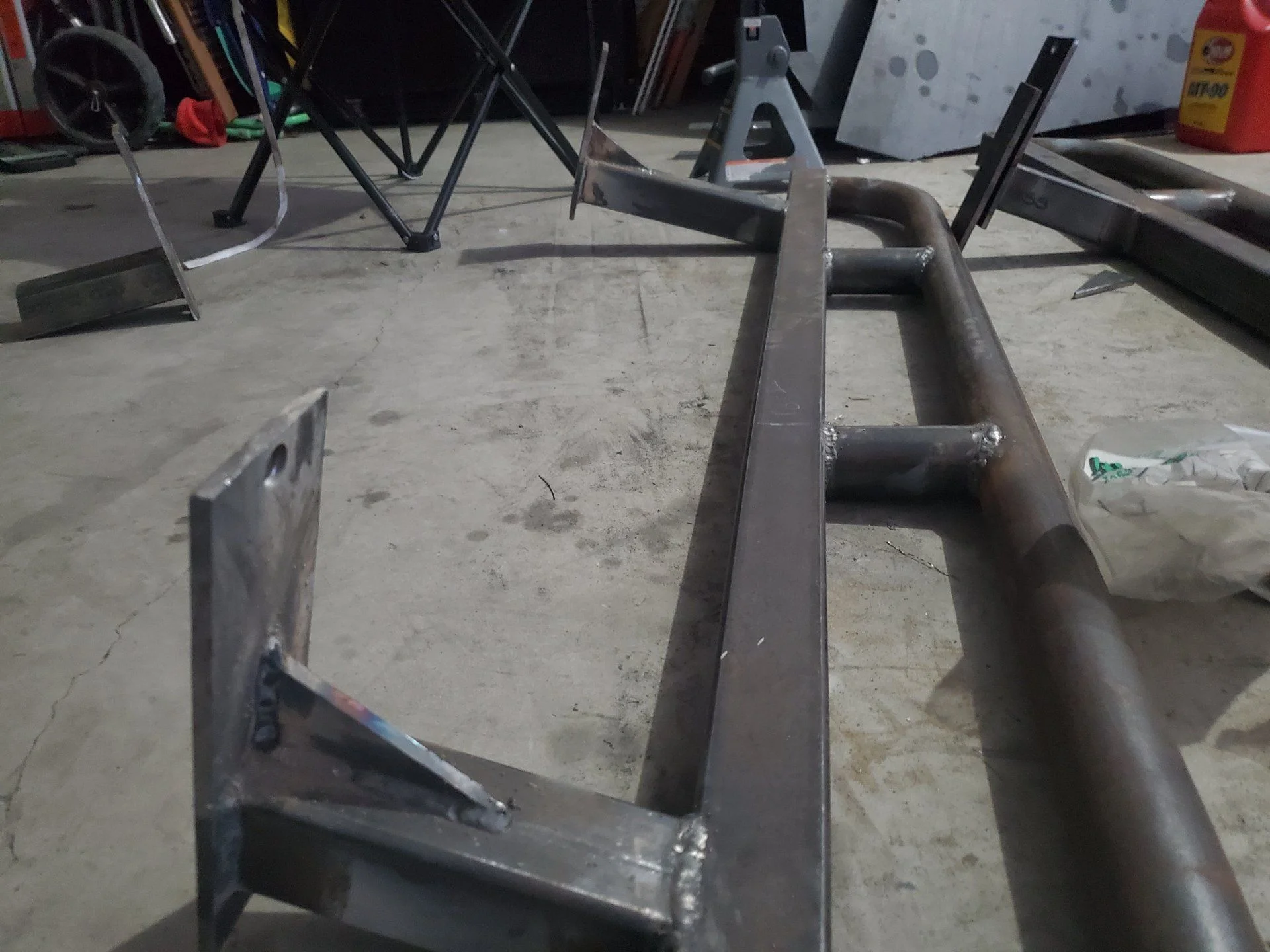

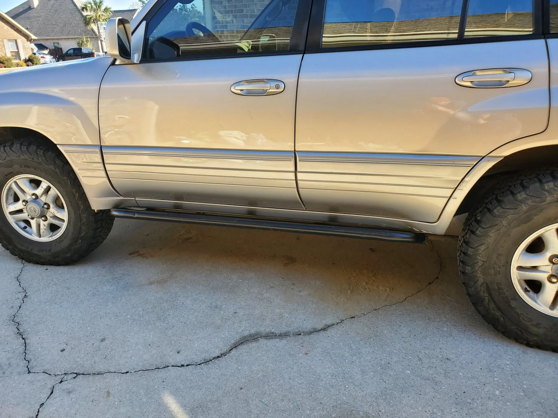

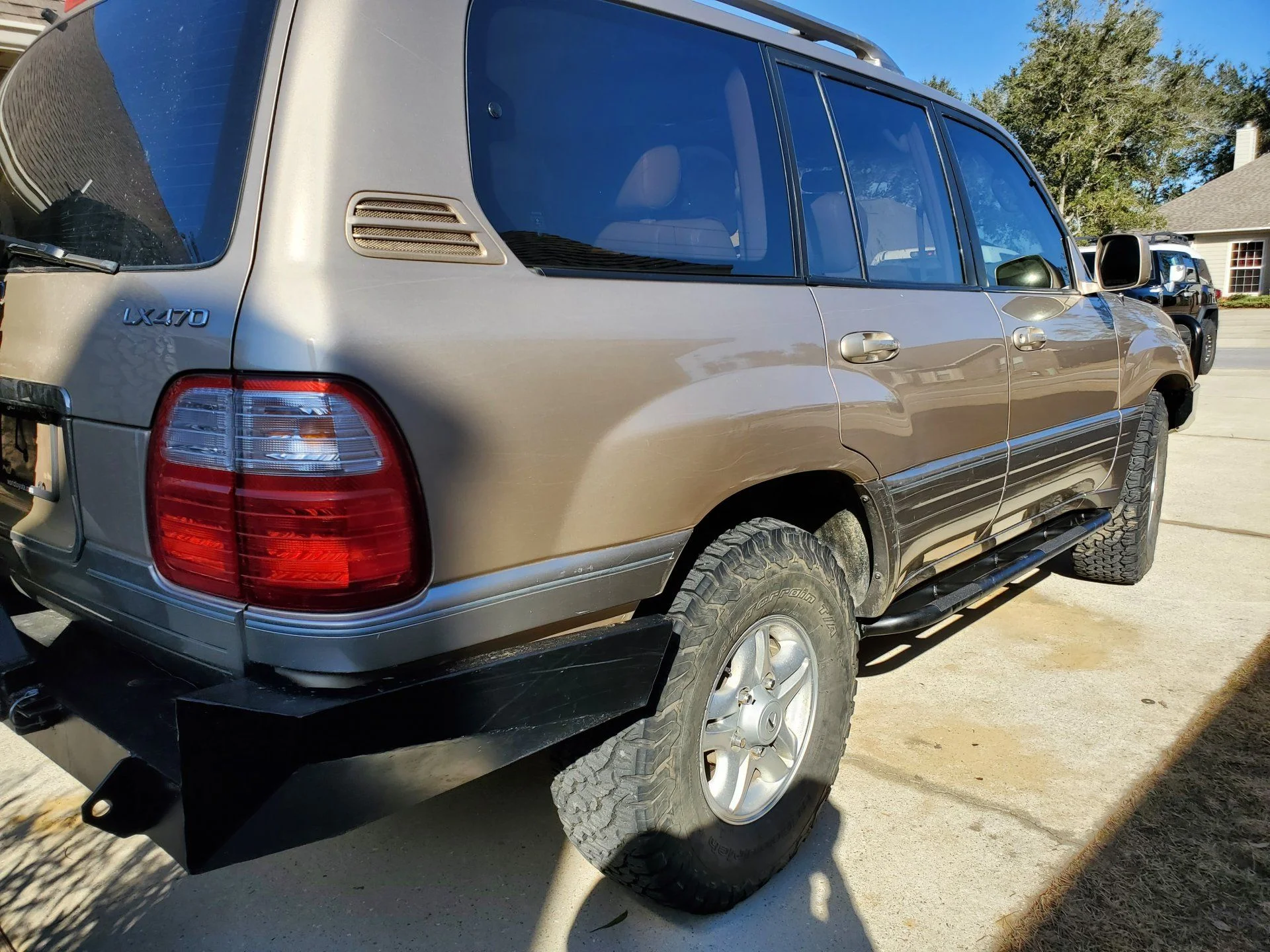

I just made some for about $60 with stuff I had laying around. They are only 69" long though 70 or 71 would be perfect.
I'll probably make another set when I get some more material. I used 1/4" for the mounting plates and half inch grade 8 bolts.
They look good, but as you said a tad short. How long did it take you to make em?
Probably 24 to 30 hours total. Working like 3 to 4 hours per night when the kids went to sleep.
Most of it was spent figuring out the pipe bender and laying out mount locations. A lot of tacking, then fitting on the truck, pulling back off ..repeat

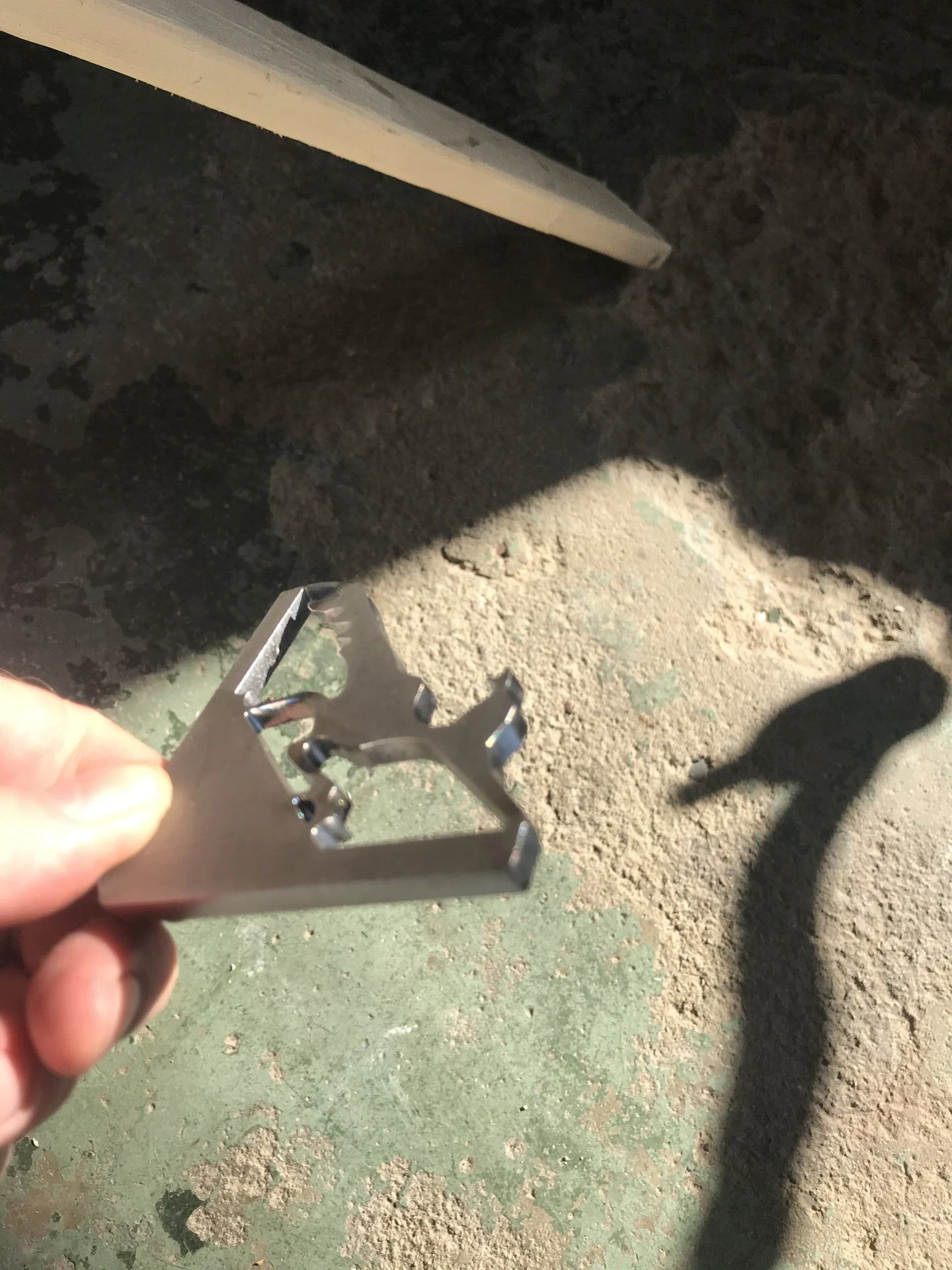

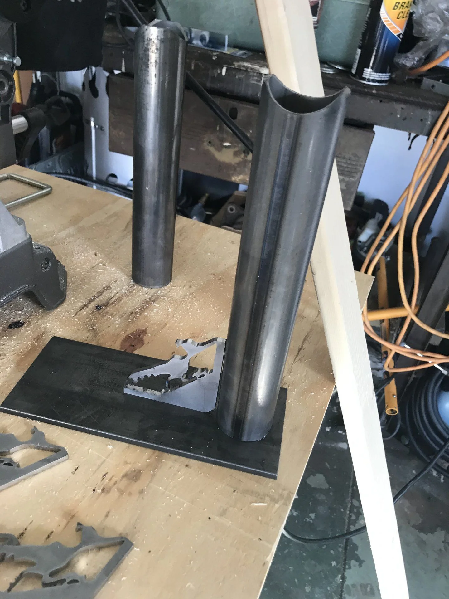

I have no process yet, will start building them today, couple great videos on you tube. Just going to size it up with theee jack stands and keep the same amount of clicks each side. I was thinking about gussets, I got some plate steel together, and started sorting things in the garage. Didn’t notice these bad boys wrapped up in with the legs. There’s something to be said for a business that goes to this level of detail, to take the ugly to prettiness....pretty sure Marlin Crawler knows a thing or three about the secret sauce. 😉

I have AHC. You can get 3 mounts on the passenger side, but only 2 on the driver side. I have thought about adding some extra gussets to help support the middle section. The back mounts have a brake line running very close to them so I cut some rubber hose and wrapped it around the lines so nothing wore though.
