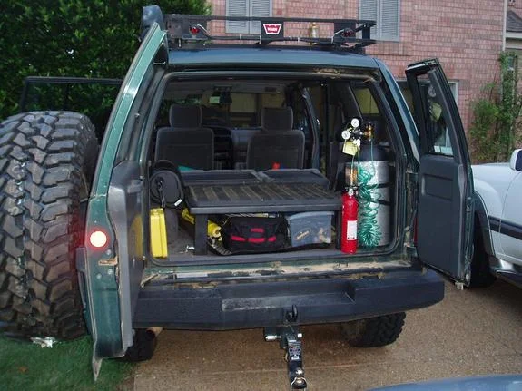

Looks very nice. I've been wondering what I should do on the LandCruiser. The wood looks quitre a bit better than what I did on my trooper. I did the troop's platform in steel. Its very sturdy and quiet, but would be a bit utilitarian in the LC. Might have to use some of spare hard wood flooring materioal and copy you design.

I had an 80-series that I threw something together for. Yours is much nicer and more of a finished product. I had my spare 35" tire, tool bag, tow strap, hi-lift and all sorts of other stuff under mine. The only problem was mine was a little higher than my rear seats folded down. That was where my feet went. It wasn't mounted to anything either. It was just equally supported and secured with the rear seats up. I had the power inverter back there as well. It was nice to have. I ended up selling that truck, but I had intended to build more of a box support system. Mine only took about an hour to get to where I ended at (not including drying time for carpet). It was also removed in about 5 minutes if necessary.
