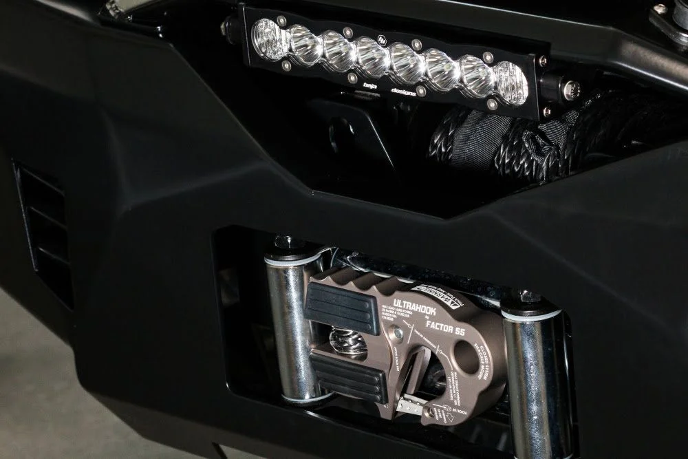

  • Slee Off-Road steel front bumper (ONE-OFF) with parking sensors
    • Winch: Comeup Seal Gen2 12.5rs winch with synthetic line and wireless remote with military terminal upgrade
    • Factor 55 — Prolink

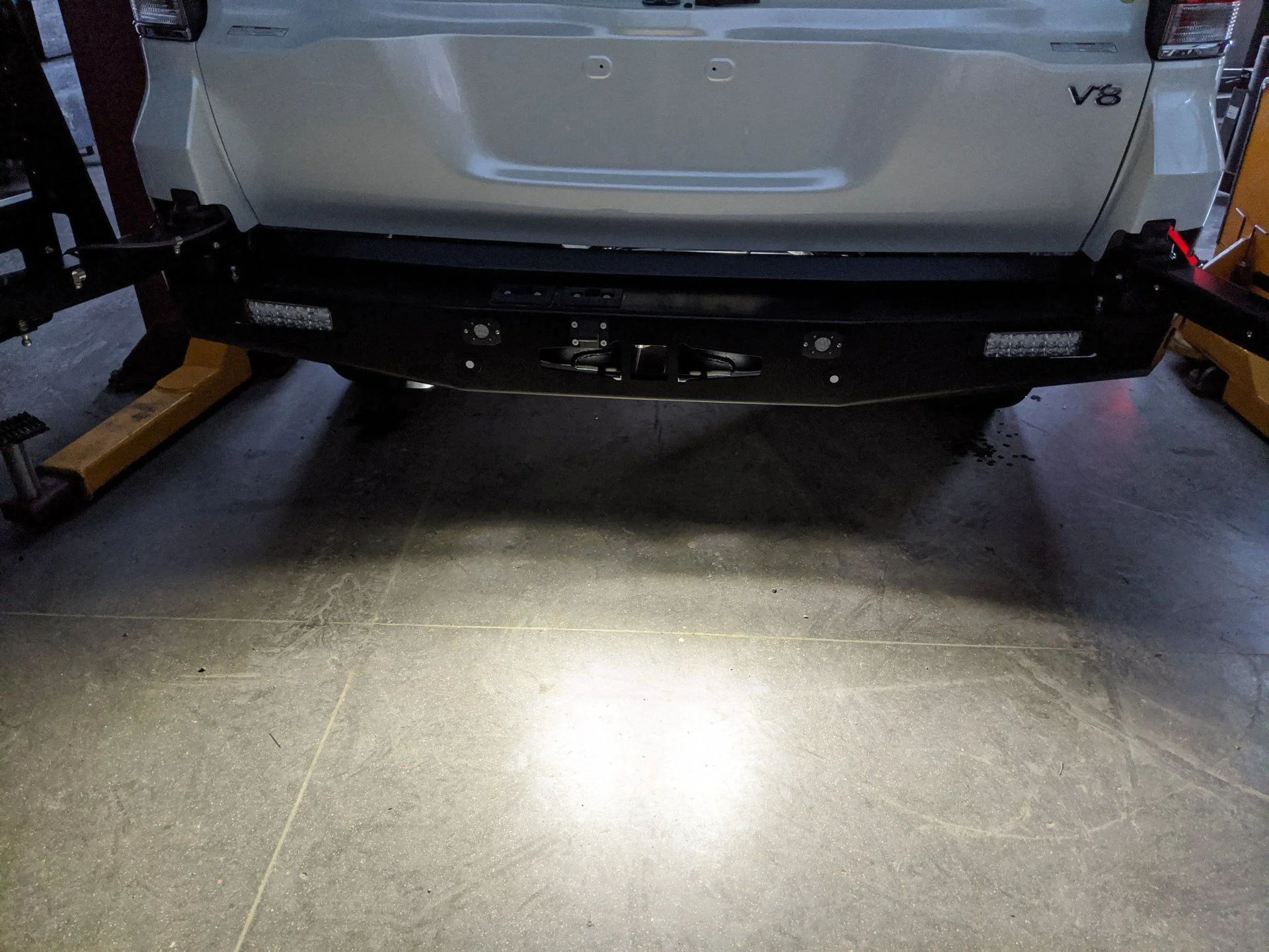

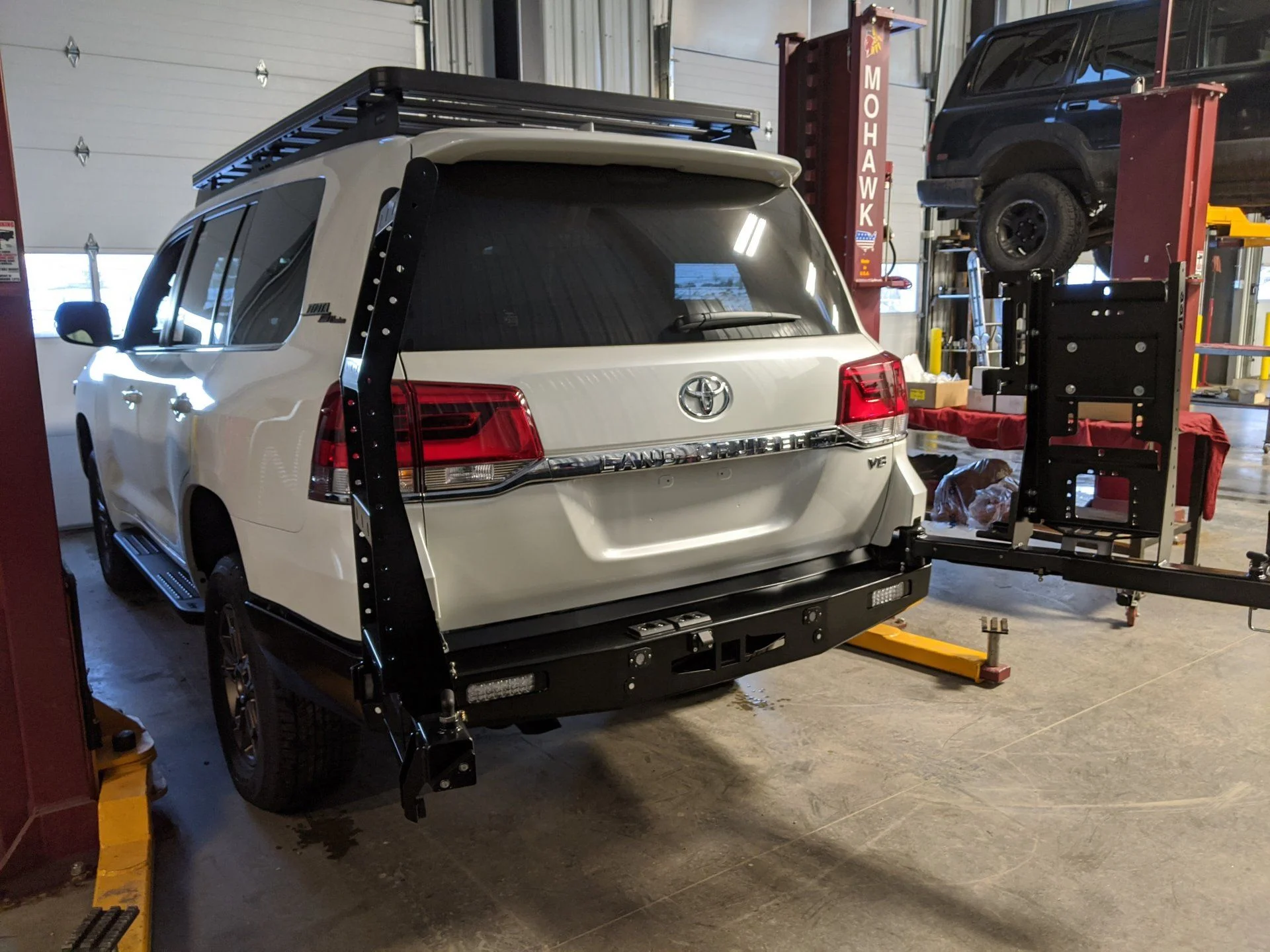

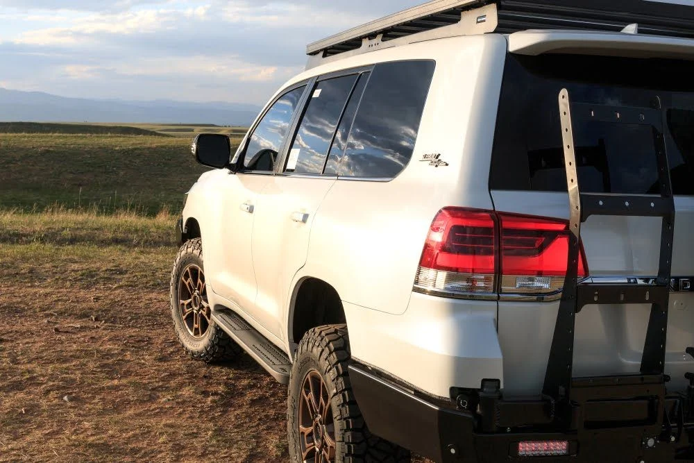

  • Slee Off-Road steel rear bumper(dual swing out) with tire carrier and ladder

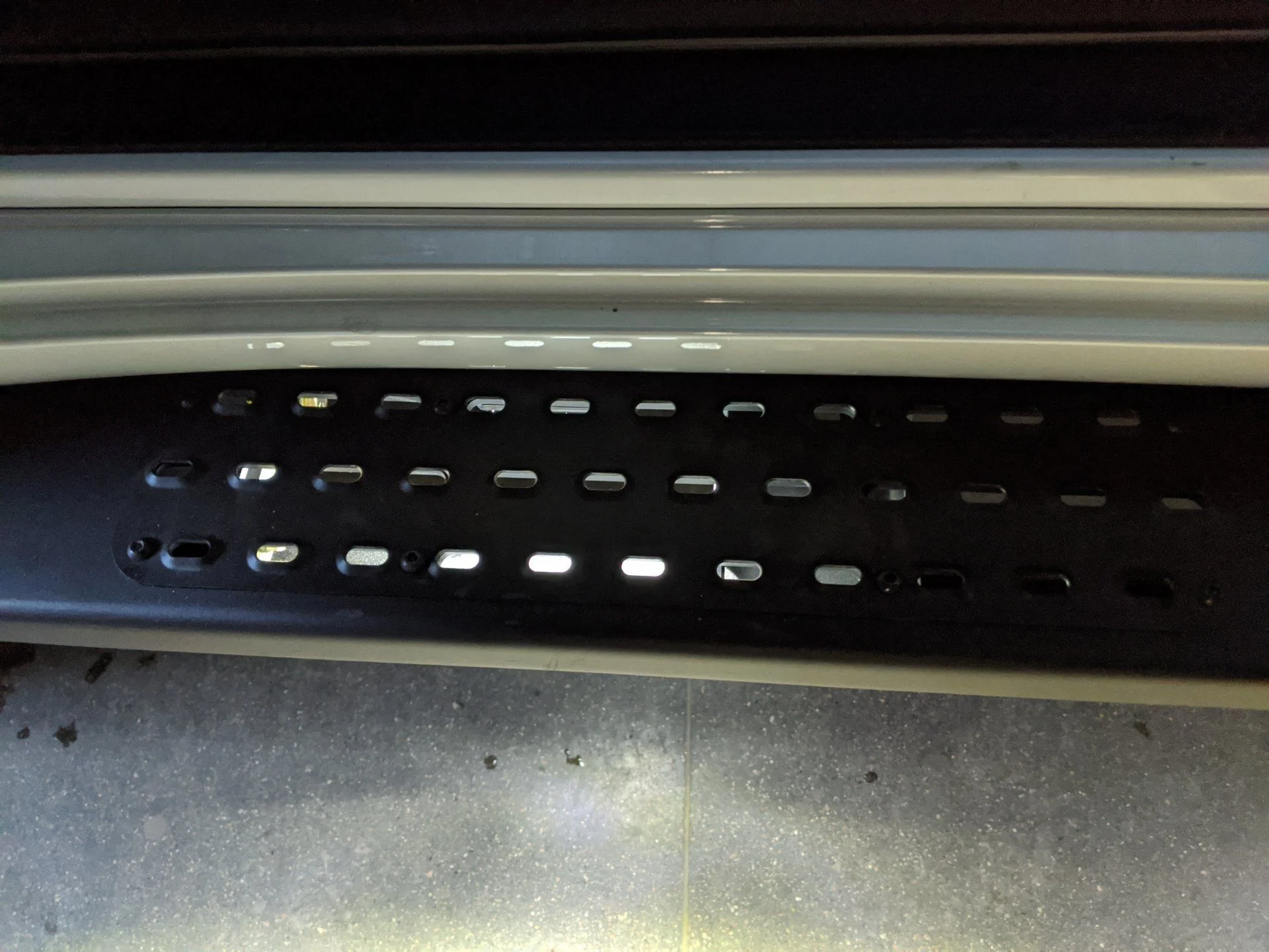

  • Slee Off-Road LX570 rock slider steps
    • LED light kit for slider steps (4 lights)

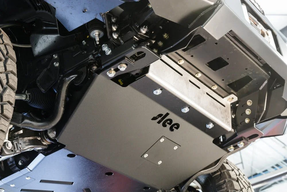

  • Slee Off-Road full steel under body skids

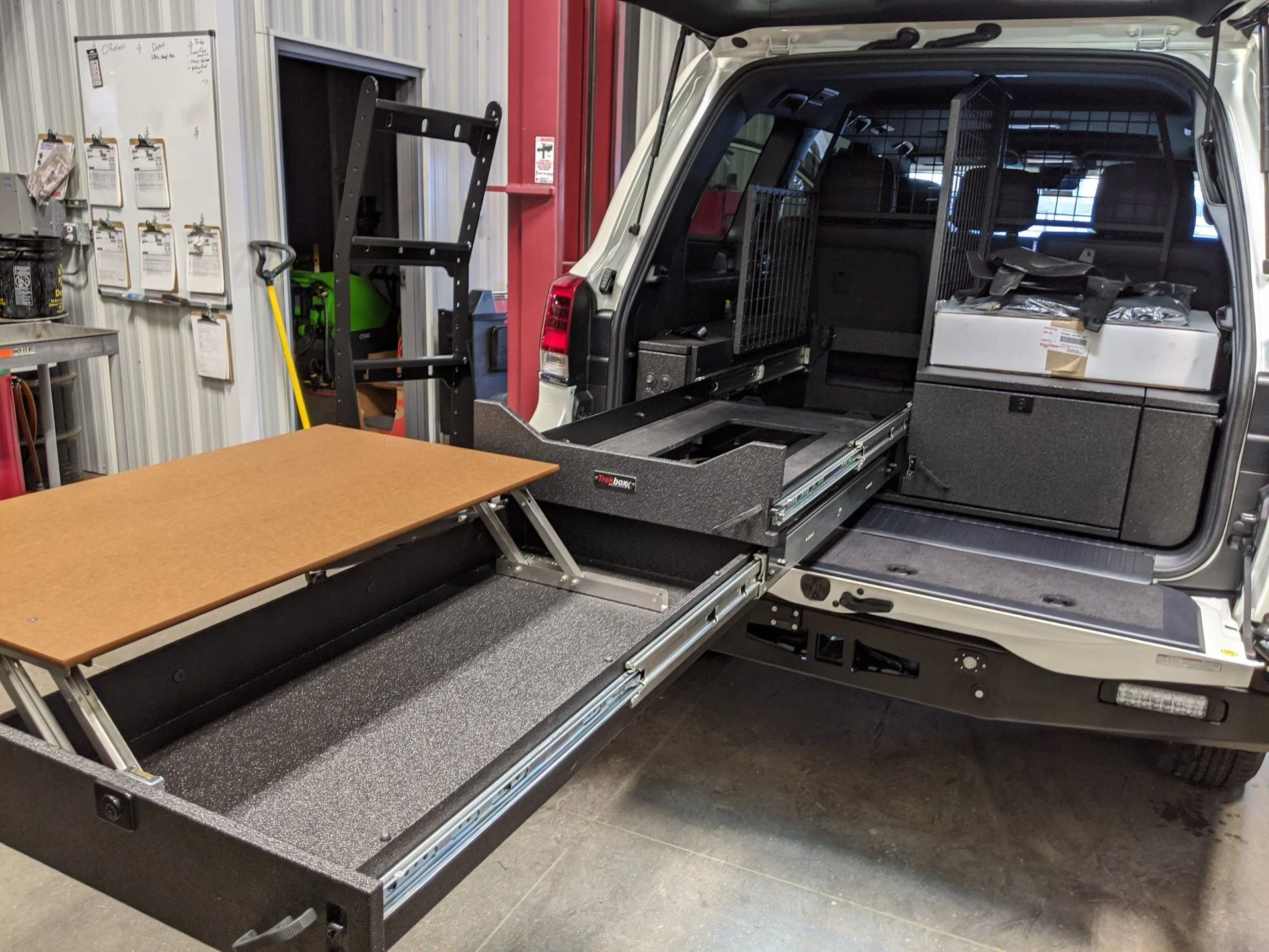

  • TrekboxX System Alpha Complete with Heritage Edition modifications
    • ARB 50qt Frig/Freezer with ARB Frig tie down kit

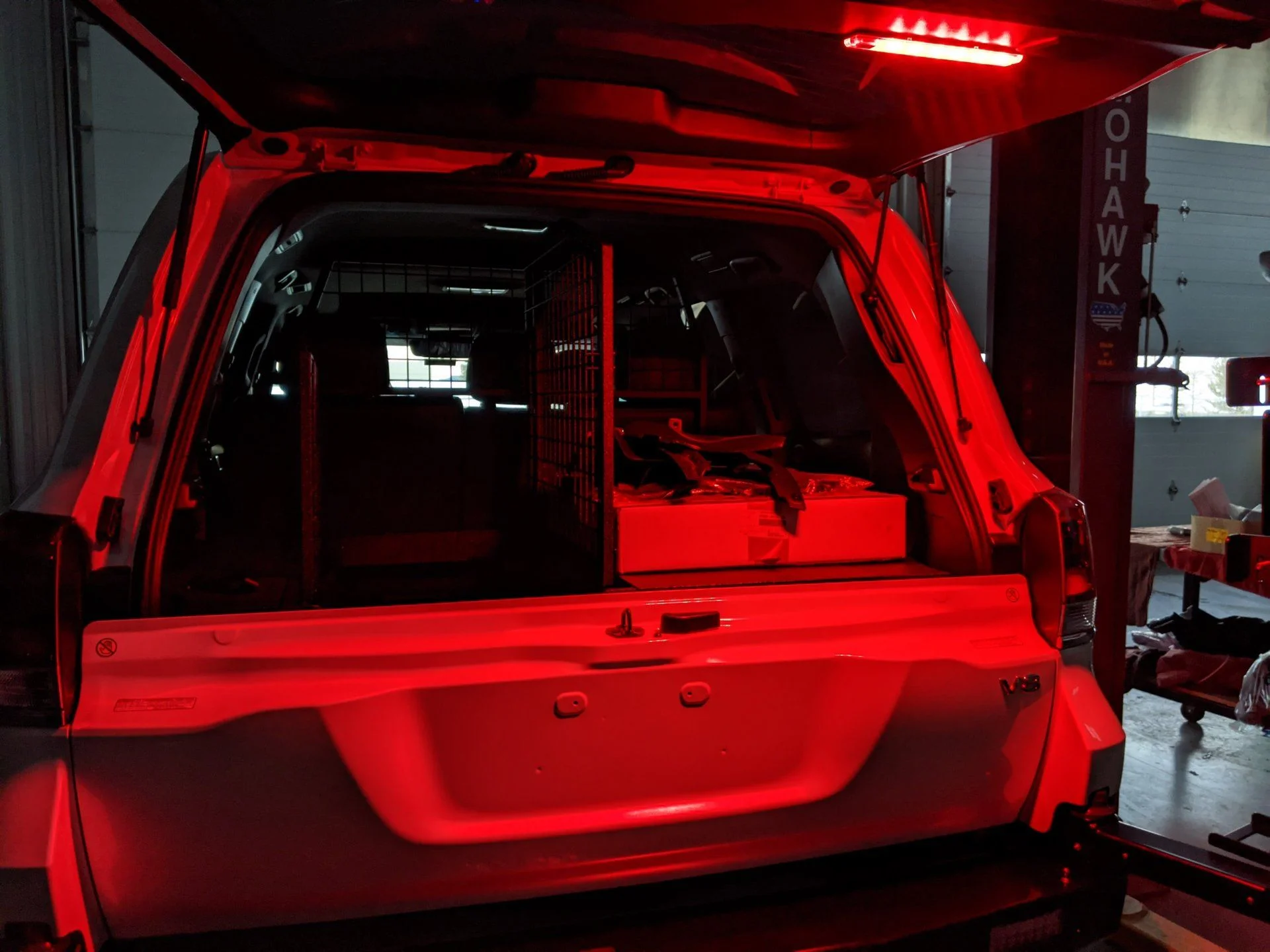

    • Red/White and Orange/White tailgate lights

Those cut outs around the bumper swing-arm hardware are simply beautiful. How did they get the bumper plastic to curve inwards like that? Fantastic work, looks better than OEM.

I’ll add my office cohort Tim to Matt’s list. While Brian is not on here, he deserves a lot of credit for the front and rear bumper trim (amongst other things), he’s a real tweak when it comes to that stuff and he nailed it.
Tim is not on here either, but he runs a press brake and welds like a kid in the rain. We really are just a big fun havin team lol, good times.
