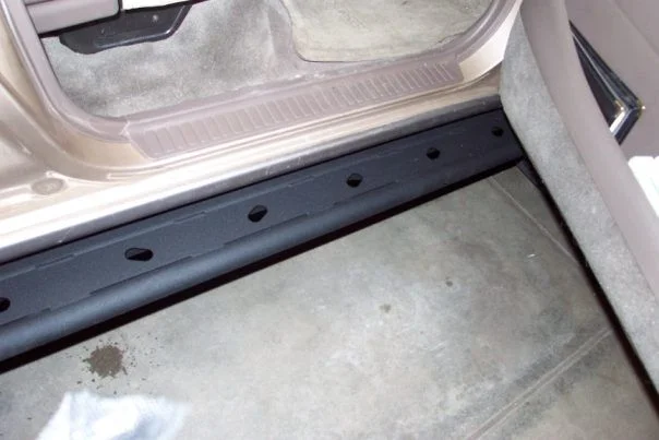

Marc,
Sliders (all suppliers) are sold as a pair. Here is a picture of the Slee Step Sliders (the new design)

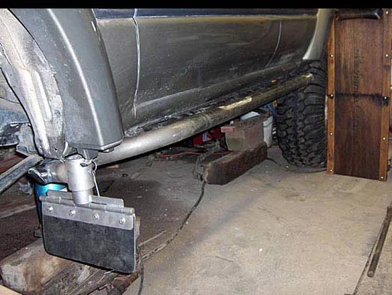

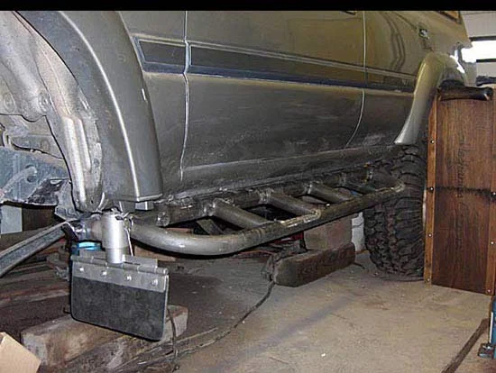

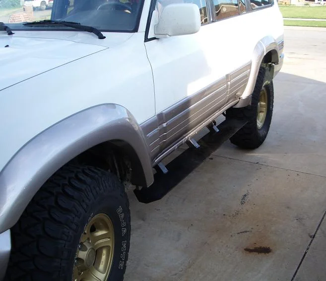

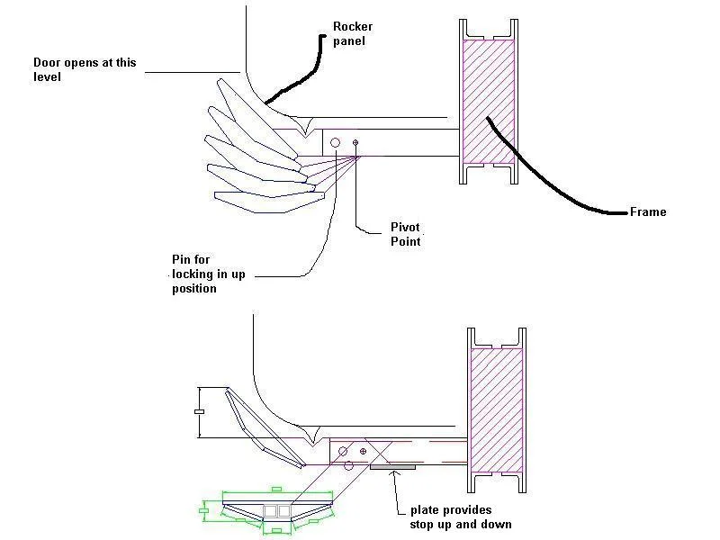

One or two guys in the 80-Section have already built some sliders that sound similar to what you are describing. I'll find the thread(s) and post some pics.
Guy's nym is Walking Eagle.
Plans
attachment.php
Up
attachment.php
Down
attachment.php
-Mike-
Very cool. Thanks for posting those up. My idea is similar to those but I don't have the entire outrigger folding up or down, just a section of it in front of the door. Also, my design does not require any sort of manual locking pin removal or installation. You put weight on it to fold it down and then the torsion springs make them return to the stowed position when the weight is removed. However, those full folding sliders provide for more surface area to step onto than my design does. Once I get the design and class finished, I'll probably pass the details on to Ali so he can build a set for himself.
