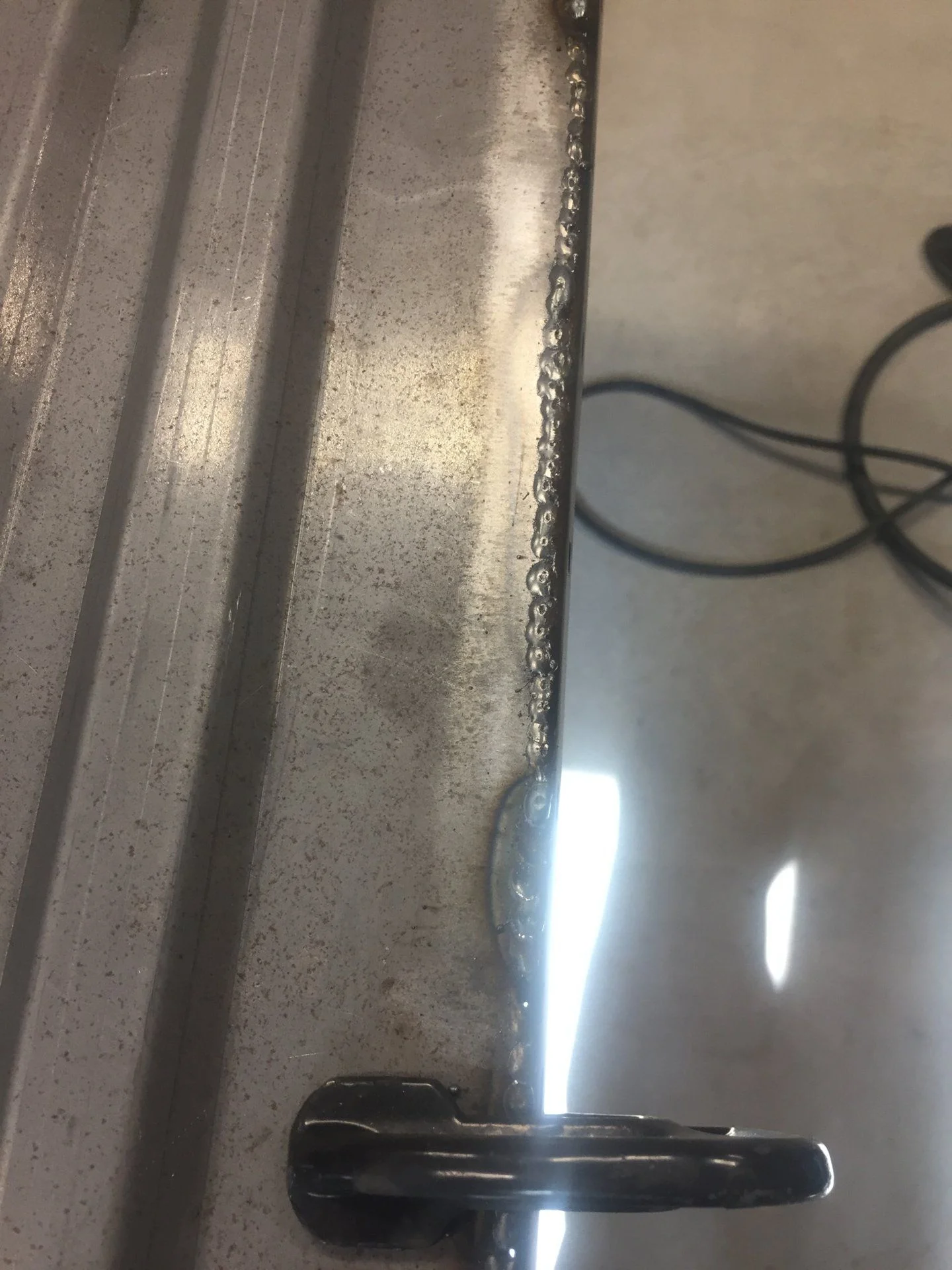

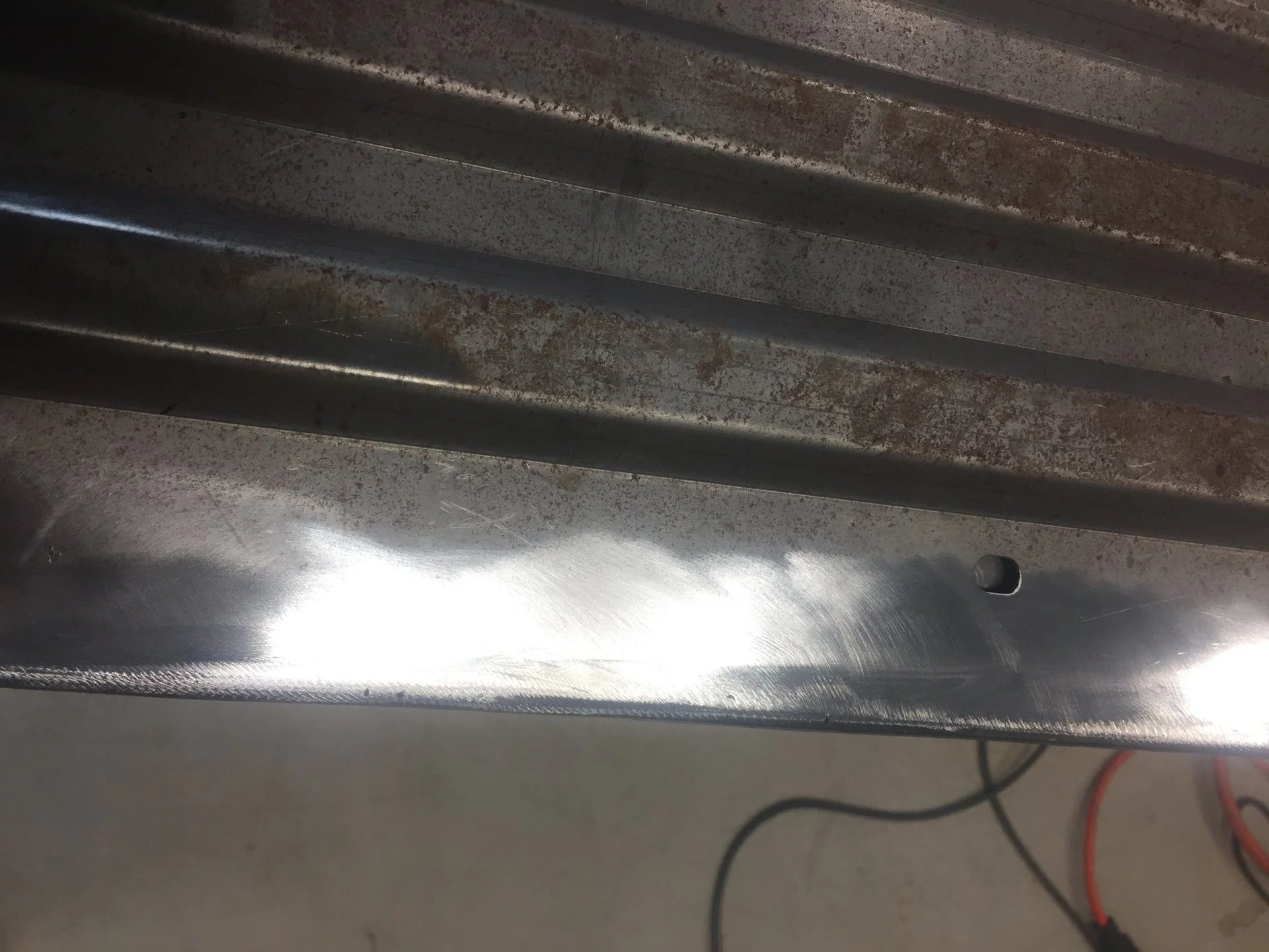

Working on many things at one time guess they call it multi tasking. Have the floor parts behind the wheel wells that were bent in the wrong direction so I cut the lip off and welded it back on going the right direction. Turned out good no warpage and smooth just time I guess.
Working on many things at one time guess they call it multi tasking. Have the floor parts behind the wheel wells that were bent in the wrong direction so I cut the lip off and welded it back on going the right direction. Turned out good no warpage and smooth just time I guess.View attachment 2214993View attachment 2214994View attachment 2214995

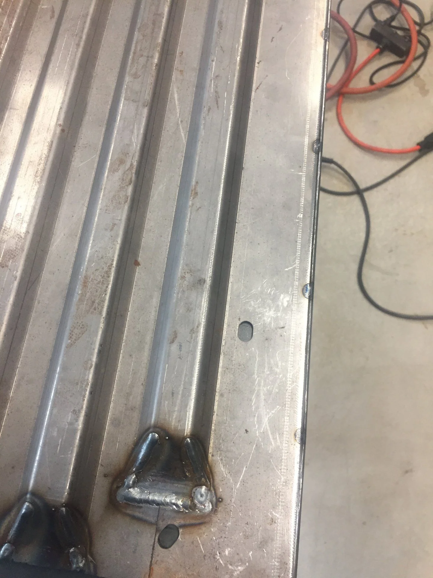

Spent a few hours cutting down prepping and welding both of the rear side bed plates. Know it doesn’t look like much but it was a incinerator for time. After welding grinding and using the flap disk to get it just right. Tomorrow I will weld the mounting plates that you see at one end pictured. All 4 corners will get one each.

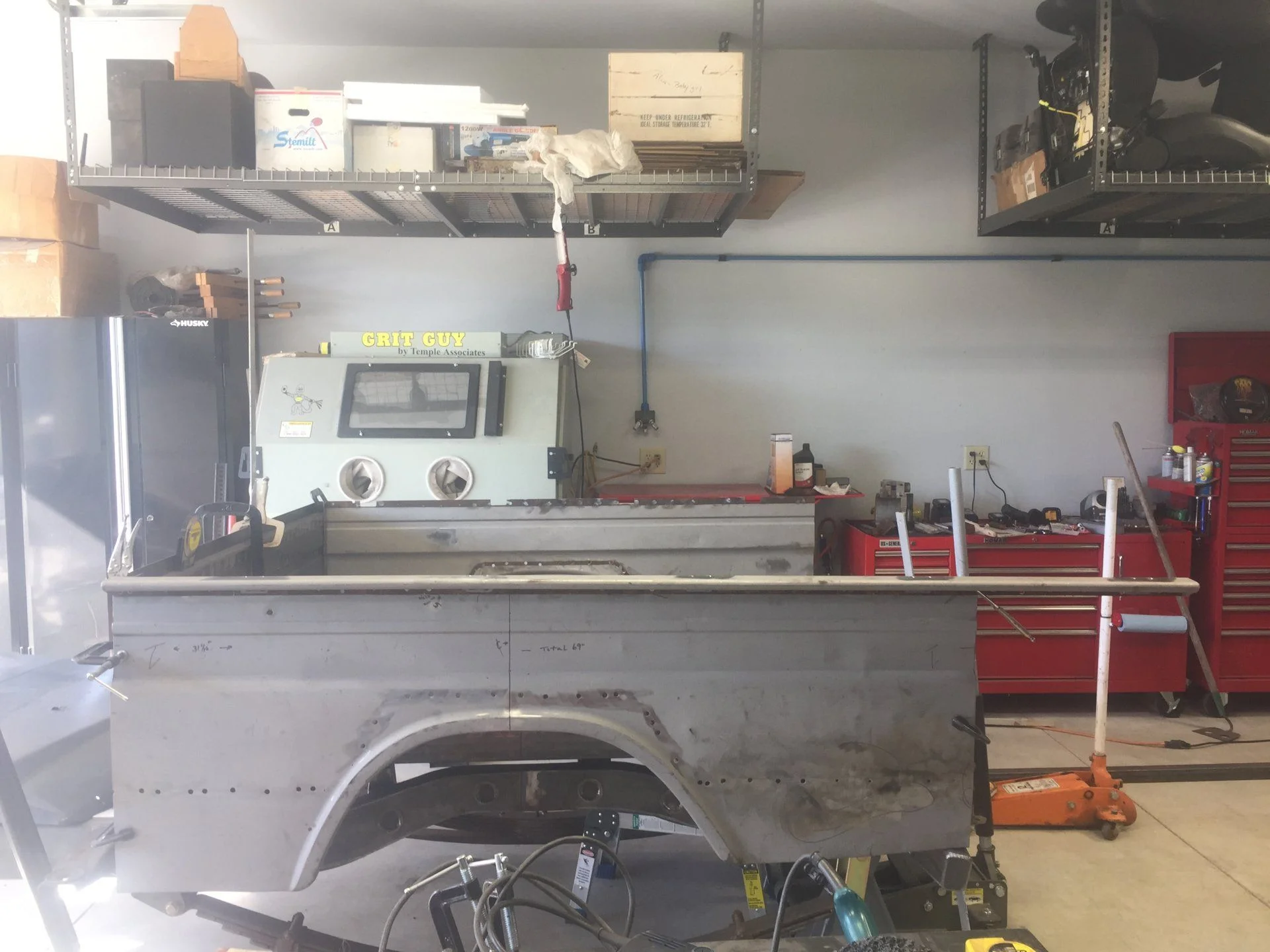

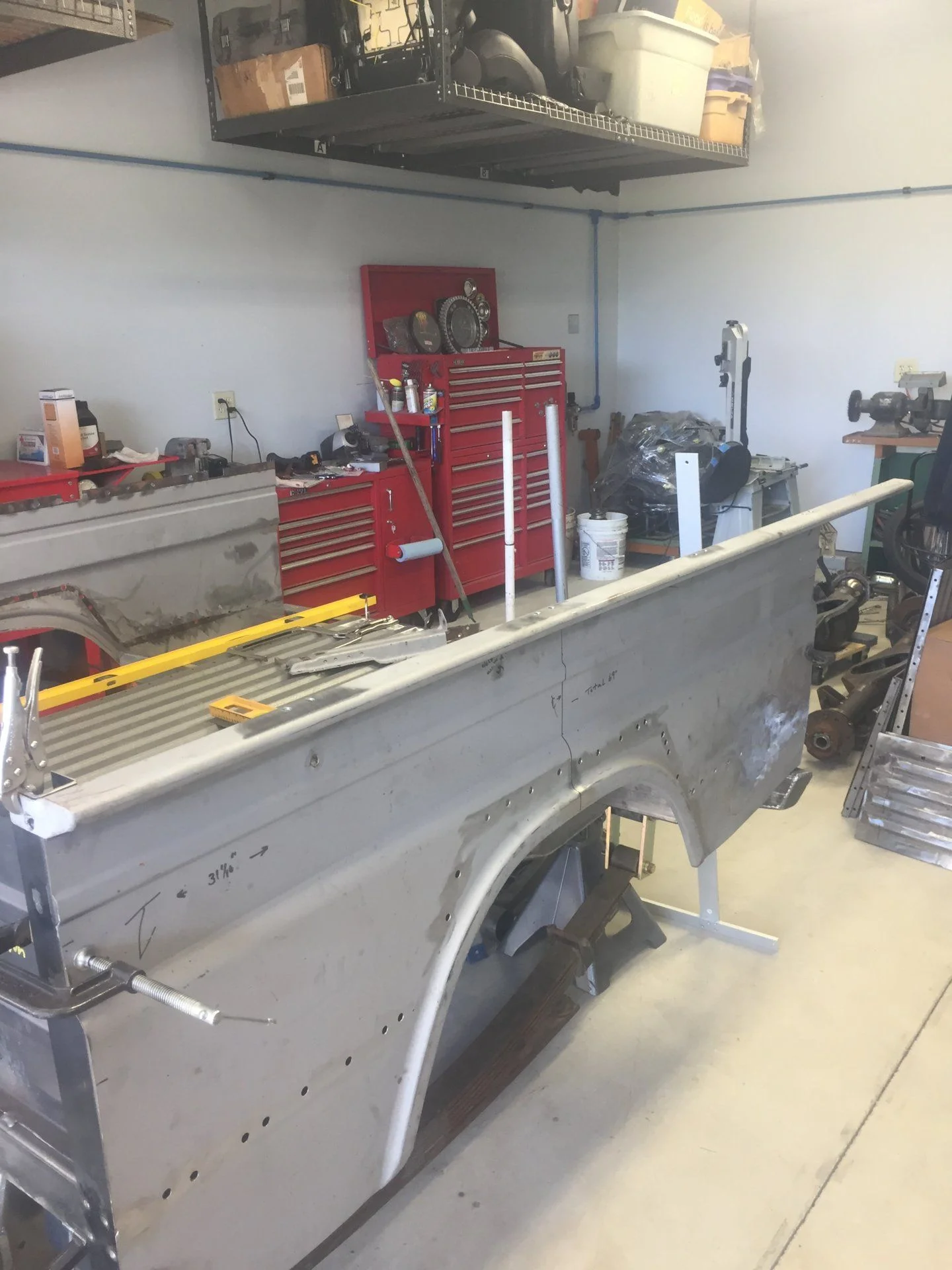

Stating to do more bed work, quarters as you can see. I cut to length to see how all the measurements came out and I am pleased. I wanted to do this before I did the final panel work as to not interfere with each other. Again I am a happy boy as to the outcome axel centerline is perfect to the wheel well, still plenty to do before they are done.
Did many things today but only one thing was noticeable. Started with putting more parts on the bed to see how much it needs to be adjusted. In the side view the overhang is 17” the tub takes up about 8” of that and the rest is in the shorter bed I guess. It is noticeable looking at the side view.
BYW wheel base is 120” or toy truck size.
