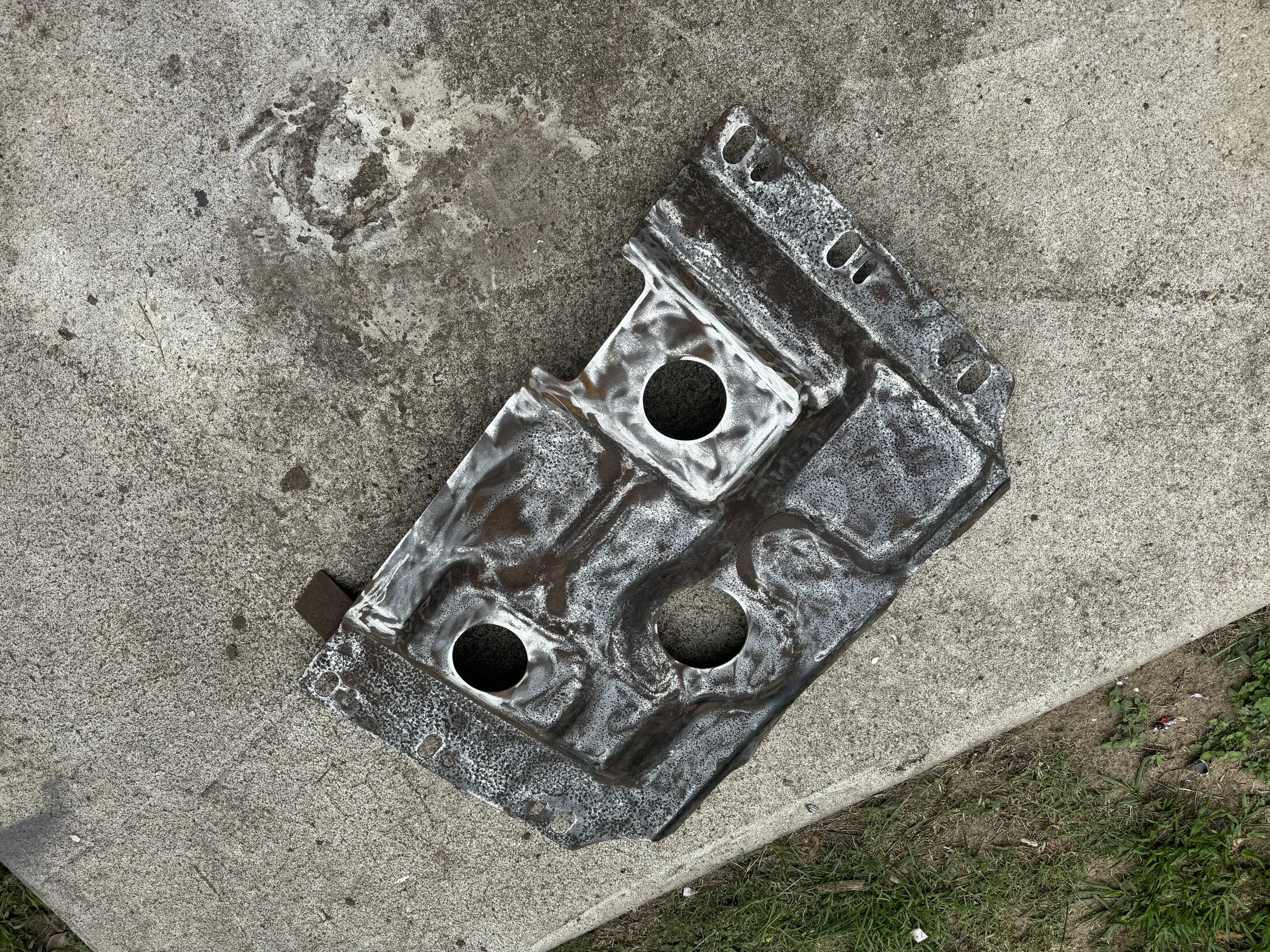

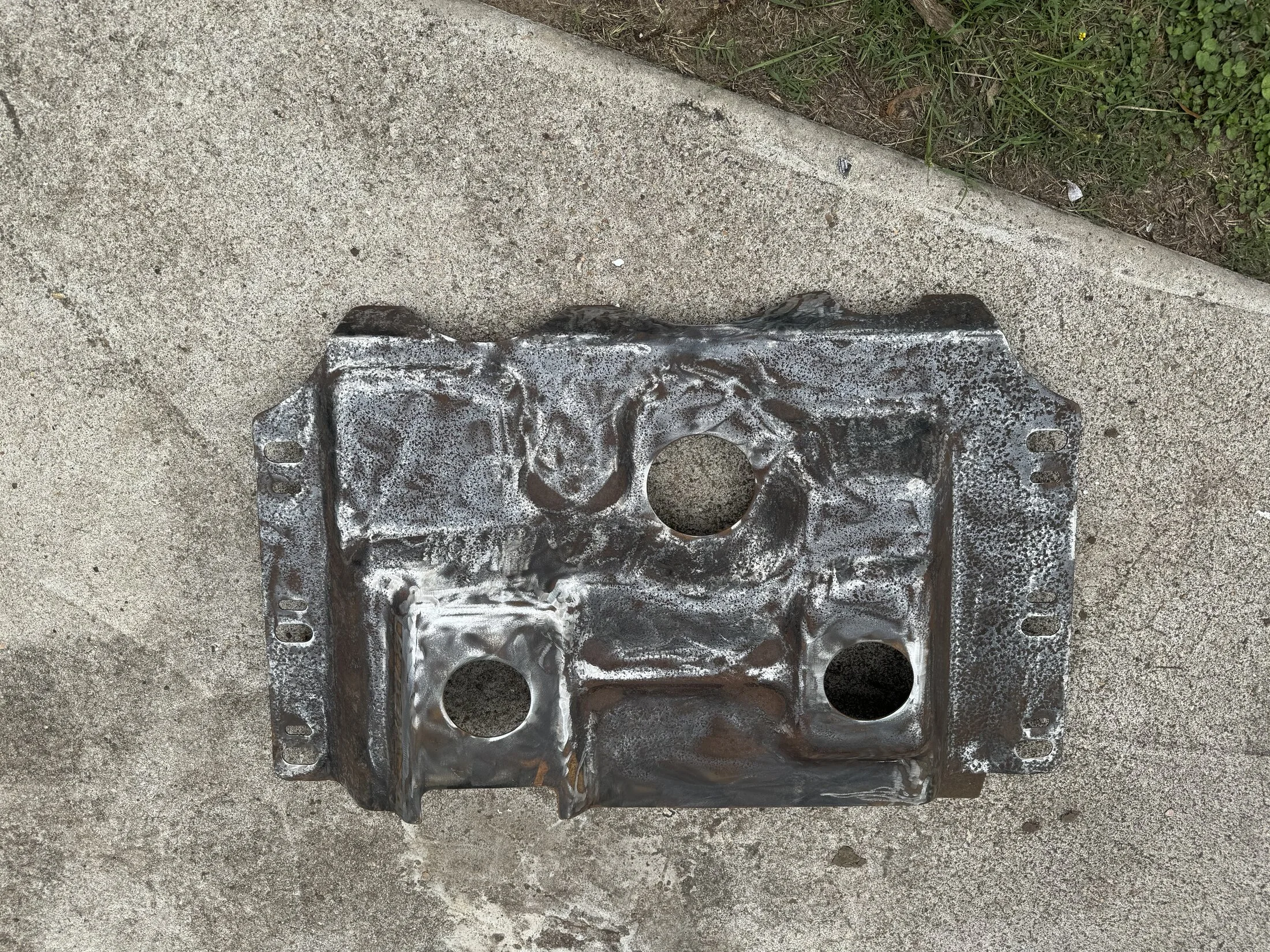

This is probably a crazy question, but did they make OEM skid plates for the FJ40? If not, is anyone out there running skid plates? If so, did you make them, or where did you get them?

Yes. I believe a lot of the time they were removed and never replaced when the exhaust was re-done.
some differences in 3 speed versus 4 speed skid plates
I have some nos 4speed skid plates if anyone looking
If you want a skid plate that does something look to @Downey
I have never had a factory skid plate fail me. I've had to use a scissor jack to bend them back. I'm not a rock crawler but hit.plenty of rocks over the years. Biggest issue I have it there is not enough room to route the exhaust above the PTO installed. But because of that it also doesn't lose ground clearance as much as one designed to fit many applications.
The 9/72-7/80 frames are designed to bolt both the three speed and four speed skid plate. Each side has four fixed nuts. Front three work with the three speed skid plate. Back three work with the four speed skid plate. 8/80 the four speed switched to a crossmember under the transmission. The three speed continued until.10/82. Those never used the crossmember. Never verified of the front fixed nut disappeared 8/80. I do know the five speed that started 10/82 the five speed skid plate used the same fixed nuts as the four speed.

Thank you for the information. Since I'm new to the FJ40 scene I appreciate all the info I can get.

Yes Toyota had skid plates on the FJ25 made prior to the FJ40. All FJ40s had a skid plate from the factory.
