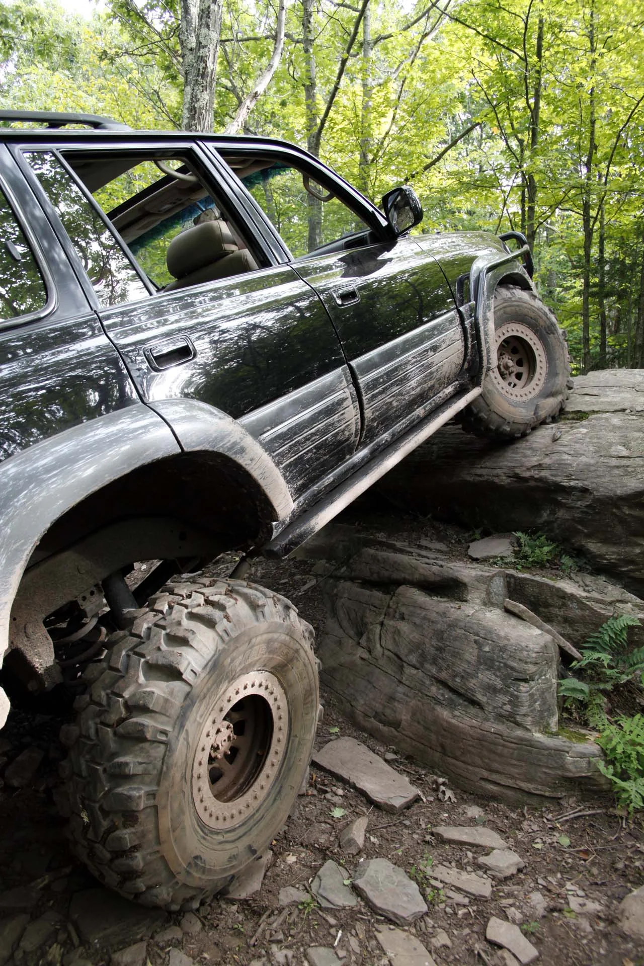

Thanks! Can you tell me about the lift kit here?
It is an old IronMan 4" springs and shocks. Nothin' fancy and a little old school. Good road manners and does very well in the rocks.
Hands down my favorite riding lift. I had it on my last 80 with the foam cell shocks and just loved the ride quality. I haven't been in another 80 yet that I thought rode better (including those with slinky's, Dobinsons, Radflo's, Icons, Fox, OME, etc). The ride quality on and offroad is just great.

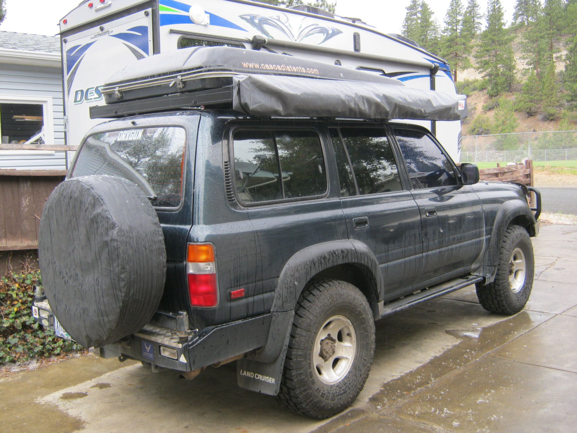

Iron Man Suspension first impression
That's from 2010 when I installed springs and shocks on my White 91. I took that setup off the White 91 and put it on the Black LX450. I bought new IronMan shocks sometime in early 2017 to replace the beat up ones. Same springs though.

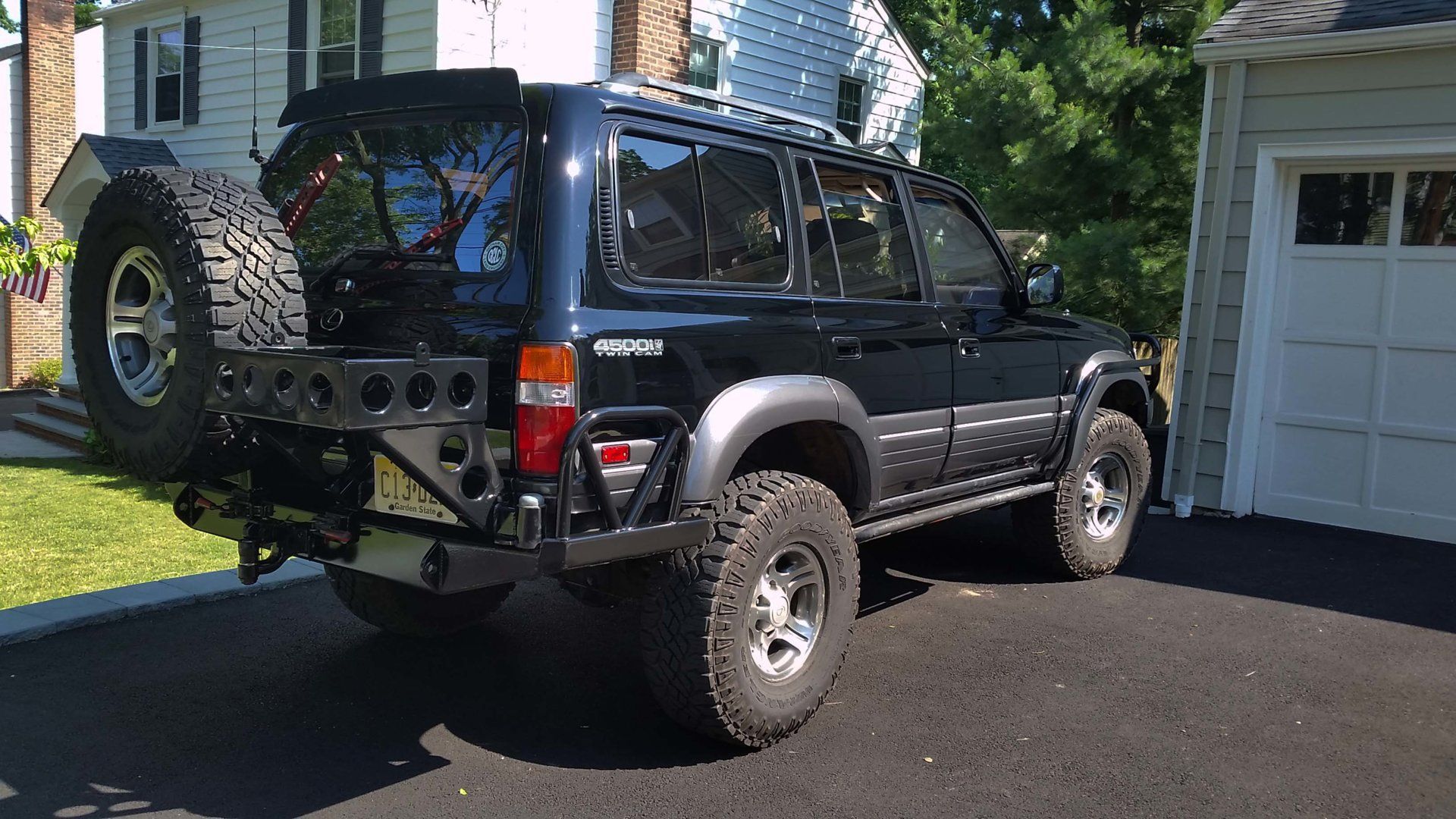

I run a 2.5" OME lift with 35's if you think 4" is too much. The higher you lift it, the more you'll need to adjust the camber. Edit: (Castor not Camber - Thank you, Jon!) My front tires barely touch front mud flaps when you turn the wheels IF you keep 'em on. You'll find that if you keep your rig light and stay away from the heavier armored bumpers & such, stock gearing should be fine. 35's are right on the edge of needing some gearing assistance if you add any weight. It's a personal choice, though. You can change either diffs or transfer case if you decide you need more power. 4.88's are the popular diff ratio choice for 35's, I went with 5.29's myself.
Pic of mine:
As you can tell, mine sets lower than @jonheld 's, but for my use - it works fine. And my rears will just barely rub inner wheel well at full stuff, but it's rare for that to happen with my use.
I run a 2.5" OME lift with 35's if you think 4" is too much. The higher you lift it, the more you'll need to adjust the camber. My front tires barely touch front mud flaps when you turn the wheels IF you keep 'em on. You'll find that if you keep your rig light and stay away from the heavier armored bumpers & such, stock gearing should be fine. 35's are right on the edge of needing some gearing assistance if you add any weight. It's a personal choice, though. You can change either diffs or transfer case if you decide you need more power. 4.88's are the popular diff ratio choice for 35's, I went with 5.29's myself.
