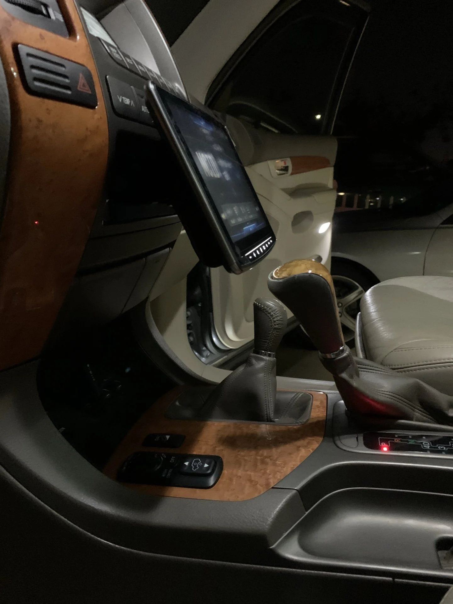

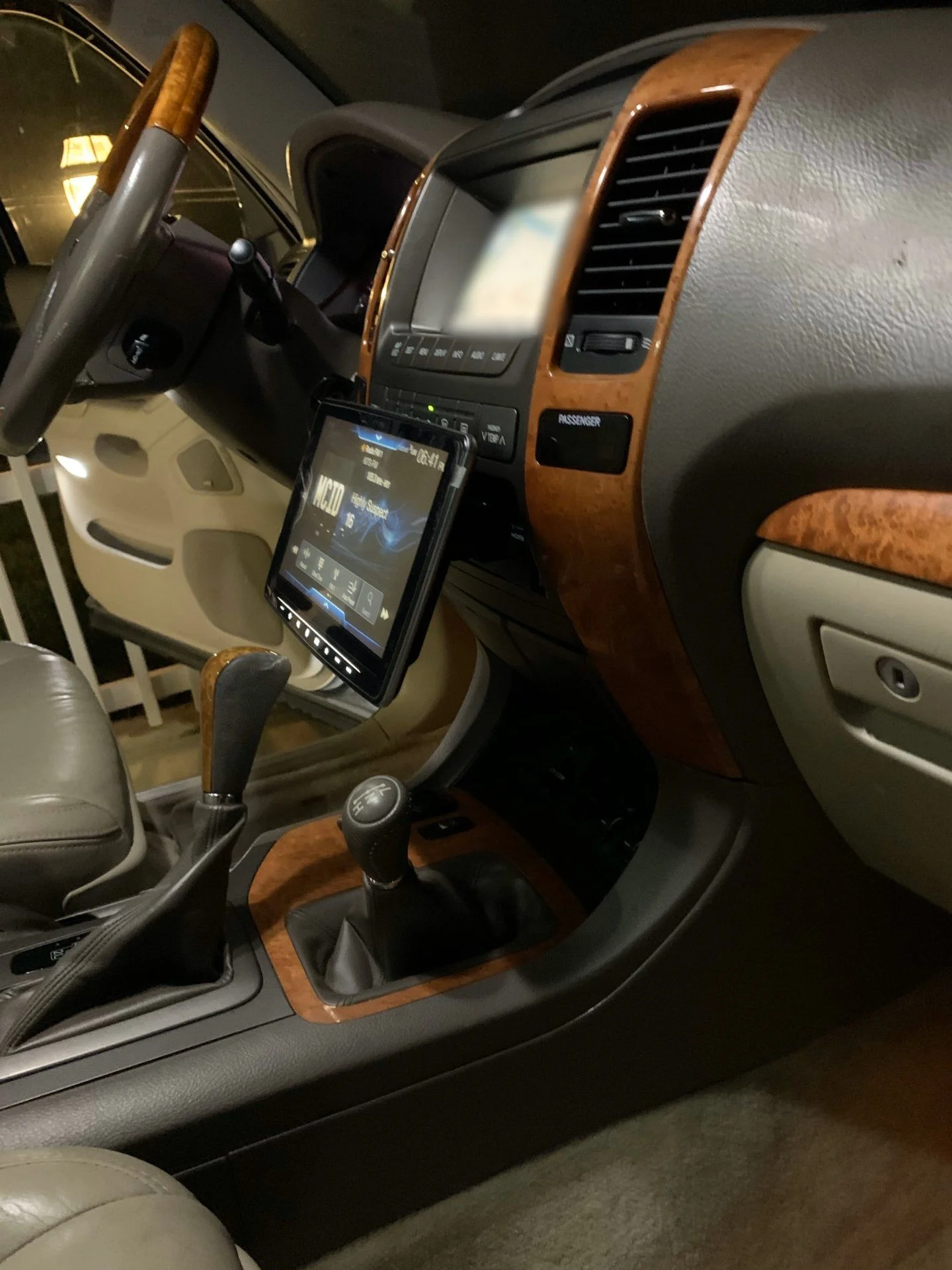

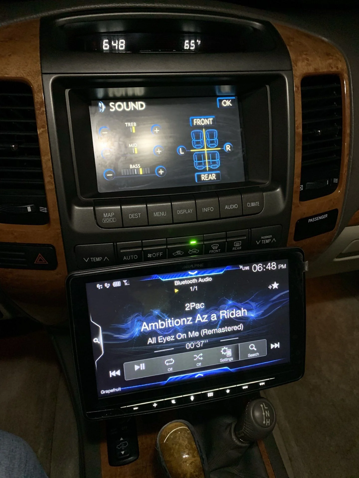

All, took the plunge and purchased the Alpine ILX-F309. Installed using the Beat Sonic adapter (very expensive at $240.), process was really straight forward and turns out very nice sound. I added SiriusXM, waiting on brake bypass and steering adapter harness. while it is close, I don’t find the stereo too bothersome with factory controls (shifting to park/drive, low/high), climate controls are all visible and everything on the factory ML display works. I can still adjust the fader and balance as well as the DSP. If you’re looking for serious expansion this unit has it! Also consider the Alpine ILX-F259 (less features, cheaper, same concept). Also, note that the cover (behind the display screen) must be screwed in or the unit will not turn on!

Any depth issues mounting it in the GX?
Apple CarPlay works great. Apps that are supported by Android Auto and Apple CarPlay will work. Plays music and can make and receive phone calls via Bluetooth. Google maps can be downloaded for offline use, I will try it out and see if it works. DEPTH! Yes it is a bit of a tight fit with the beat sonic adapter, if you trim down the cables it will make it easier. Not impossible but does require some maneuvering. The 309 enables serious expansion incorporating some of the latest in mobile automation. You can add front and side camera, speed sensor, not sure if maestro will tie in with the 470 I suspect a bit too old. With Maestro you can monitor tire pressure, view And reset trouble codes on vehicle, more. If you don’t care about the Maestro stuff you can get the f259 cheaper and does most of the same stuff.

I can’t speak to the V line setup. Regarding the Alpine f309, personally I hate the Apple Maps, I had bad experiences with its accuracy. Google maps works great and with car play this f309 has a nice clean display (not cluttered). I don’t know the level of detail you prefer for nav, the google app works an will get you there. The google app also switches between day/night mode so this may affect some but is easily changed on device. You can probably find a dealer or YouTube vid that can show you greater detail. It would be nice to find an app that displays terrain, elevation, etc for when you go wheelin‘! There’s a list of apps that work including tidal (music), WhatsApp, Waze, more. I’ve only begun this journey so have to explore more apps. If you like Google maps or Waze apps/display you would likely be at home with this setup.
