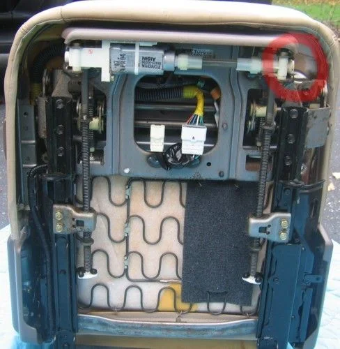

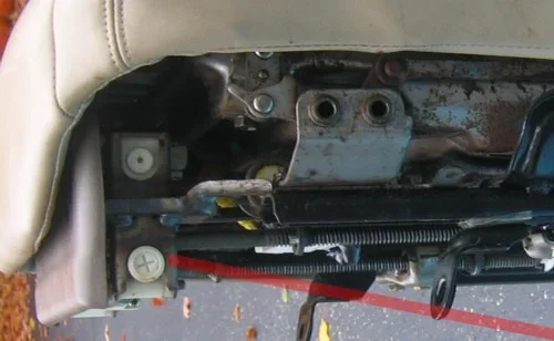

Howdy,
I had the dreaded "Oh Oh" when my front passenger seat got stuck this past weekend on my "97 LX450 in full forward. The motor whined but seat wouldn't budge. The following pics are what I found. Whew, thanks to this board, it was an easy fix. For awhile, $$$ signs were dancing in my head. My MUD search gave me the answer. Thought some pics would be appreciated. I pre-emptively tightened the little screw on the driver's side (it was loose). Half a
. Thanks MUD!
Pic 1: Only 2 year old could fit (joking)
Pic 2: One power clip to remove under seat
Pic 3: View from bottom of seat
More to come!
