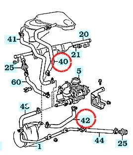

Referring to the parts diagram at the start of this thread, did you replace hose #40 with the 1" Samco and hose #43 with the 7/8" Samco ?
Yes #40 is the 1" Dia Hose which is the pump intake, the #43 is the output 7/8" Dia Hose.
Thanks. Do you have the info on the clamps you used ? I know for these silicone hoses the clamps have to be without serration and apply a constant torque.
