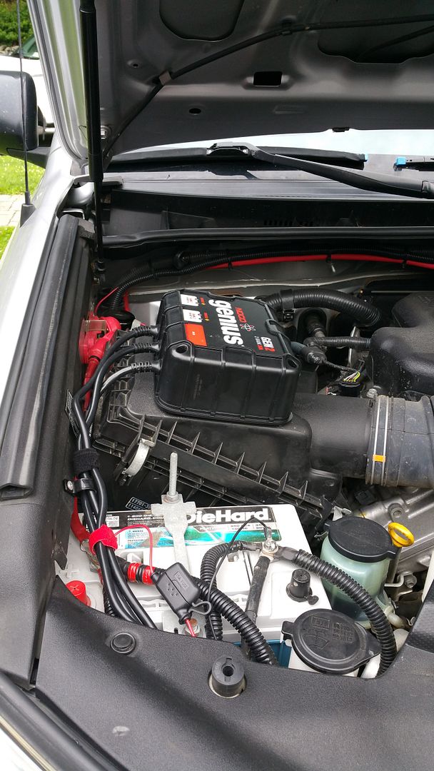

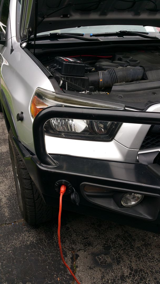

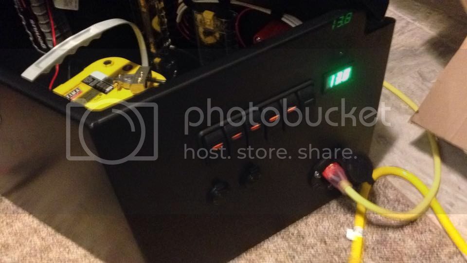

Update...
Installed with pics.
I drilled the 2 Shoreline plugs in the front. One is for the charger, the other for my block heater (that the cord always dangled out). It was pretty straight forward, except for having to move my fuse and holder off the top of the air filter box, which will now be the new home of the 20 amp Genius chager.
The shore power ports are exceptional quality...I'm going to be oder ing anther for the trailer and get rid of the Marineco that never stays closed
